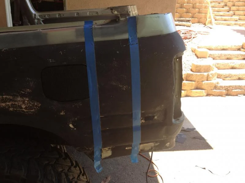

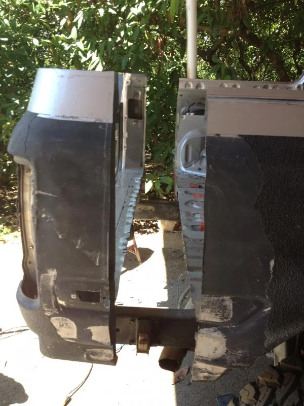

The rear hatch 'bulged' too far back into the bed, so I decided to cut it down.
It was difficult to decide what was vertical. The rig has a ass high stance, so I couldn't us a level. There was nothing to pull a 90 from. I ended up just eyeballing it for the first piece of tape. Then I measured back 8" in several places to line up the second piece of tape.
Maybe I should have studied better in kindergarden... stay between the lines.
