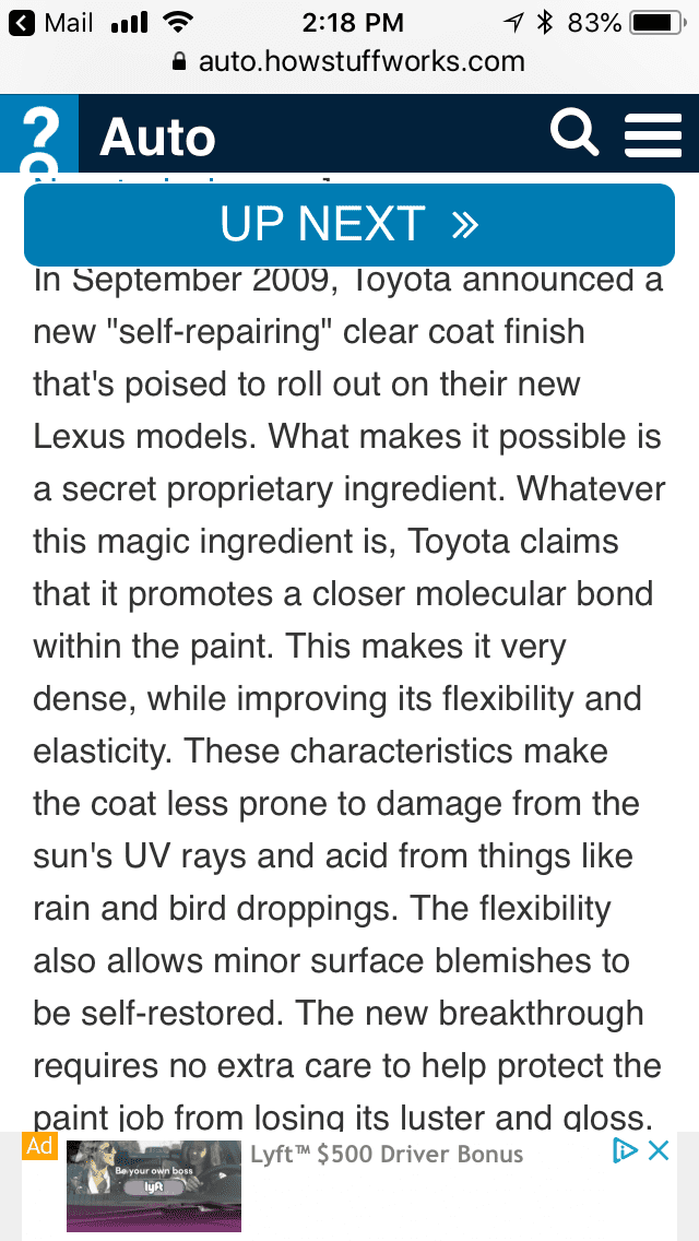

Well I found the answer for anybody that wants to know our 200 series have laminated front window and laminated front side window glass laminated windows in our vehicles provide 99% UV protection so you don’t need to tint your front windows. Unless you want to. It’s good to know that our interiors are so well protected from the sun. Also starting in 2010 Lexus uses a new paint clear coat that improves UV paint protection plus improved protection from scratches.
