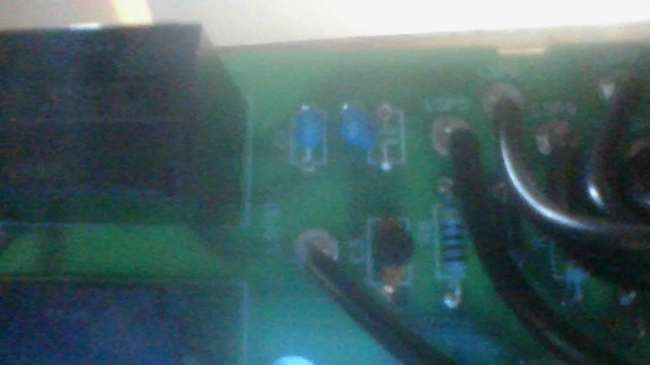

(l checked the chip EDIC & its blown diode C3...crap pic but it shows the blown 'yellow' diode)

Sounds like your EDIC needs a closer look
l swapped over the new chip version for the original a couple of weeks ago, it was ok for abt 50mls then started smoking, then it stopped..its been working fine ever since (l assumed with it being brand new it was settling in..temp wise)...l was going to send my old temp/preheater unit for a check up, but l'm waiting for a fresh pull cable to arrive to rig up the fuel pump..once its here l'll send off the old edic/preheater unit for diagnosis... there's defo something going on with it, as the motherboards been cracked & repaired.. Its a pain it started playing up now when l'm busy & have the weather to get things done..but can't...l'm hiring a van from saturday whilst its in the shop....
