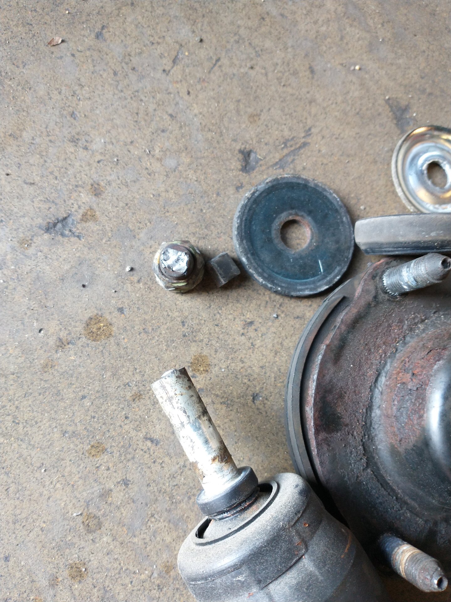

The marriage between the rod and nut was a strong one. This morning was exciting. 🥳
