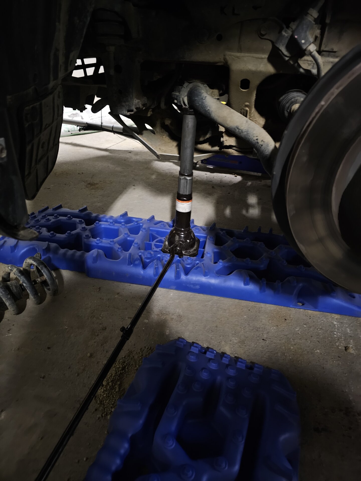

If you take the driver's side coilover out first you can use a jack to push the KDSS ram up and use the sway bar to push the passenger's side LCA down to get the strut out.

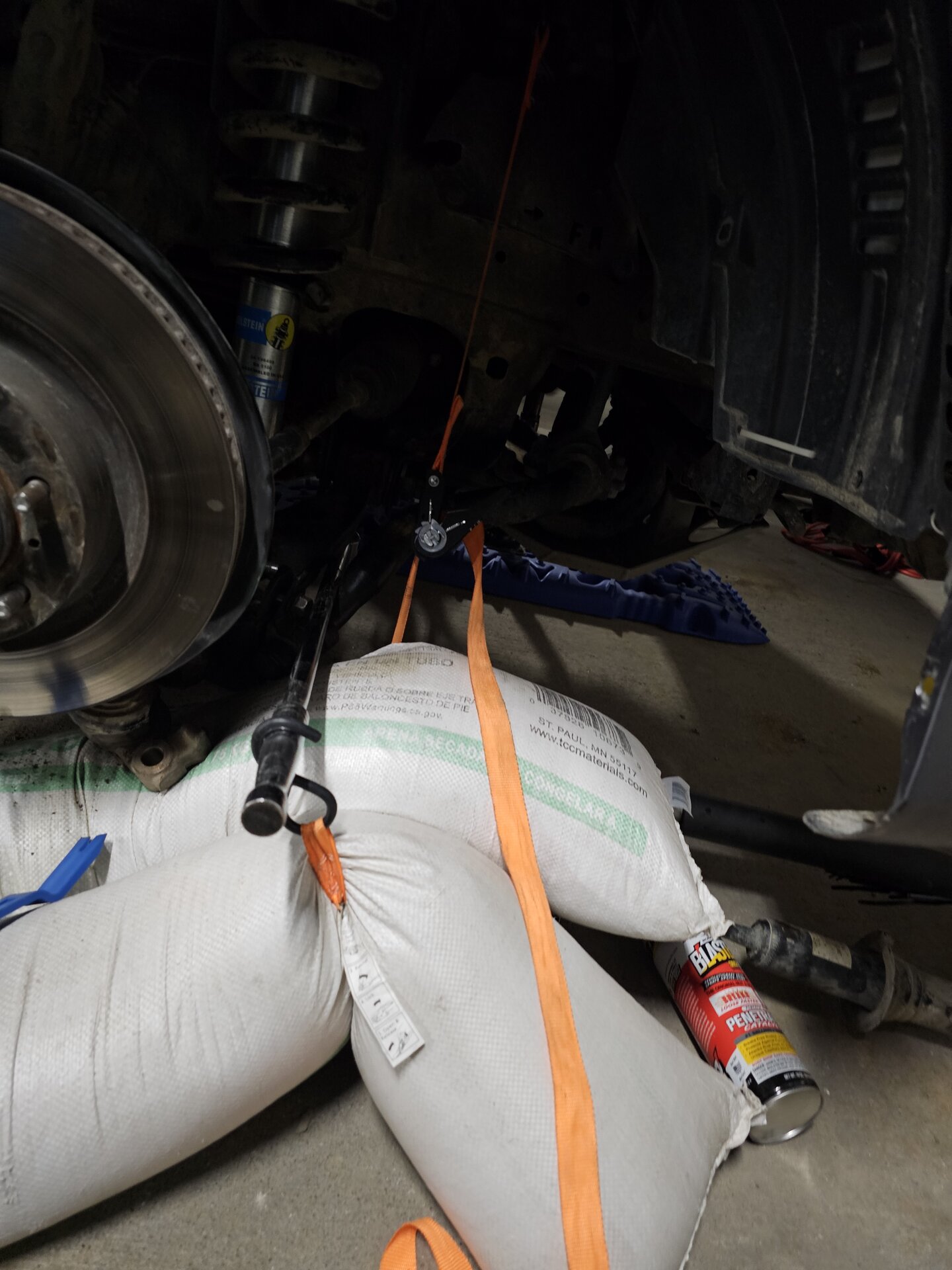

I had to get creative to get everything back together, and I just was able to get the bottom bolt through after rigging up all of this to act as a second person using a prybar

On the driver's side the breaker bar slipped and launched me into the wheel well. Thankfully just bruised my noggin and my pride. Used the handle of my channel locks to line up the hole on one side and pushed the bolt through from the other. I also jacked up the passenger side LCA to leverage the kdss on the driver's side down. Now just have to tighten bolts and the front is done.
I didn't mark the alignment bolts on the side I broke loose so I am going to try to guess where it was and hopefully it's OK. The passenger side is locked in place due to rust.

Now, THAT's sandbagging it!! :rofl:
Yeah, that way I was able to load up that pry bar with quite a bit of weight, including the sandbags, the tire and my 240# ass.

Correct, you actually use the kdss as a lever, remove drivers side first and put it back last.
