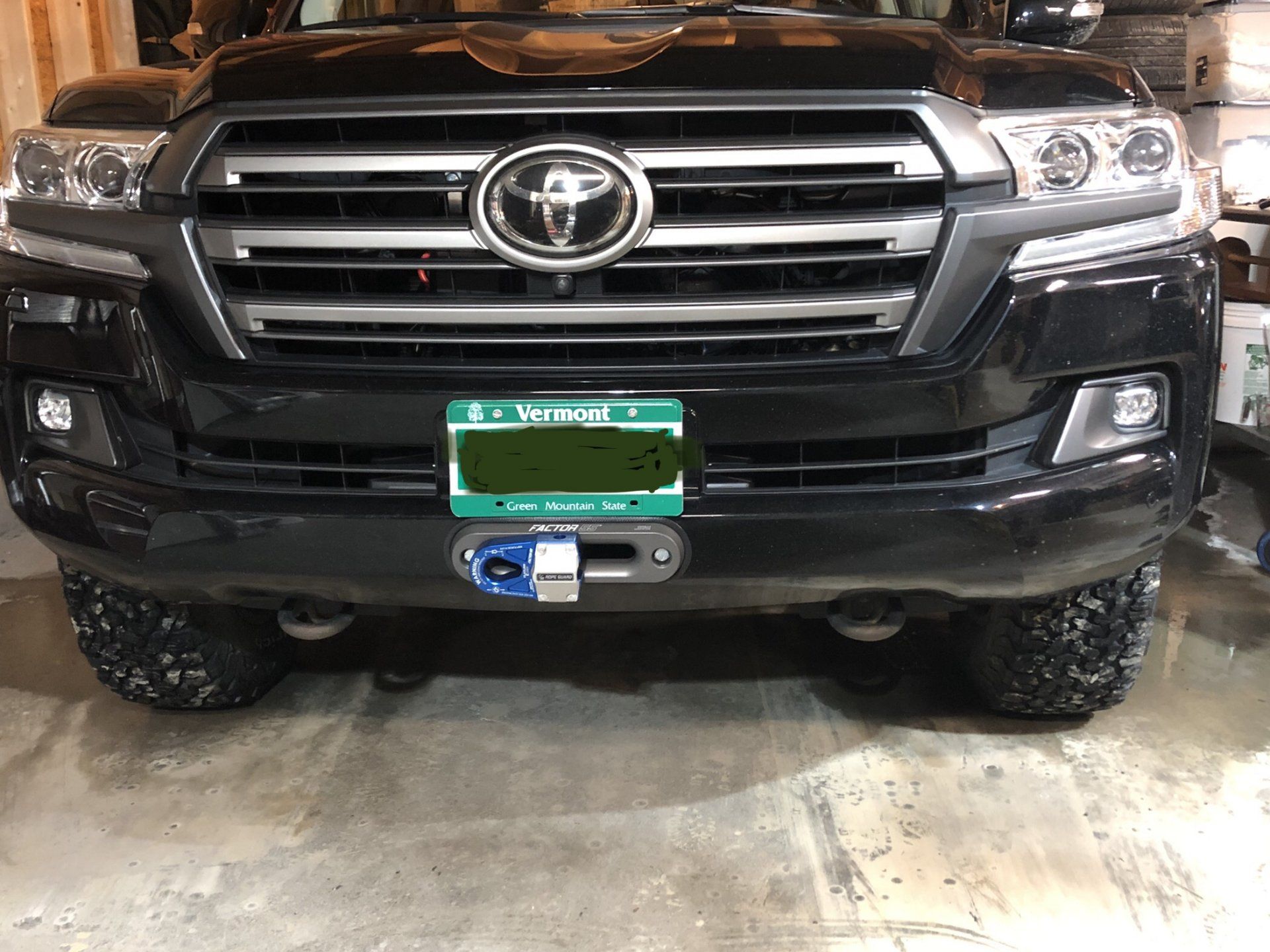

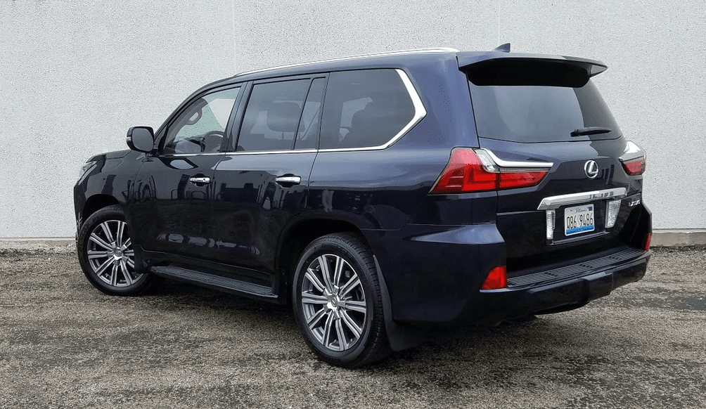

I’m thinking of darkening the hourglass frame in the front and the trim above the license plate in the rear. These pics are not of my LX but are from the internet.

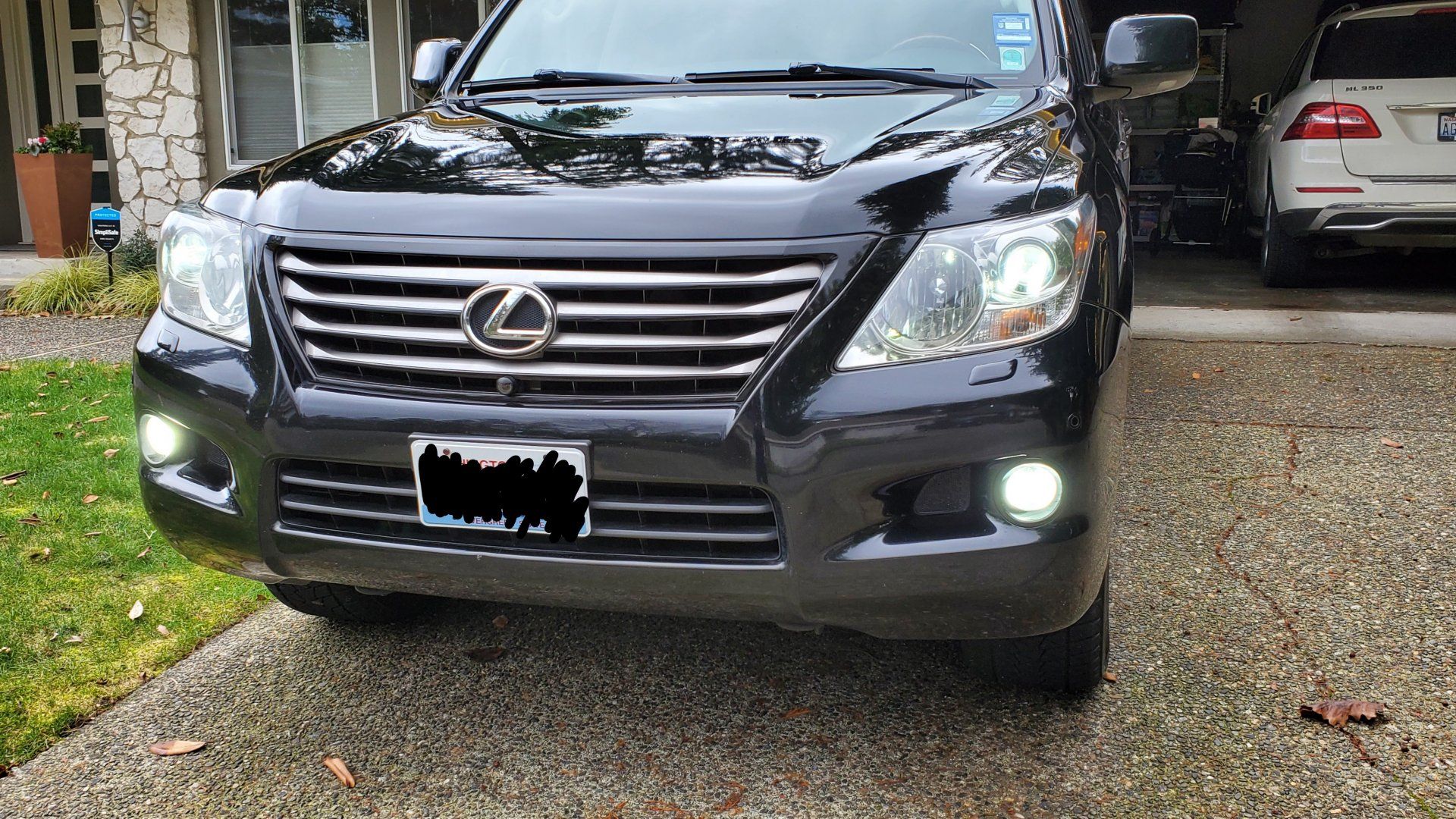

I had a local guy wrap all of the chrome on my 2010 LX570 and I think it looks great. I did not want to attempt myself as some of the chrome surrounds are awkwardly shaped. With the pieces you pointed out, I think you could chrome delete pretty easily.

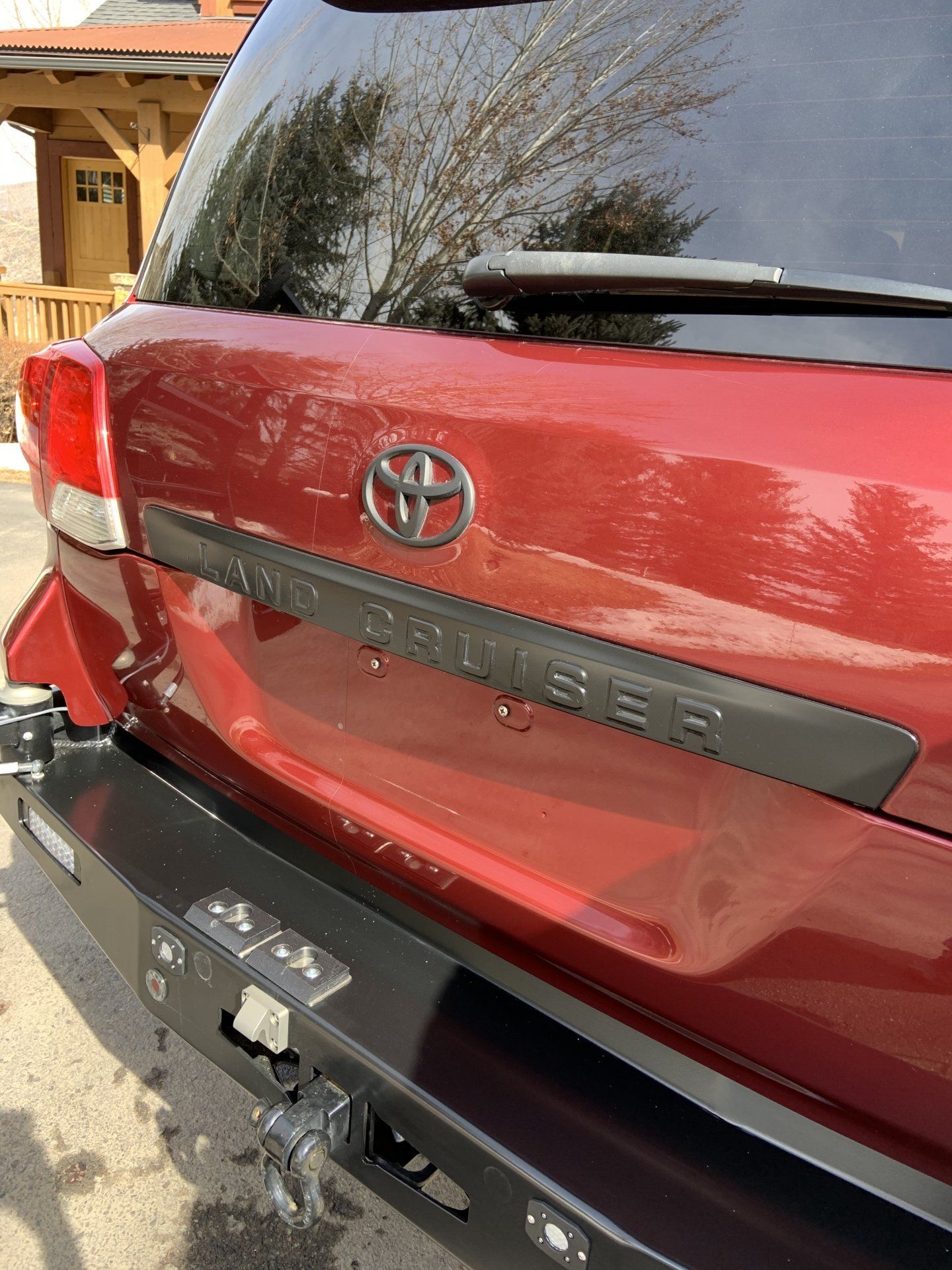

For dipping, I find removing the parts and treating them like I'm painting them gives me better results. Sometimes I mask them off right at the edge (not a typical plastidip approach, since you want to have something to peel) when removal is difficult (like the large land cruiser piece across the hatch).

I did it with 3M Vinyl. Buy more material than you think you need, buy the plastic applicator tools, use plastic razor blades to trim, have a heat gun handy, but be careful to not get too close with it and overheat the material. If you mess up peel it off and try again. BTW. I did pop the Toyota emblem off and sprayed with Plastidip. Cutting around that would have drove me crazy

View attachment 2606909View attachment 2606910View attachment 2606912

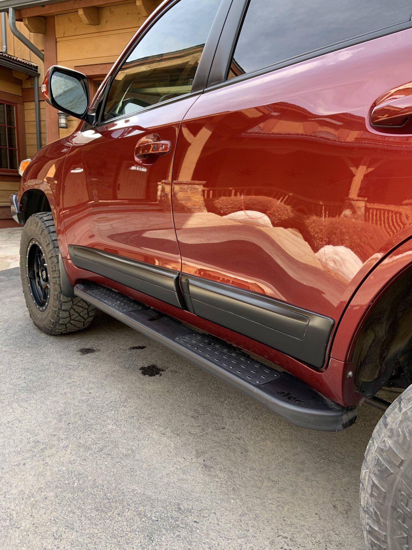

Did your truck originally have the chrome strips at the bottoms of the doors? If so did you remove them yourself?

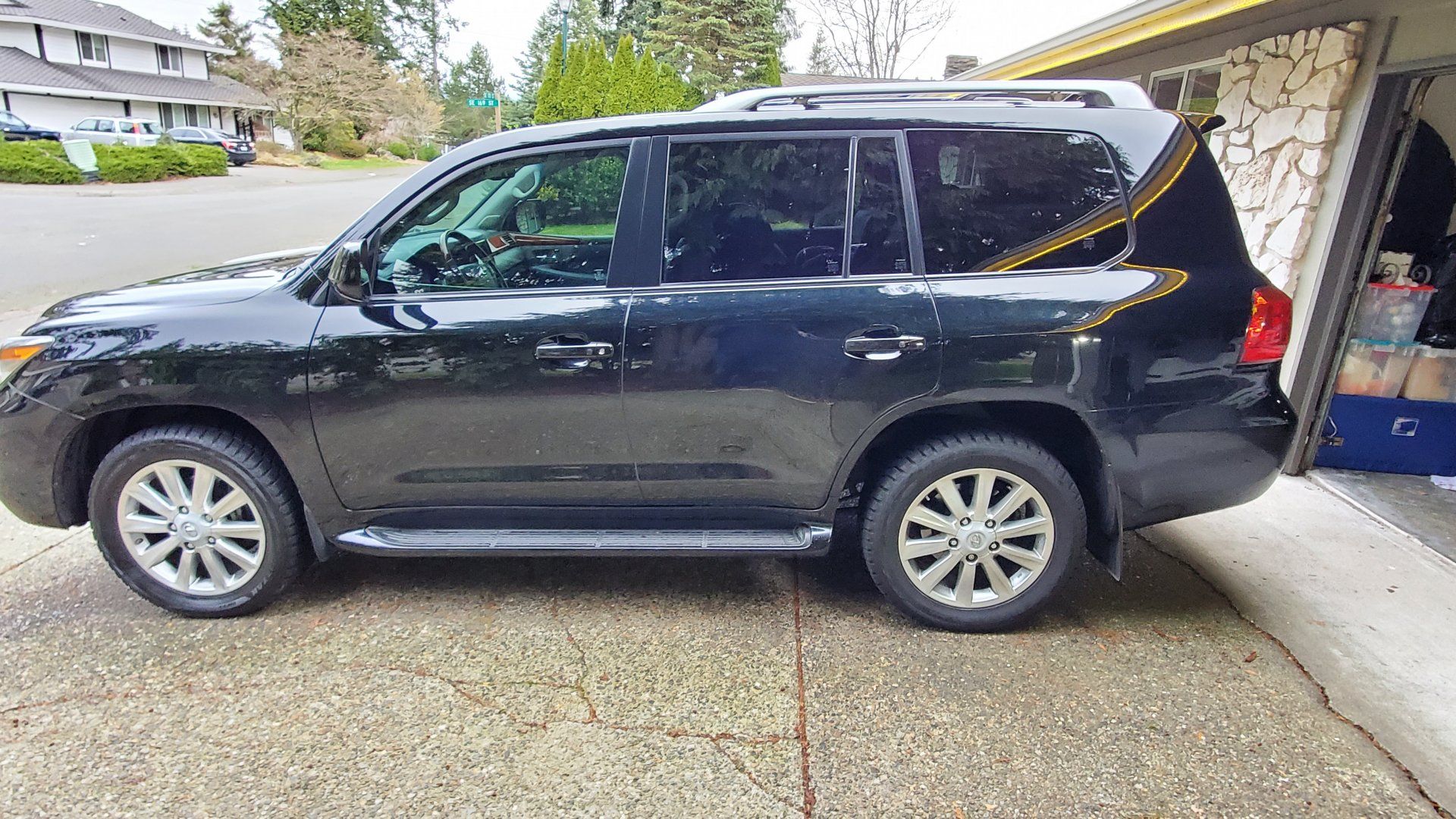

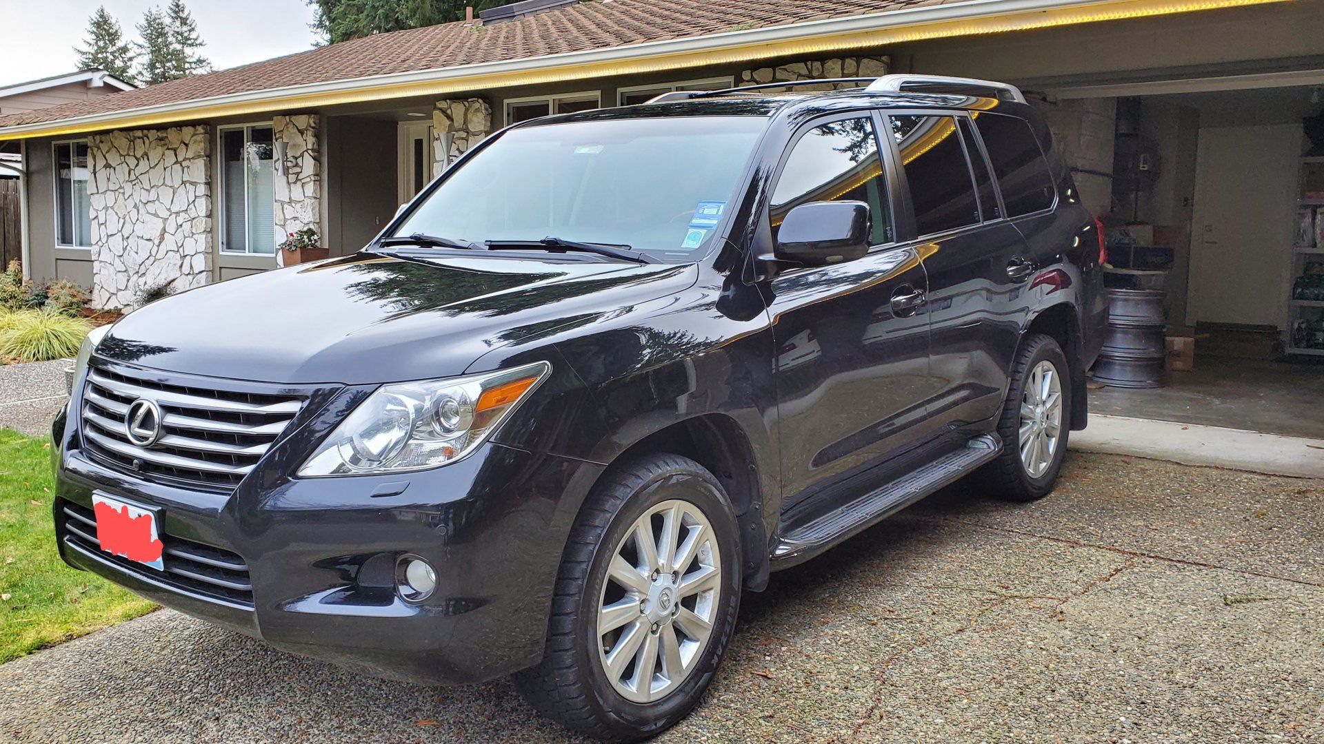

Yes, I removed the chrome door strips and the rear "Lexus" and "LX570" badging myself. The 2008 to (I believe) 2011 model years are just stuck on with adhesive.
I used a plastic pry tool to get a finger under the trim and pulled it off (pull harder than you think). I then used a 3M wheel (decal remover) in a drill to run off the adhesive. Nearly all the adhesive is gone, but i still need to touch up a few places and then wax it once the weather turns nicer here in the PNW.
