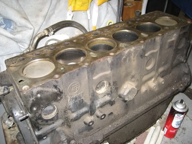

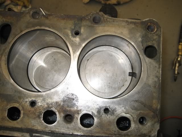

Got some pictures back from the guy. Scoring looks worse than conveyed via the phone. I can't tell if it's scoring or what on the cylinder walls.
I may buy it just for the rebuilt head and oversize pistons. If I go and look at it, what should the cylinder diameter be for a standard bore vs. an oversize bore - that way I can measure with a calipers on site?
