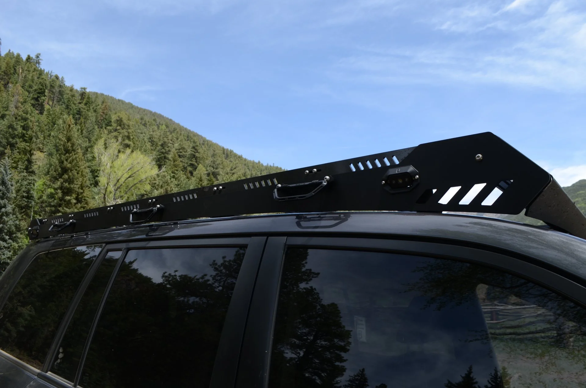

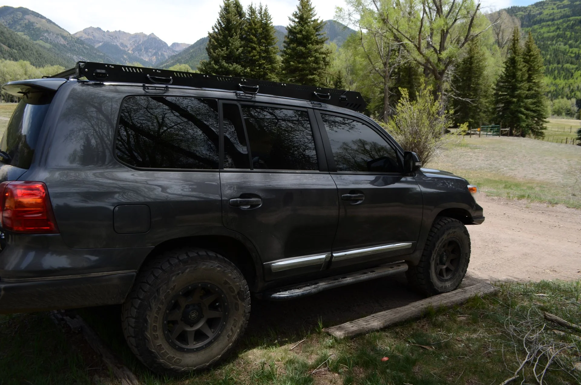

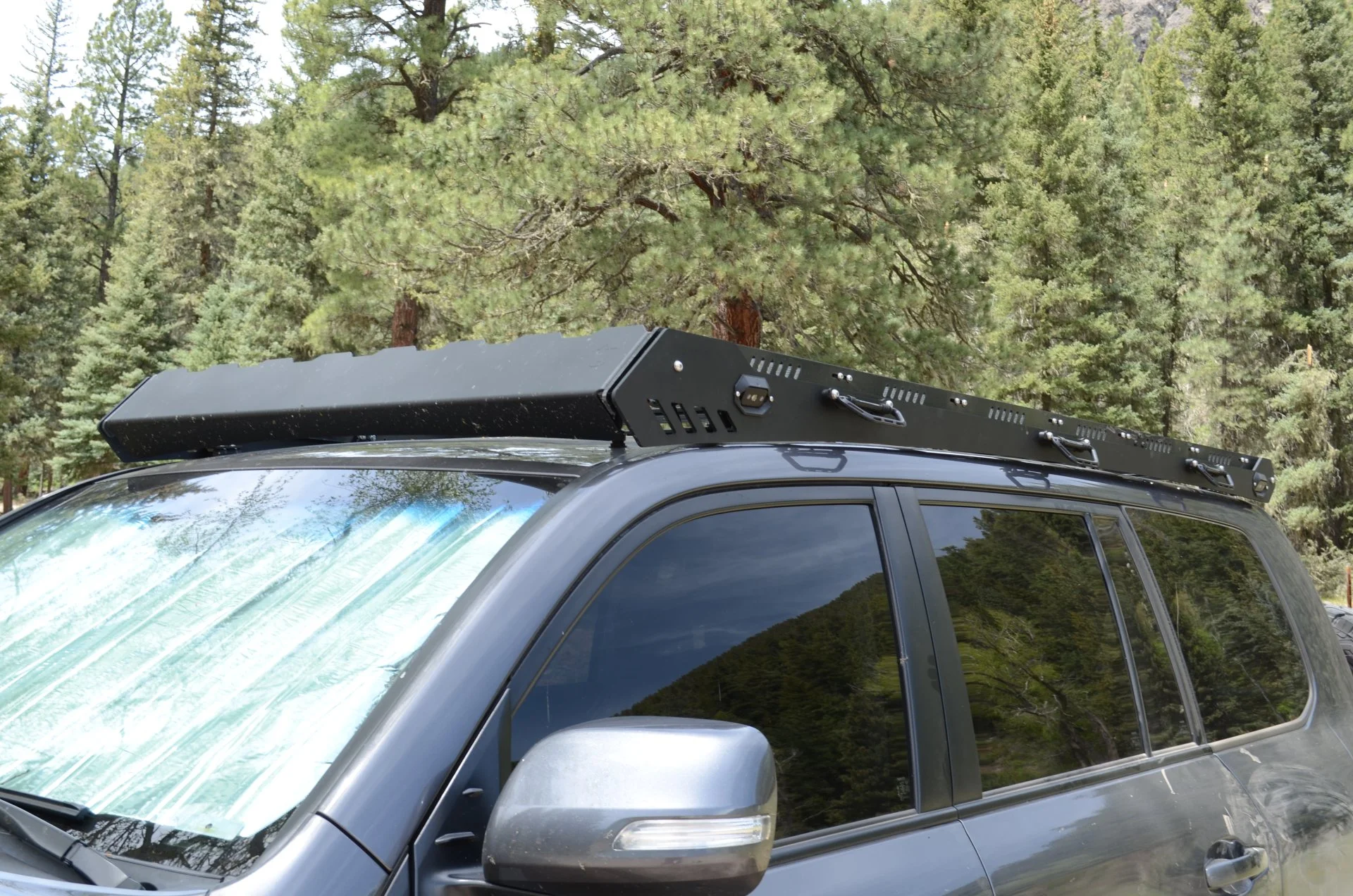

Thought I'd throw out another roof rack option for the community, the upTOP Alpha and Bravo series roof racks. They are located in Castle Rock, CO which happens to be extremely close for me. I had their Bravo series on my 2nd Gen Tacoma and really liked it. For me personally I wasn't a fan of many of the roof racks for the 200 series out there and started to ping upTOP about production of theirs. We chatted and we agreed my vehicle would be their demo vehicle several months down the road. So here I am now having the roof rack for a few months and am extremely happy with it.
Rack and Color:
I went with the Alpha series and had the inner part color matched to the body color. I asked about doing bronze to match the rims but they said they have tried in the past and can't make it look right. Suggestion appreciated and moved on. If you go through their website certain color vehicles look sharp with the color match that pops out.
Lighting:

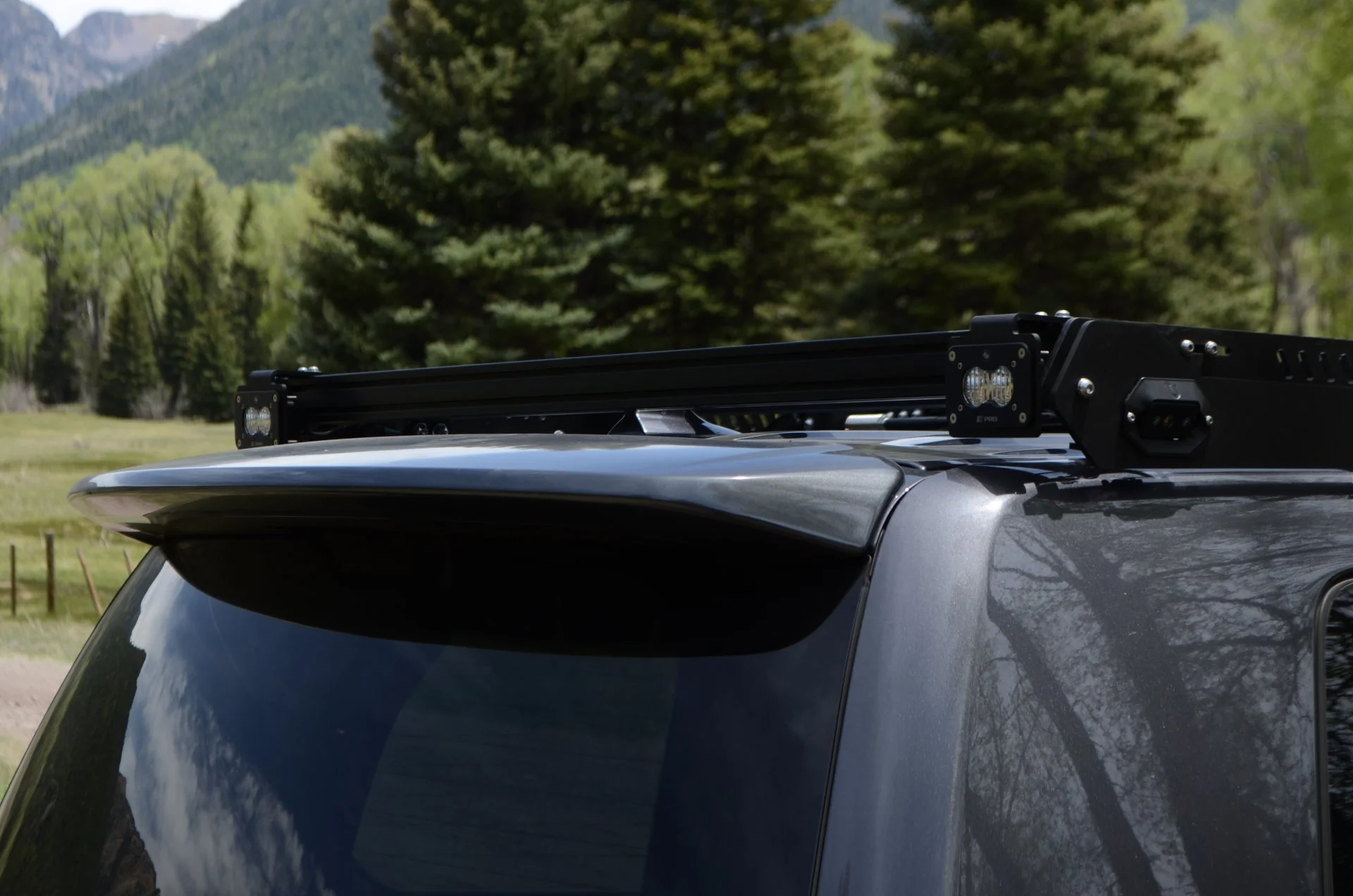

I added the Baja Designs rock lights on the sides and the Baja Designs S2 PRO in the rear. They wired them up to my existing Switch Pros in the cab. I used one switch for left side lights, another switch for right side lights, and lastly another switch for the rear. They do offer a light bar cutout on the roof rack but I plan to put lights on my bumper; eventually.
Extras:

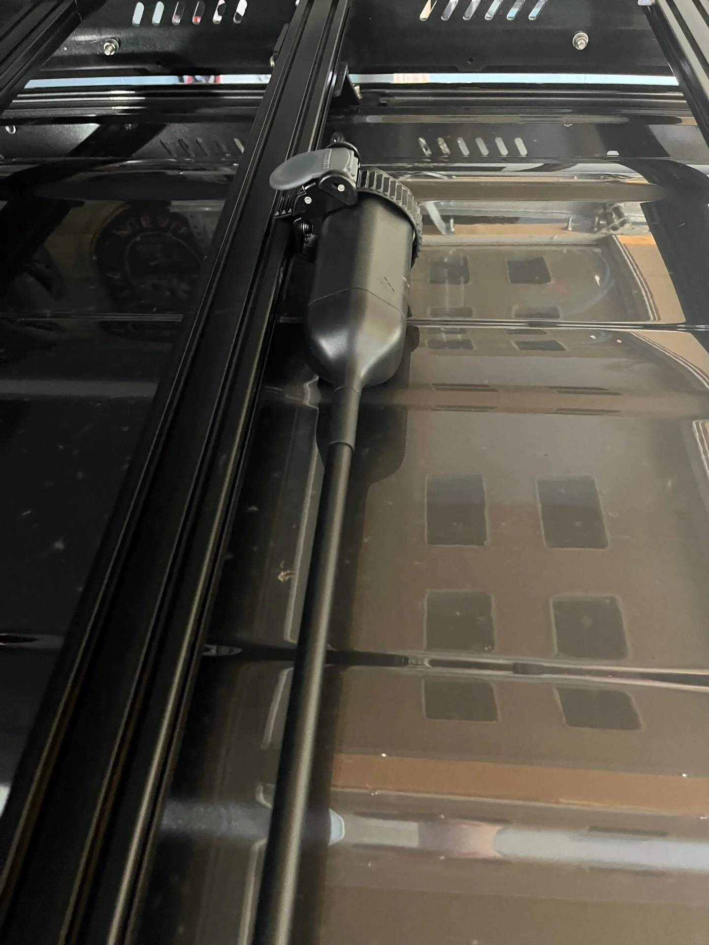

I also asked them to run a weBoost antenna cable into the cab which they did since they were running all the other electrical connections. I used a Rhino Rack antenna bracket to enable the antenna to go up and down when needed. (All about parking in the garage). Then I modified a Yakima Rattler rear wheel bike strap to hold the Antenna in place against a load bar when not in use.
I have zero plans to ever put a tent up there, not getting into here but you could locate one up there if you desire. My plan is an awning, DIY road shower, and eventually some 23zero storage for those longer trips. They offer many different attachment pieces; rotopax, Traction boards, Hi-Lift, and many other options.
Noise:
There is zero increased noise with all the windows shut. I don't even hear it with the windows down. Only time I hear it is if the sunroof or moonroof is opened. Oh and there is no issue there, no contact at all.
I'll do my very best to answer questions or post up more pics and provide a neutral based response to help the community decide if the upTOP meets their needs. My only purpose is to help you all with a decision.

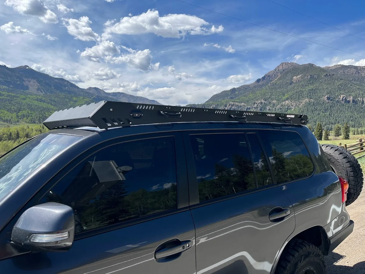

The fairing seems odd. Based on the bottom portion of fairing, the aerodynamics would seem to add more drag(mpg hit) . The gap doesn’t appear flush either causing more upward air when carrying flat items.

No specific comments on their fairing design other than they have stated to me that it is quiet and no more additional noise over stock rack.
To add onto what @dharalson said about the differences; the Alpha gets a different shape outside black panel with an inside panel that you can color match like I did. The Bravo outside panel is black and a different shape with no option for an inside panel. You can see that on the pics on their website.
Also the Alpha comes with grab handles and the Bravo does not. However you can buy them separate for the Bravo if you so desire.
@1Maverick I do understand your comment about the fairing being a different shape. I am just relaying another option that exists for us. I can attest the noise is zero different than the factory load bars. I went back and looked at my gas app and can say before and after install I still average between 12-14mpg. If there is a mpg hit, it is minimal.

The wind fairing was designed to minimize noise and to avoid having any part of their rack touch the car to avoid scratches and damage due to load on the rack. The V shape allows wind to be deflected over the rack and under the rack to minimize noise. They have good videos explaining their designs.

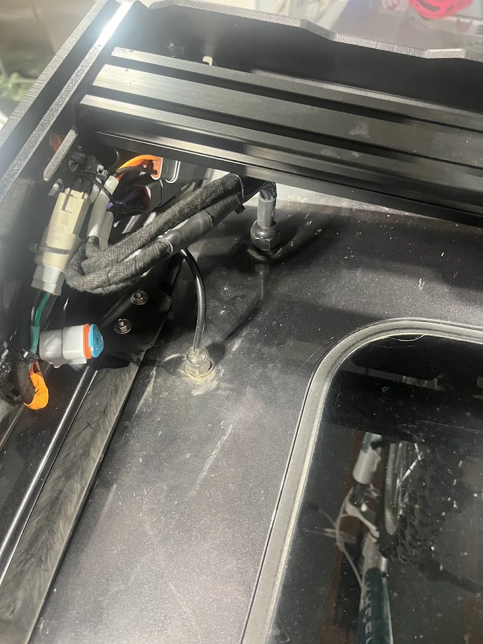

Attached is a picture of the holes drilled in the roof for cab access. The Weboost is the smaller cable where the others are wires for the 6 BD lights I have up there. They also pre-wired for me to have a light bar up top which you can see the extra connector in teal there. Or I can use for something else. Nice to have options. And no you can not see that cluster of wires from the ground, well hidden behind the side panels.
You can easily run power to the roof without drilling holes in the roof.
Rear hatch grommet for the rear and down the front pillars into the engine bay. Then just use the cab access on the driver side.
