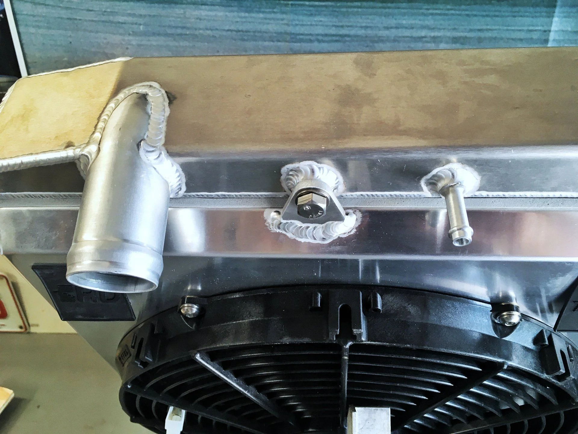

Yep.. opened the big box and it was definitely “Fine Art” under a big layer of expanding foam. After my wife and I extracted it from the professionally padded shipping container.. she exclaimed “it will look great over the couch on the living room wall”! True story!
What we were looking at was the long awaited Ron Davis all Aluminum radiator with dual Spal fans. Impeccable craftsmanship and visuals in of all things.. a radiator.
We will start the install when she gets back from a business trip on Saturday. SHE wants to be the one to slip it into place along the radiator supports. Another true story! I guess all had to do was buy something with gorgeous craftsmanship plus welds and then she was happy to jump right in.

I took a bit of a gamble on this radiator.. more so with the full compliment of Spal fans. I have heard don't do away with the fluid fan. To the other side the debate.. you will not be sorry. I have built a few cars in my day.. including an under 2.5L IMSA Trans Am and SCCA car. Always used electric fans.. even tho' not much of a fan is needed when you never slow down. But on a hot day on the grid or the lap before the green flag a fan is necessary. Built a '72 Scout and yep.. electric fan.. worked great. Plus add a few other vehicles with the same result.
So here I am with my 80 series and I have not been happy with the cooling when fully loaded and in addition towing our small military style 821 pound loaded trailer on long climbs when it is hot. I have not overheated as of yet.. but I have sure raised an eyebrow at 220º. That temp does not work for me.. I know I can get those high temps down as that type of heat under a load and over time can kill a lot of things.. starting with a head gasket. If I can drop our max temp 10º.. I will be ecstatic.
Currently and before the Ron Davis I had completely overhauled the cooling system. Deleted the rear heater. New radiator. Hoses. Louvered hood. Blue hub fan clutch w/fluid change. New fan. Spal pusher fan for slower speeds. Works excellent when it is 90º and the route is reasonably flat. Unfortunately I live at 5k' in the Sierras and everything from here is UP. At least all the places we want to go.
Since the cooling system is at 100% and I have a 150amp alternator it will be interesting to see how all my hoopla over this major addition works out. I sure hope my thoughts and rough calculations are in the ball park. Otherwise I will have an expensive piece of fine art hanging on the wall over the living room couch!

Price.. not inexpensive. Definitely more than the normal realm than Koyo.. CSF and OEM run in. I am keeping a cost ledger for all of the bits and pieces.. and of course the initial expense. I will post all of it once I get this wrapped up. If it is no better than the stock setup that I had.. I would prefer keeping the dollars quiet.. so as to not look like an idiot who doesn't have a clue where to spend his LandCruiser funds! However if it works great it will be money well spent and I will be a hero within my own head!! 😎 Plus I will be bowing to the southeast.. home of Ron Davis.. with whom I shared my credit card number!
