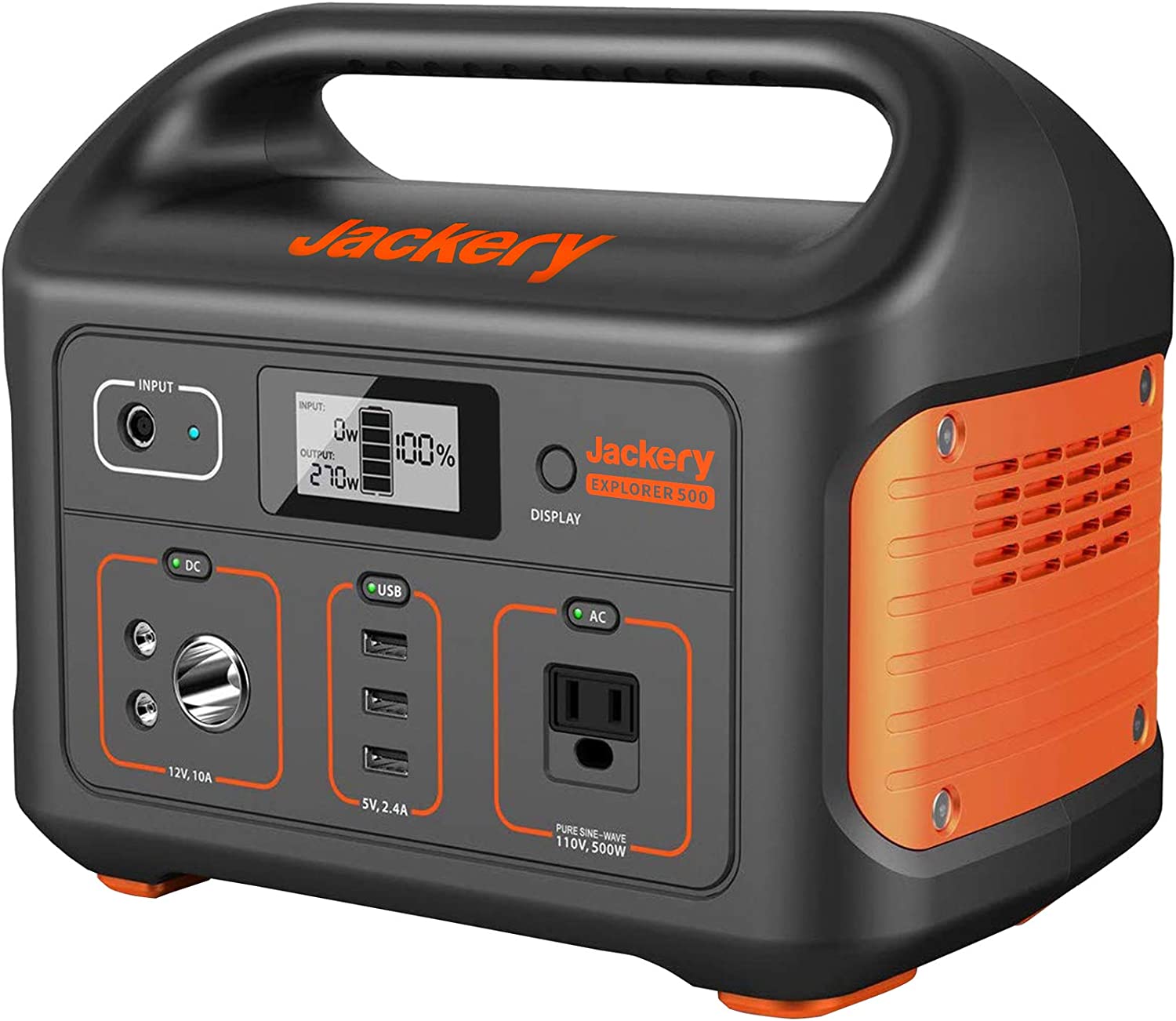

Have you considered not using an AGM or LFP battery at all, but instead getting one of the larger "solar generator" (I hate that term) battery packs?
Something like this: Amazon product ASIN B07SM5HBK1
For some reason the Amazon links aren't showing for me, so here's the picture instead:
And then using a lightweight flexible 100w panel to charge it? The flexible panels are light weight enough you could put them in a Land Cruiser attic (the net thing that creates a storage area under the roof).

Definitely have considered that option quite a few times in the past. The portability and price are great too. Can easily just bring it inside and avoid the whole AZ heat issue when not using it. Would save a TON of money going that route too.
Can't say I have a solid argument against them, just not the route I'm looking for this go around. Had my cruiser for about 6 years now, and I'm somewhat renewing my vows to her this go around. Got a lot of little outstanding things addressed to the past 6 months. So, nows I am onto the fun upgrade part, spending some coin on her, and doing more long term type of installs. Trying to think 5+ years down the road what I think I'd want to have, vs what would be the easiest and cheapest now option. That's probably my main struggle with Lithium vs AGM debate. Lithium is not quite where I'd like it to be right now, but I know its the future, and it 5 years it probably will be in a good place.
Not trying to convince you, but it's not a bad strategy to consider.
