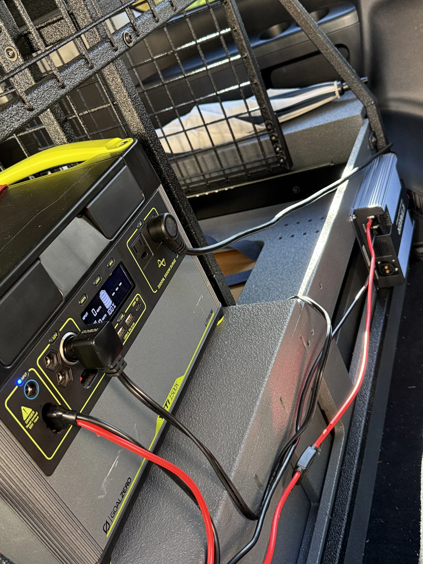

I wanted something that would charge relatively quickly while driving. So I just kept it simple and wired in a 120Volt AC inverter in the rear. I use the AC charging brick when I'm driving which pumps in 500watts. I don't think I would want to pull much more than 500 watts from the stock alternator.
It's a simple solution with the added benefit of having some AC outlets accessible in the rear (while car is running) with or without the battery bank.

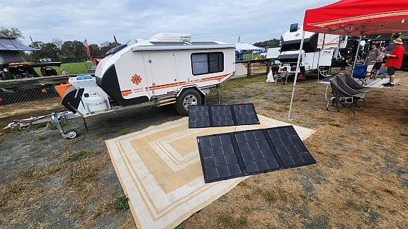

Kimberly Caravans booth with Merlin XP-170 Solar panels at Overland East 10/2023
Our Merlin XP-170 in heavy use at Oregon Inlet Campground 6/2024:

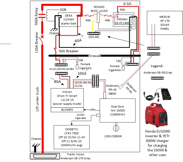

The block diagram below is what I've done so far to support camping in general. The refrigerator can run off either the Goal Zero or the Odyssey battery under the hood. The SB-175 is used to charge our trailer under tow.

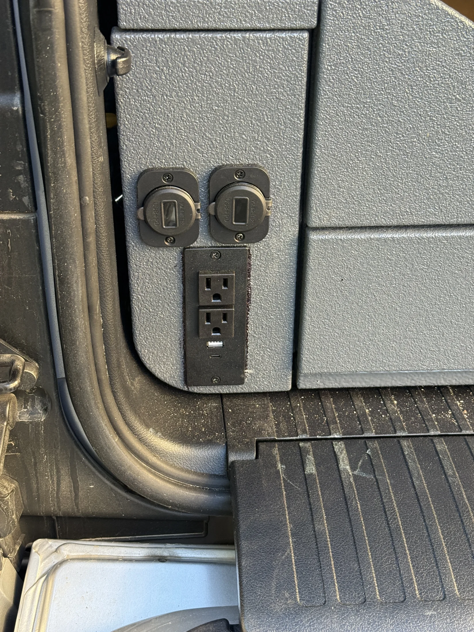

These supply the face mounted outlets:
-12V mounting block to supply two 12V USB round ports.
-Household plug extension with 2x110 and 1 each USB-A &C. https://www.amazon.com/dp/B0D3WDC1MC?tag=ihco-20

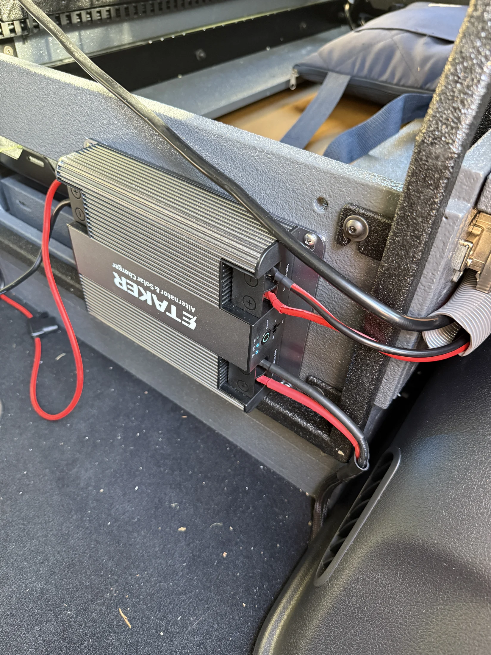

I'm pretty happy with the charging rate now. I've limited the current to 300w alternator, and 400w solar. The Etaker did take a bit of fiddling in its app to get it dialed in correctly too. But now seems plenty fast to get the battery charged up. Sunny days are no problem if I watch where I park at a trailhead. We did a 4 night camp in the Whites with a fridge, induction top, 600w hot water pot, and miscellaneous USB camera, phone, etc. Everything went pretty well except the night she wanted to boil potatoes on the induction top. Drained 40% out of the yeti pretty quick. I could see a couple days of cloudy and parked could become an issue with the cooktop. Although eggs, meat and pancakes seem to be quick enough- Long boils are the issue. So thinking about a bit higher capacity battery.
Having everything- ,battery, inverter, BMS, 12v, inputs, outlets, USB smarts- in the GoalZero sure makes it easy, I just plug the 120v into it for the inverter, and fabbed a 12v anderson line to supply the round 12v ports I installed in the drawer wing face. I made a powerpole cable to supply the power from Etaker to the goal zero. I have the Goal zero facing front on the drawer side of my Trekboxx. I haven't bolted it down as well as I'd like quite yet, just a strap, enough while I figure it more permanent layout.
The Goal Zero (or a similar power station) sure simplify some of the electrical work to plug and play and also provide some ports mid ship in the second row- but they are not great for packaging & arrangement. Although the overall volume is nice and tight relatively, there's no chance to hide it in a wing or mount on the face of the drawers behind the 2nd row. It takes a modest chunk of space in the main cargo spot on the drawer deck and could be subject to things being piled behind, on, and around it.
I think with the Etaker I could go directly from Etaker to a LifePo battery like the new Renogy SuperSlim or this crazy deal one I've stumbled across this morning. 12V Lithium RV Battery - 3 kWh - BatteryEVO RAZORBACK - https://batteryevo.com/product/12v-razorback/. I'd need an inverter too, but that seems straightforward enough.

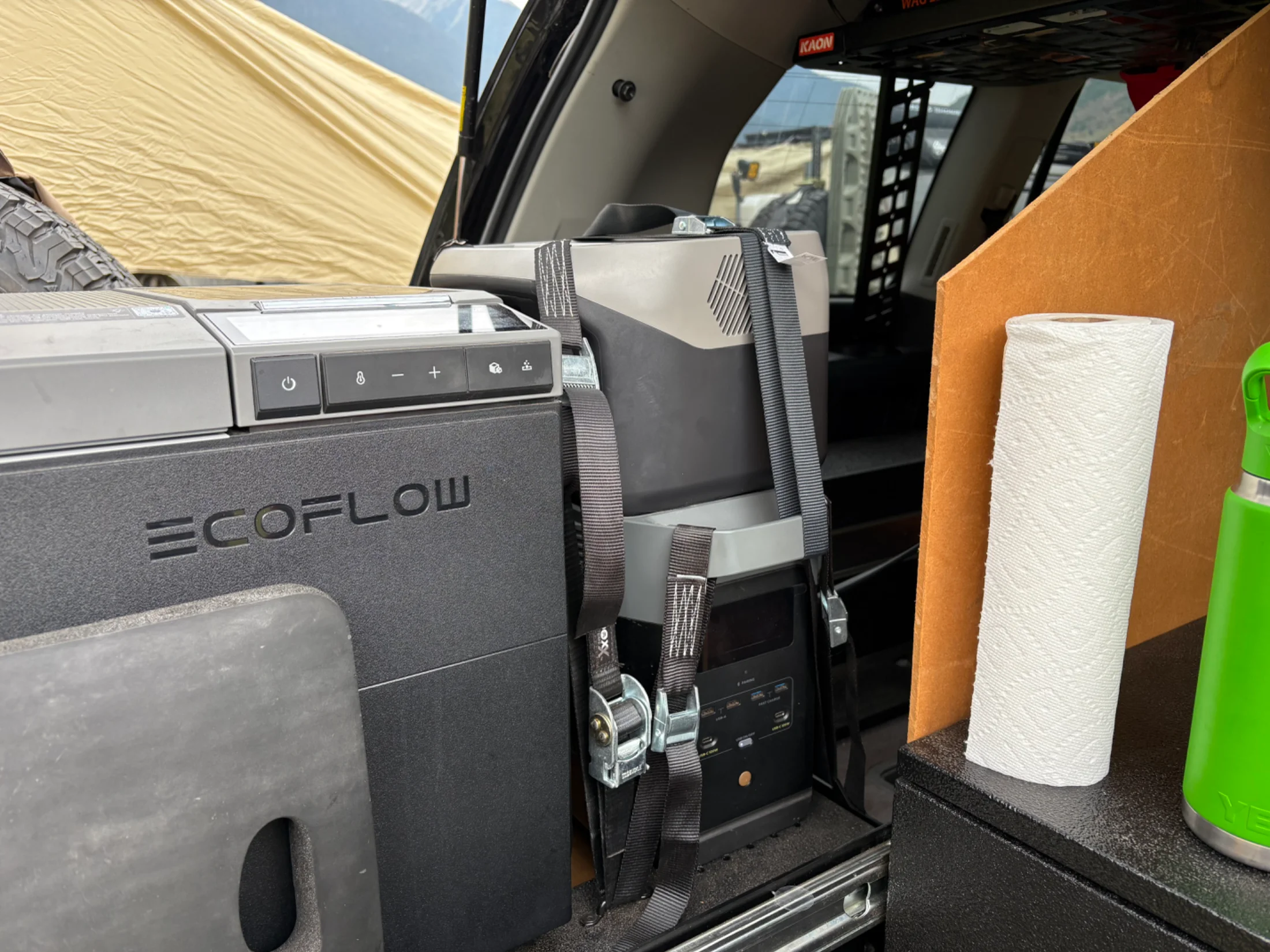

Somehow, I missed this thread as I built my system which is based on EcoFlow devices.

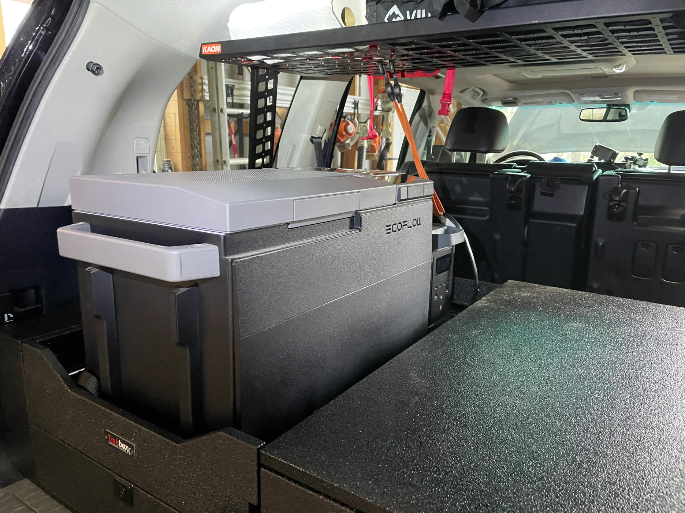

My setup is based on a Delta2 (1024wh), a Glacier fridge (with its own builtin 300 wh battery) , and a 300wh River plus EcoFlows alt charger. Currently I have no solar but will add that at some point.
Functionally, this all work’s pretty well. I generally drive enough each day to keep everything charged with the alt charger set at 300 w max. Sometimes I drop it to 200.

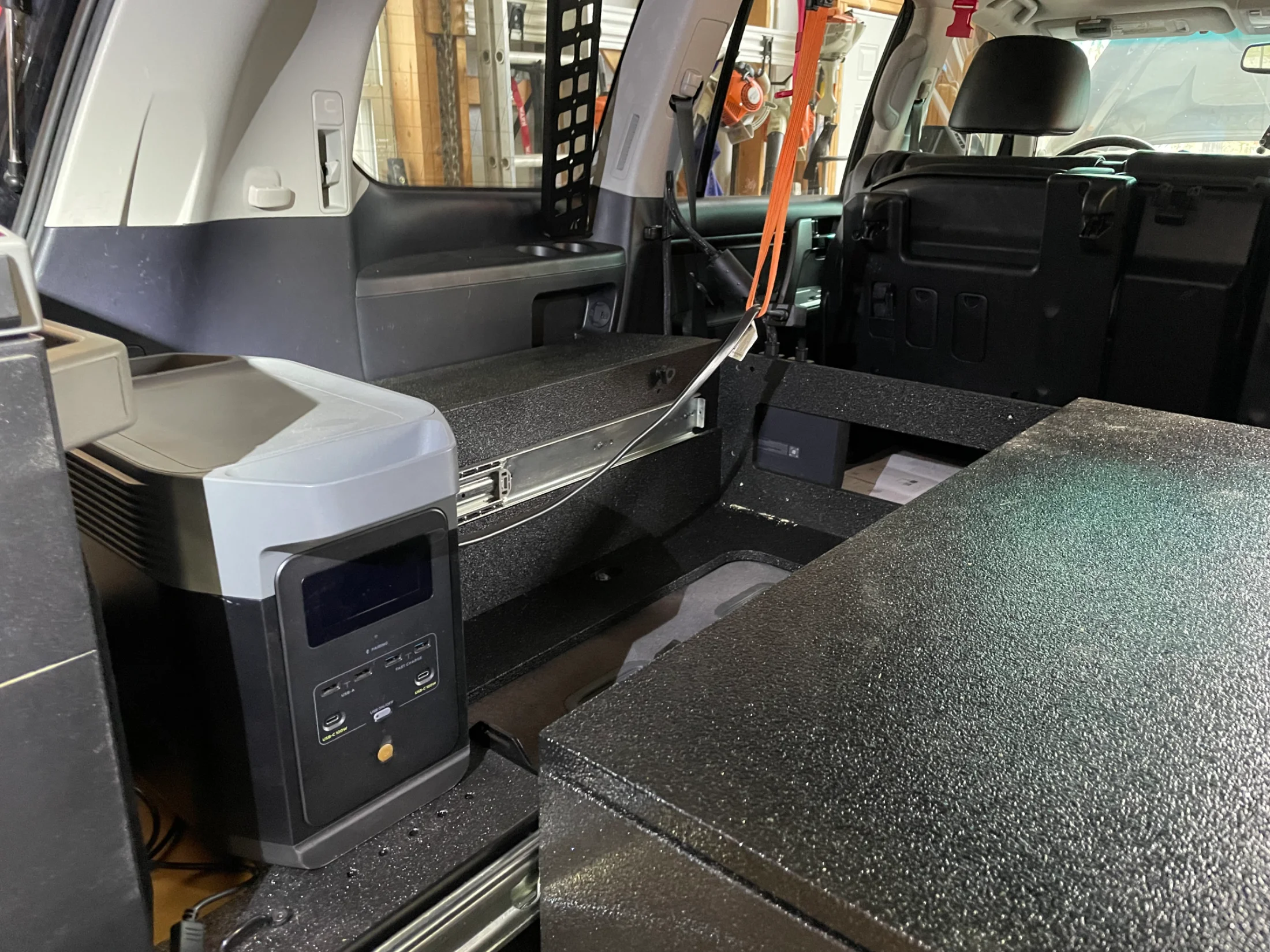

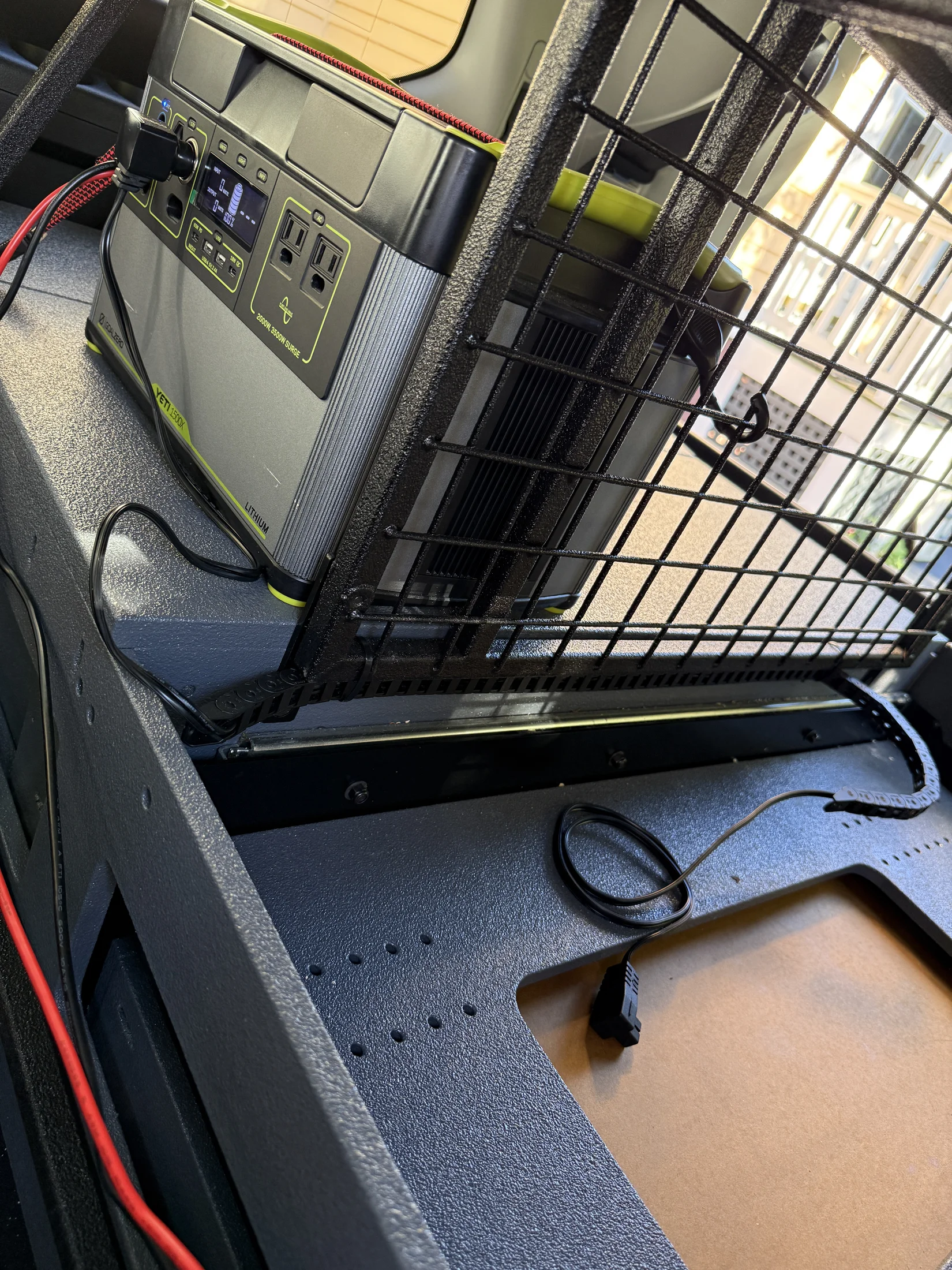

It’s all mounted on the fridge slide out (except the alt charger) with straps. I’ll eventually make some cleaner brackets but space wise, this works great. The straps have survived some fairly hard wheeling in Moab and in Ouray. The alt charger cable management system (bungee cord) looks a little cheesy but works. I also need to sort out what I want for cargo dividers. All a work in progress.
I tried my GoalZero on the slider both in front and back of the fridge at first. Workable and it was nice to have the GoalZero outlets right at the back, but if I had other stuff plugged in it became a bunch of cables moving back & forth or unplugging/plugging. Moving the power station to a fixed location allowed me to use a plastic cable drag chain/snake thing which works great to manage the fridge’s single cable. But…GZ now takes up cargo room elsewhere. I have my water jug behind (tailgate side) the fridge now.
I debated a long time on the EcoFlow stuff, looks quality and just works. I went cheaper in the end since I had the goal zero already. And now that I’m diving into it I feel like I can build it out just the way I want…with the right form factor battery.

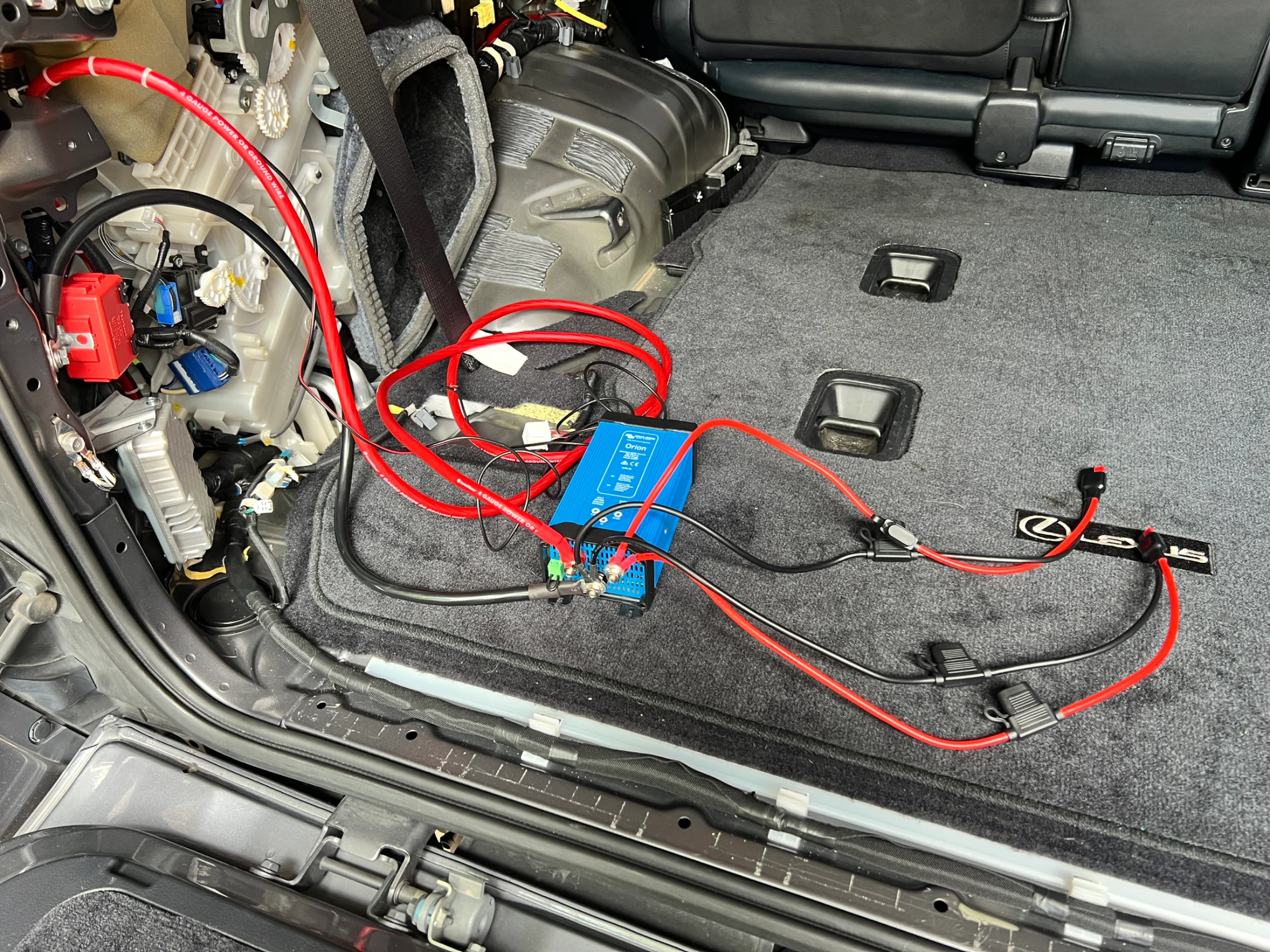

Charger mounted same as yours. Solar on top coming from a XT90 port in d pillar near the factory inverter socket. The black 110v wire coming from the GZ to a 110/usb combo socket in the back wing face.

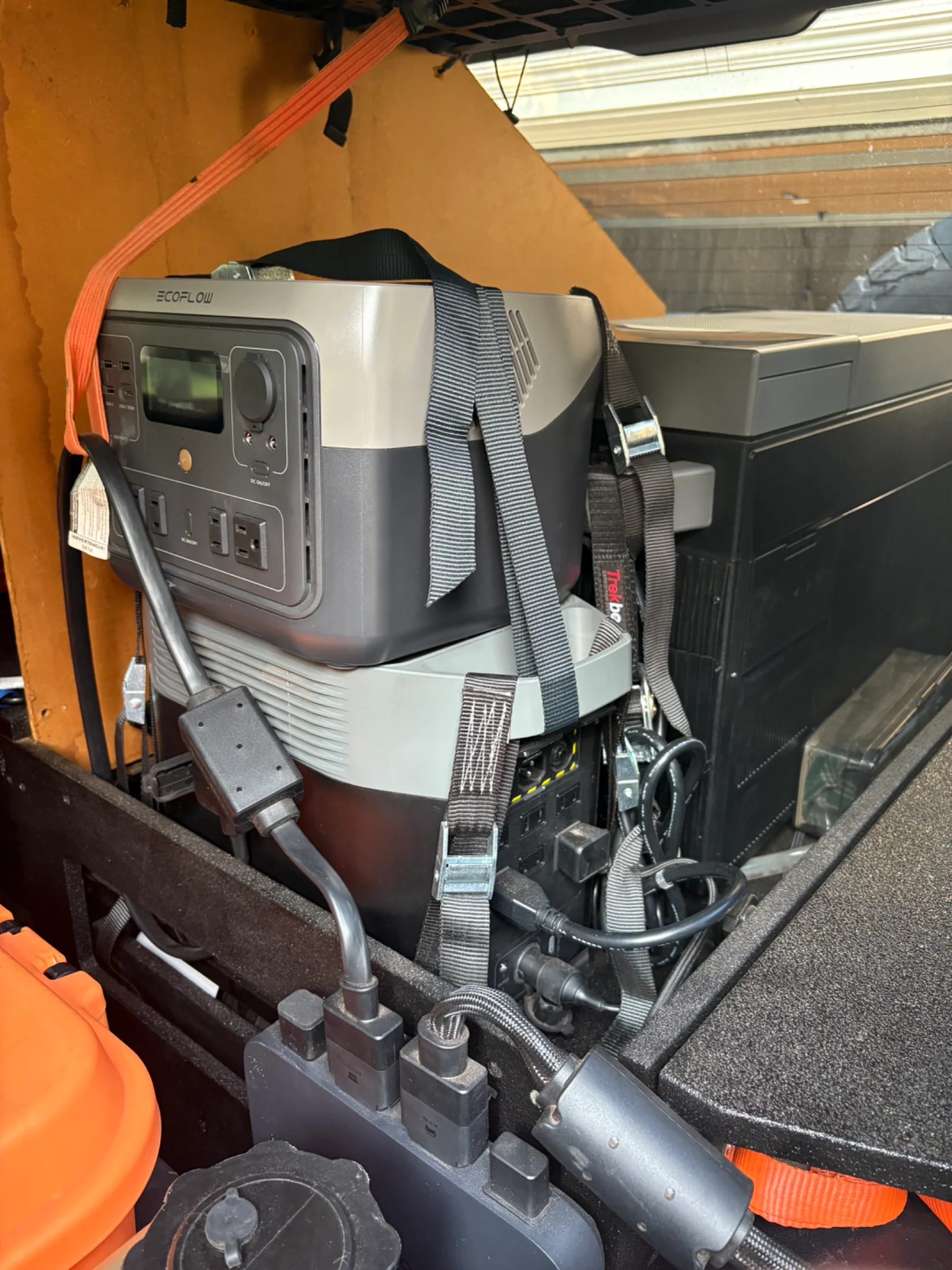

Bit of spaghetti bowl here. 110v coming from the GZ, 12v as well, xt90 outlet supplied from the roof then runs to the Etaker charger. All shoved in the overstuffed cable conduit.
Yeah, I’m going to look at those drag chain things. I initially thought that having the battery on the slide out, was going to be a pain for the reason you described but so far it hasn’t really been a problem for me. Anything I plug in to the batteries are on the slide out. The only random things I ever charge while stationary With the delta two are my Apple Watch and headlamps or maybe radios. I just set them on the slide out or on top of the battery while I’m doing that so it’s not an issue. I’ve run a short AC extension cord with three outlets on the end from the battery to the front of the fridge that just sits on the slide out this lets me plug in my induction burner or any other random thing I need for cooking.
