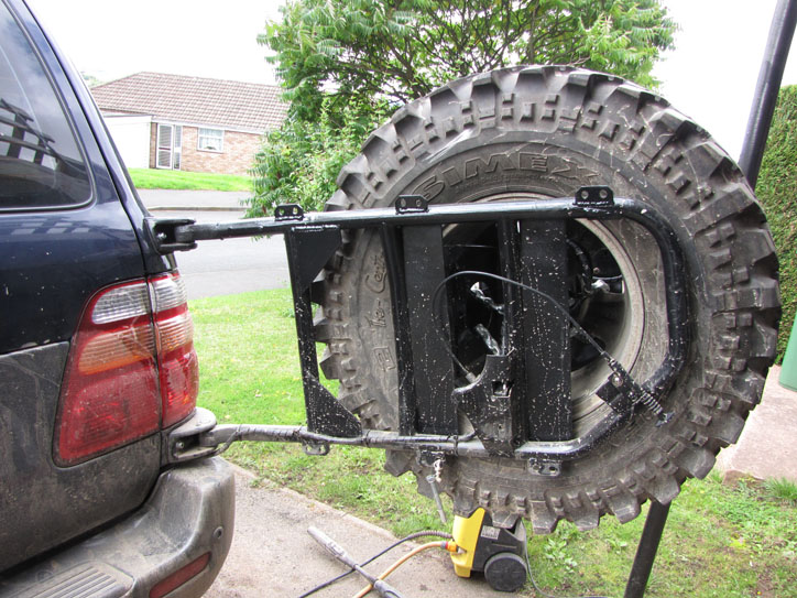

I've put an OEM style body mounted carrier on mine that latches on to the tailgate. It sits up a lot higher than a bumper mounted swing out and doesn't stick out as far low down when you open it. They only do them for the right side AFAIK but a decent fabricator could probably make one for the left side.

Do you have a picture for this?
Some plates I had to make for inside the body panels:

That's a fkn sweet option! I'd love an oem one I didn't think it was possible!! Great work wild.
Interesting...Have you had any issues with this setup? I did this to a cherokee, and ended up with wavy sheet metal after a few extreme trail runs. The may have been due to it's unibody and heavy tires.
By the way, what tires are you running. They look almost like LTB swampers. Also, what are the knobs on each side of the hitch?

The carrier I bought is a copy of OEM, not an actual OEM which is why I called it OEM style but AFAIK they're pretty much an exact knock off. Mine is eBay item 260350795368 and that has more pictures of how the catch fits in with our lower tail gate licence plate space. If you compare pictures you'll see I cut off the wheel mount and moved it across and up a bit to accomodate the big tyres and added the receiver for the licence plate.
It's very solid, fully open I can swing from the end of it no problem and I guess I'm about 200lbs. When closed it rests on the latch and also a bracket on the upper tail gate so it's well supported. The OEM installs come from the factory with extra supports in the body so I made up those plates in my last picture and they seem to be as much as you need to do to make it work.
The tyre in my pictures is a 36x12.5x16 Simex ET II and they're quite heavy. The 'knobs' are trailer electric sockets :)
