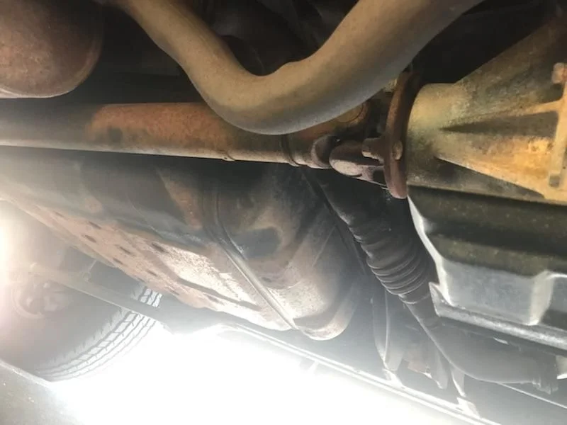

this vehicle has 108K miles and other than ripped seats, it has some minor body panel dings. No rust on the panels at all. Based on others Ive seen, this doesn't look too bad and I believe I could resolve in a few long weekends on my back. The mileage is so enticing and if I get a good feeling about this corrosion then I'll spring for a PPI. I drove the vehicle and it drove well. All electrical worked. Timing belt was done at 85K.
Would appreciate some advise please. The asking price is $12K.

That's probably good. Low mileage on a truck that goes for 100's of thousands of miles isn't necessarily that important. As far as the rust, it's not great and everyone in the north will say "not that bad" and everyone in the south with say "run, run fast, wouldn't touch it with a 10 foot pole." Wish I could be more helpful.

I'd hunt for more rust, what's shown might be OK, risky though.
^^^What he said, if you're concerned about what you can see, drop the skids and check places like front sway bar mounting brackets, etc.

It doesn’t look terrible. Every chassis has its weak spot. You just need to know what to look for and where to find it.
For example, nearly every GM truck in New England with rot issues can be found in one of two places:
- The Passenger side frame rail where the body mount point is welded to the frame - just as the rail starts to curve upward toward the engine
- The crossmember mid-way down the chassis that goes over the fuel tank. The inner section always gives was and it’s where you’ll find patch welds
In terms of the 100 Series Land Cruiser, I’ve seen super clean frames and then fully corroded examples Where there is no trace of factory paint. Rarely have I seen a fully compromised frame, but the couple I have seen were rotted through the rear trailing arm mounting point on the chassis.
Usually, the main frame rails will remain solid even in the rustbelt. The first places to start a frame inspection is at every single mounting point (body mounts, crossmembers, suspension mounts etc). Anything welded to the main rails should be thouroghly inspected, which means poking questionable areas with a hard, blunt object like a brass punch or something similar.
I feel like people see rust and run without even inspecting it and very often run away from a really good deal.
