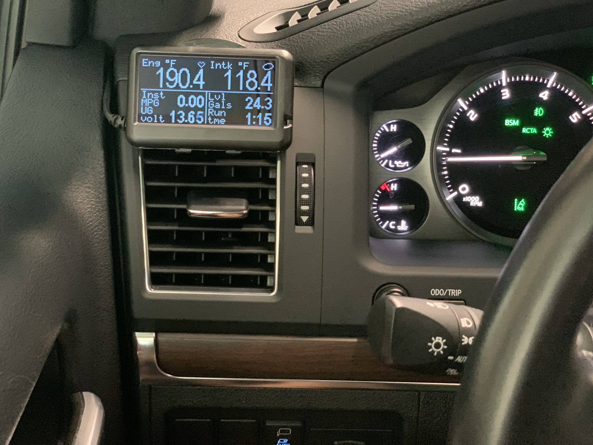

What mount are you using? Can you get to the buttons on the back okay?
I’m using the supplied hook and loop adhesive square that comes with the kit. I ordered the vertical mount as well. Experimented with both and found the simple hook and loop to be my choice.
Yes, you can reach the buttons as mounted. It’s a quality system. The construction is very nice.
