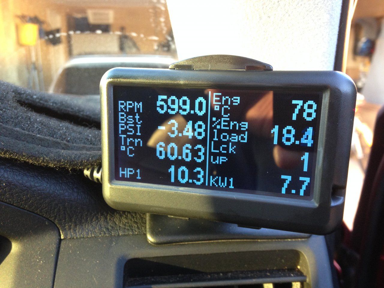

got the mx v1.3 ultra-gauge delivered today,
spent the Arvo playing with it
after a few frustrating hours I finally got the trans temp and torque converter lock ups to read on it
Very happy with product and cheap and easy to use

got the mx v1.3 ultra-gauge delivered today,View attachment 966486
