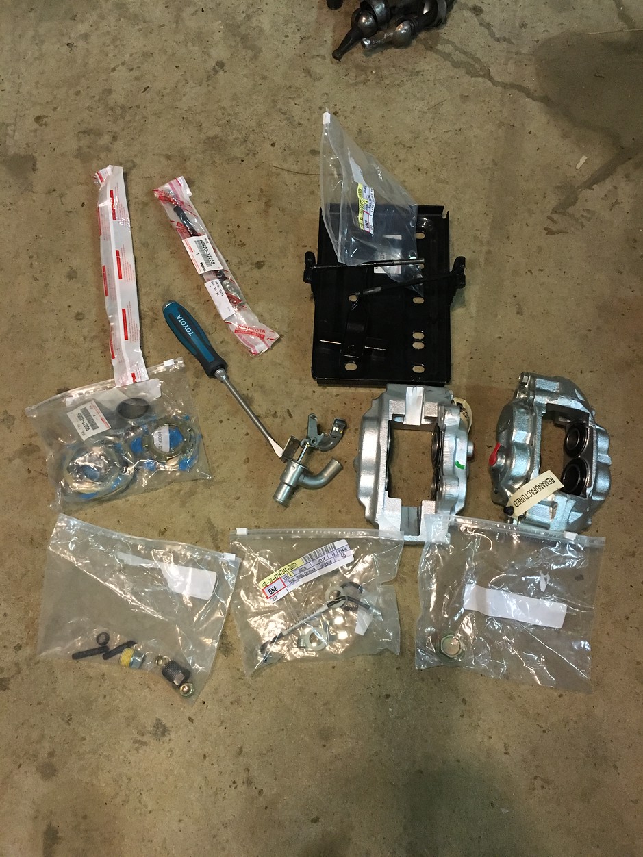

Just bought oil plug gasket for 68' LC with the plug in the middle of the pan, timing cover gasket and fan belt.

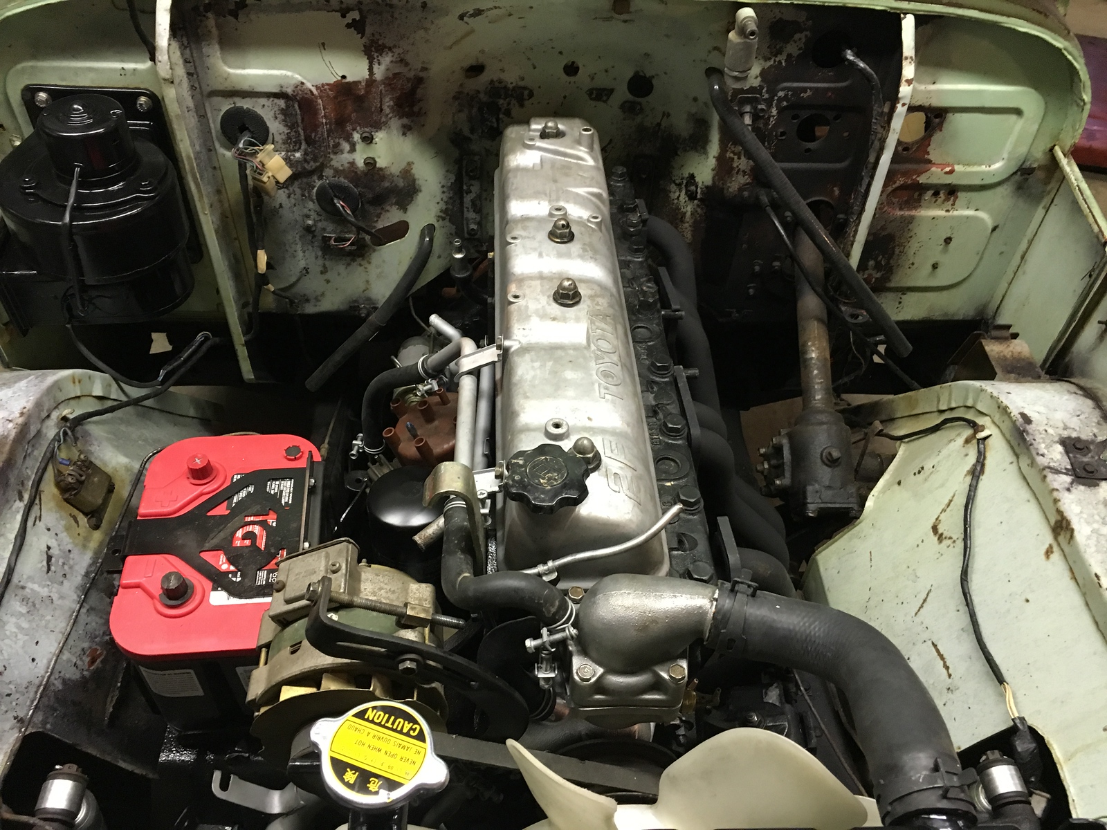

I have been "melding" an updated drivetrain into a 1968 FJ40. Lots and Lots of OEM parts in this build. @beno is the source for all of it.

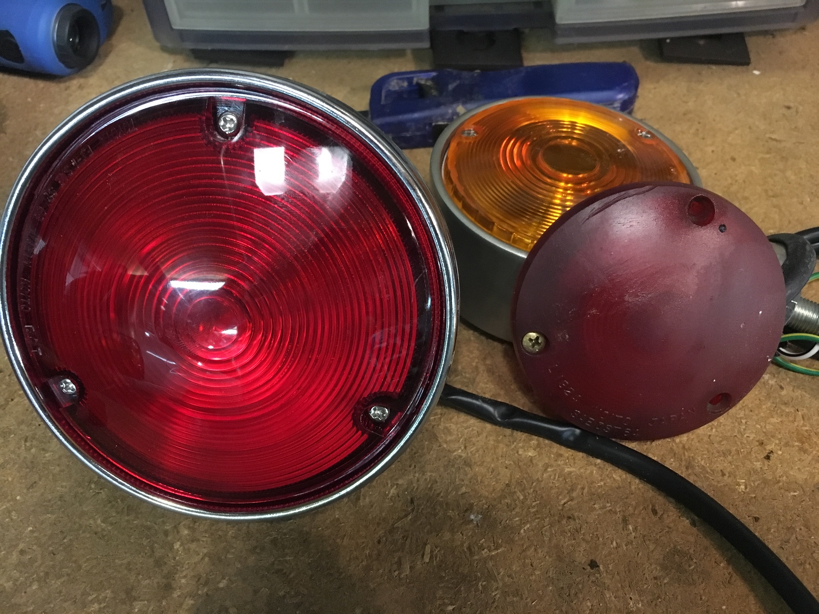

The smaller cloudy red lens in the small ones that were on my 40. Unobtanium......

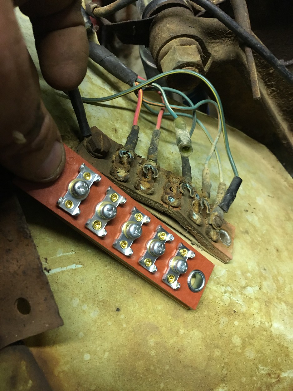

Wiring panels

More pics of OEM stuff in my build thread. If you need it, email @beno.......
November 1968 FJ-40 Project

FWIW For my frame off rebuild that I finally started last month, I just ordered the following for my 82 40 from my local parts dept:
-engine gasket kit
-exhaust manifold stud (to downpipe) + gasket
-fuel sender
-ebrake cable
-oil pan + gasket
-belts
-leaf spring shackle kits
-rubber tip (above post)
-RR FF axle shaft
Only thing I couldn't get were replacement fuel tank bands, so I'll remake them out of 16 gauge s/s
