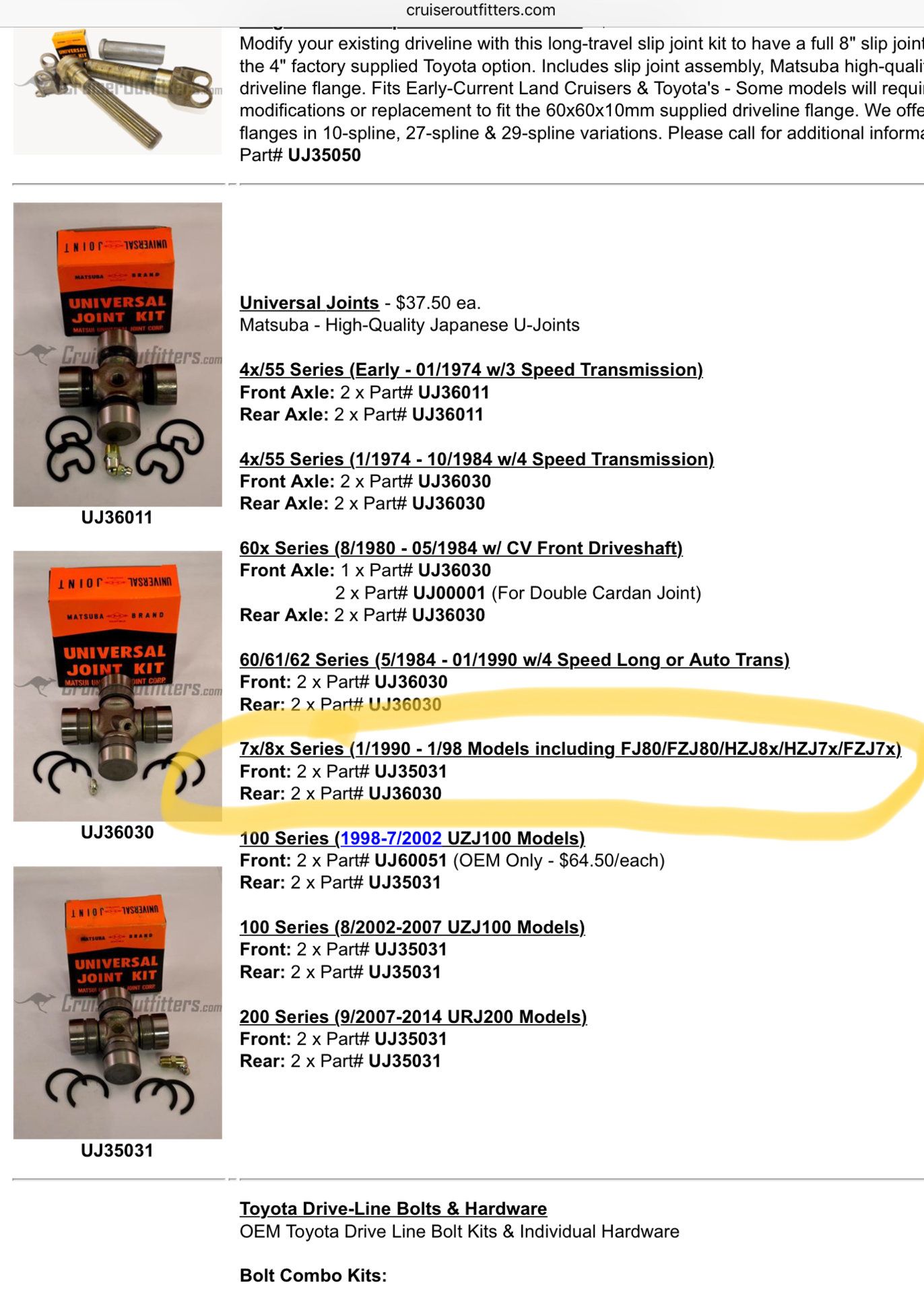

Would the Toyota 04371-60070 stock ujoint be larger or smaller. If I can find out I can order the complimentary 2 from cruiser outfitter to complete the set.
Those are the small (front) equivalent to our UJ35031, the rear is the UJ36030.
thank you kurt and @2fpower . ordered the UJ36030 from you all, and the service kit from online. Start work next week and see how it goes. Not sure how difficult the bolts are but after struggling last week breaking bolts while doing brake work on my '91 Vanagon, i'm upgrading my impact wrenches too. Tired of jumping up and down on breaker bars as a way of getting excercise...
