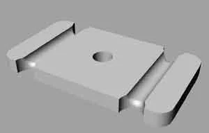

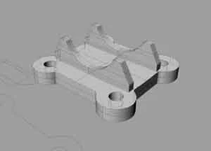

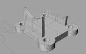

Drew up a front and rear set for CNC
Just need to convert to G code and cut em.
Shouldnt be much in material
Welcome to the 90's!

Sweet! Would you be willing to make a few more sets??
Cheers!
