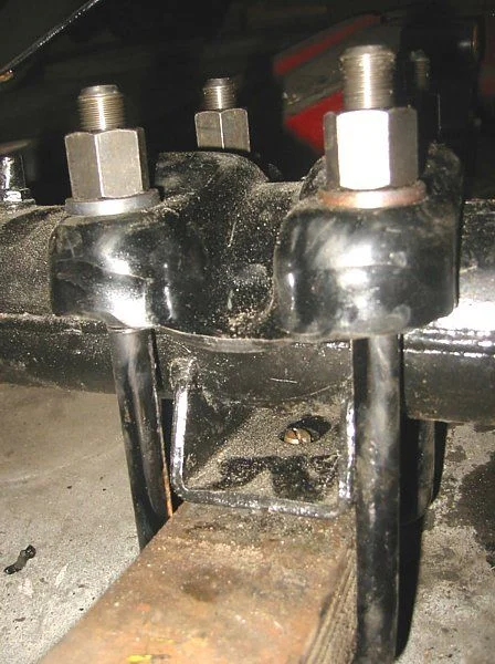

1973Guppie said:
so if I understand correctly, those ubolt plates from GM will bolt on perfectly to a pig axle? this would be great if so, any modifications needed, any idea if they will fit a 73 vintage?
Noah
Three will bolt directly on, one will need some modifcation (PS front). I need to make the bottom plates and have some ubolts bent. Should be pretty slick. Someone on Pirate posted a few pictures and the part numbers but never followed up. When I work on it I'll try and snap a few pictures.
The plates fit the housing curve perfectly on my '76 and the earlier axle (70-71) I sat them on.
Here is another picture from Pirate. You can see the one on the far right that was modified...
