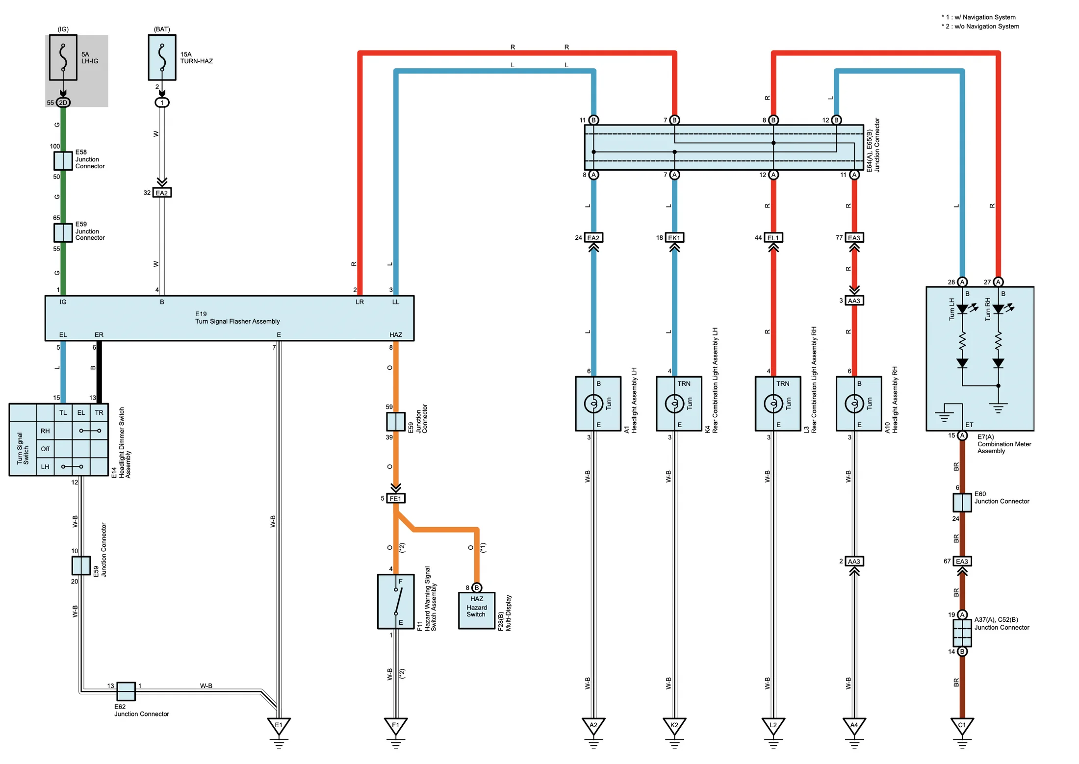

SmokingRocks hopelessly addicted to Cruisers 10 Year Joined Oct 6, 2014 Threads 116 Messages 4,111 Location Colorado Jan 6, 2025 #1 Can someone please post up the pages with the EWD for the turn signal circuit? 2008 LC I’ve been trying to download the master FSM file but keep having issues.
bloc SILVER Star 10 Year 15 Year Joined Sep 19, 2008 Threads 144 Messages 15,815 Location Central Texas Jan 6, 2025 #2
