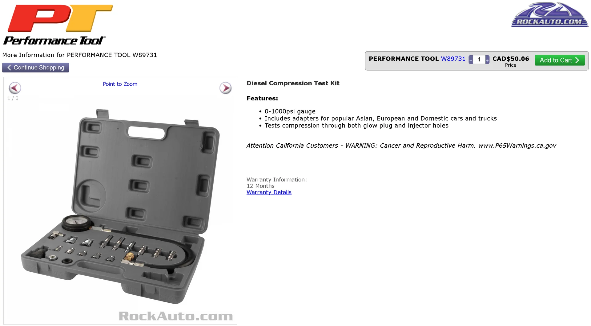

Yeah, I'll have to buy a test kit

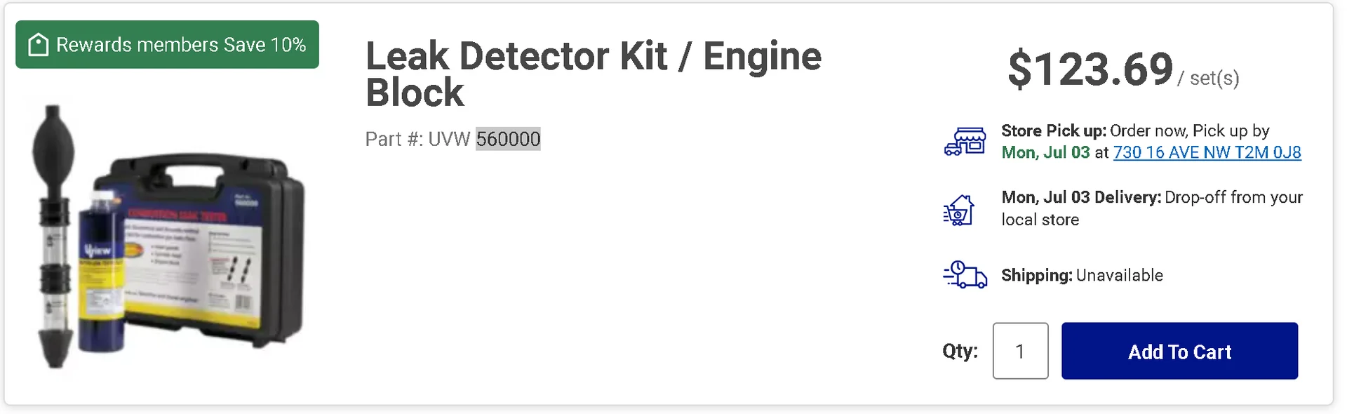

compression tester is nice also a blocktest kit would be helpfull
I used one these its a nice kit has the fittings for toyota
Thanks. I did order the identical compression test kit on Amazon. It will hopefully give me some answers. I'll see what the test says and then maybe I'll get the leak kit as well.
