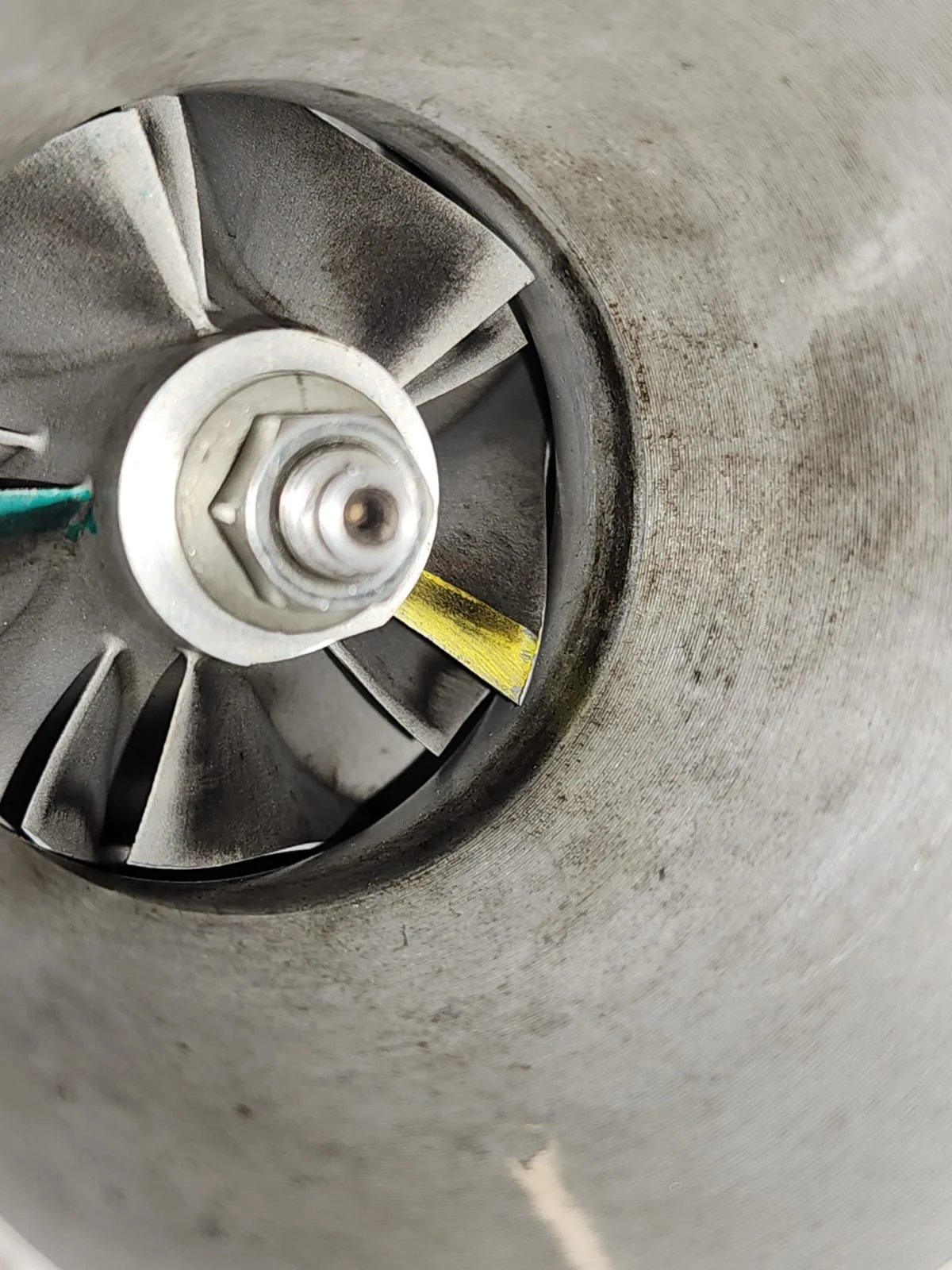

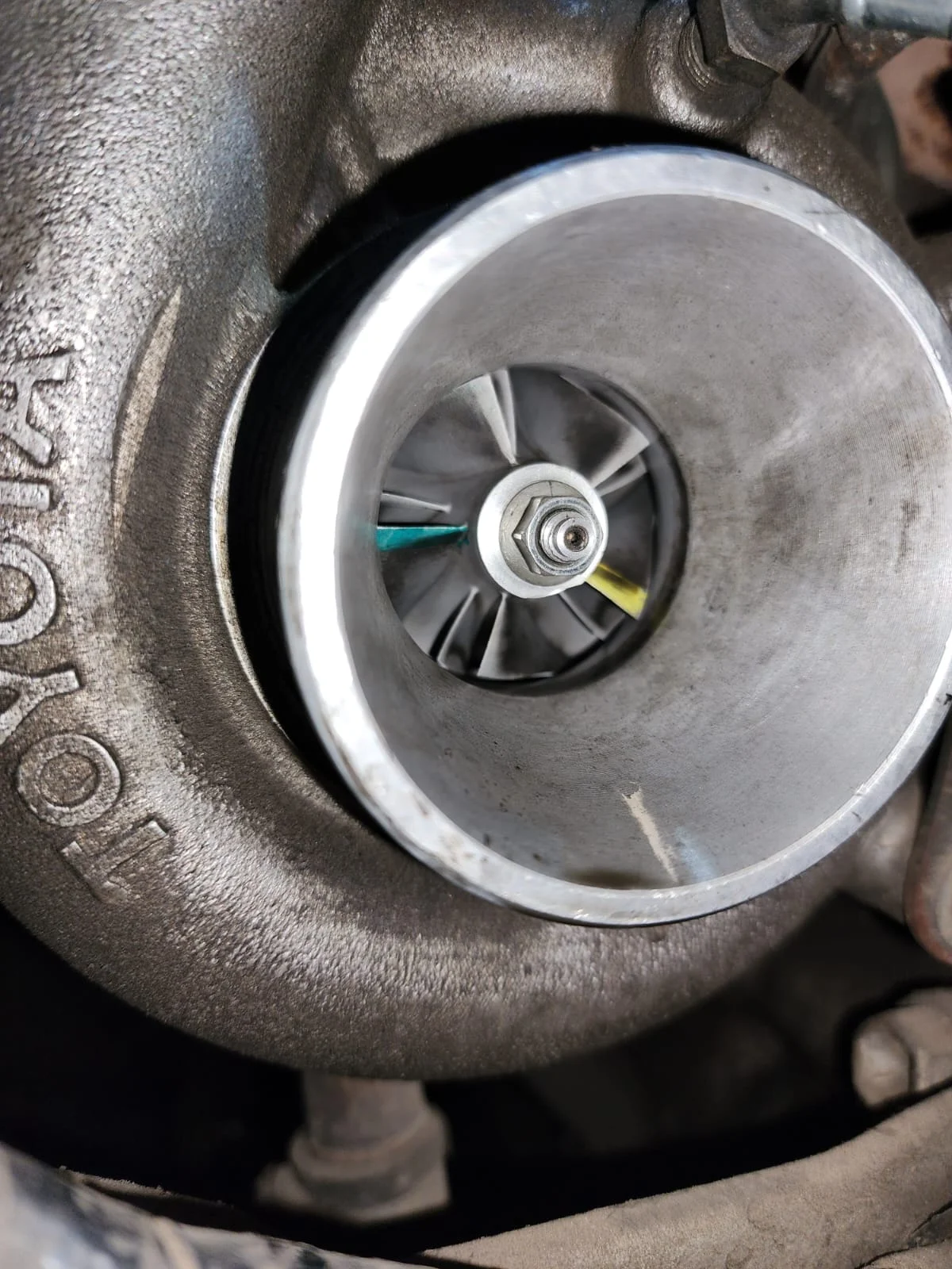

I did check for the shaft play. There no in-out play. Slight play from side-to-side. Doesn't seem excessive but I didnt measure nor am I an expert. Visually the compressor fins seemed fine and not touching the housing.

Compressor side :
