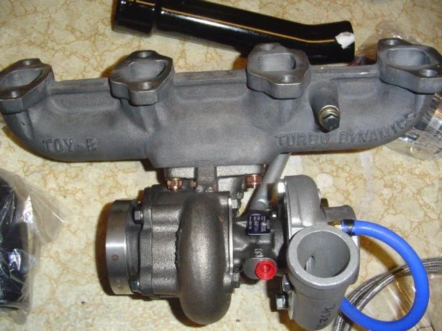

What do you think of this manifold?
turbo dynamics is the manifold used by safari in the past in their kits... i like it.
