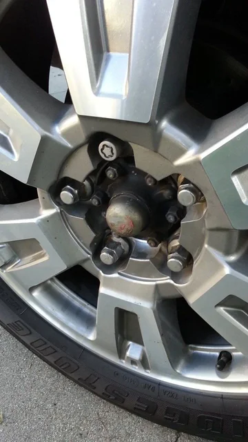

Has anyone solved the center cap issue, other than cutting a hole, for the Tundra platinum 20" wheels on a Cruiser? Found some take-offs super cheap and couldn't pass them up. But that darn grease cap is just a smidge too prominent on the front. Loving the ride of the Bridgestone's compared to my very expensive Michelin's.
Yah, seems like wheel spacers should do the trick - any reason they won't make the center caps fit on all the Tundra wheels?
Wheel spacers won't make it work? Let's see a pic!
I think wheel spacers would work, but I'm not keen on spacing out on relatively short lugs that far. Bigger, heavier tire\rim and increasing force seem risky to me. I'm not an engineer by any means, just looking for a simpler solution like finding out that a set of lexus caps work fine. I pulled the grease cap off and found that the center cap will snap in with about a 1/4 inch clearance from the bearing lock nut. The interior of the grease cap appears to be over a 1/2 inch from the end of the spindle so that would mean using at least 1/2 inch spacers.

You have to understand the OE lugs engage beyond the wheel so no worries on thread engagement.
Hey Bomar, I get the thread engagement now; I was trying to understand transferring the stress out further on to the stud. Read a bit more and realize the majority of the load is carried on the hub lip (vertical stress\weight) and that the stress on the stud is more more side-to-side. Forgive the highly technical terms here (I'm no engineer), but I get now that if the lugs have bite and the center of the wheel is seated on the hub, no worries. thanks for the thought!

The rear looks great and the duelers ride extremely wheel\quiet - much more so than I expected. The front grease cap is blocking the plastic fingers from snapping in to the rim - my halfarse measurements put it right at a 1/2 inch needed. 20160215_082712.webp 20160215_082658.webp
@buddysharp The solution is to flatten the grease cap some.
Swapping wheels: Center-cap fitment issue - Shorter Grease Cap?
Awesome Hoser! I wasn't bright enough to figure out how much space there was behind the grease cup although i do credit myself with getting a BFH and standing over the wheel for a few minutes. Wife came out and I lost my nerve. I did search the site and hadn't found that one so thanks for the tip! BFH engaged! Will post before and after pics as well as full body view as requested by yotasavg above.
