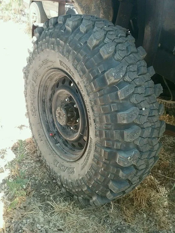

Thats a picture of my 72 with tundra steelies and 1.5" spacers. Works great and the wheels were free traded 5 fj cruiser 17" steelies for 6 of the tundra steelies.
Lol awesome. Thanks for the reply. Looks great btw
The tundra steelies are a little harder to find it seems after getting that set. The other option is to use the rims that come as the spares on tacomas and 4runners. The way to tell the difference is the rims that are used as spares have an oblong hole next to the valve stem and the rest of the holes are round. Not that it really makes a difference just something that I noticed comparing them.
Tundra silver steelies haven’t been in production for several years now and are getting harder to find but the tundra spare is the exact same wheel in black.
