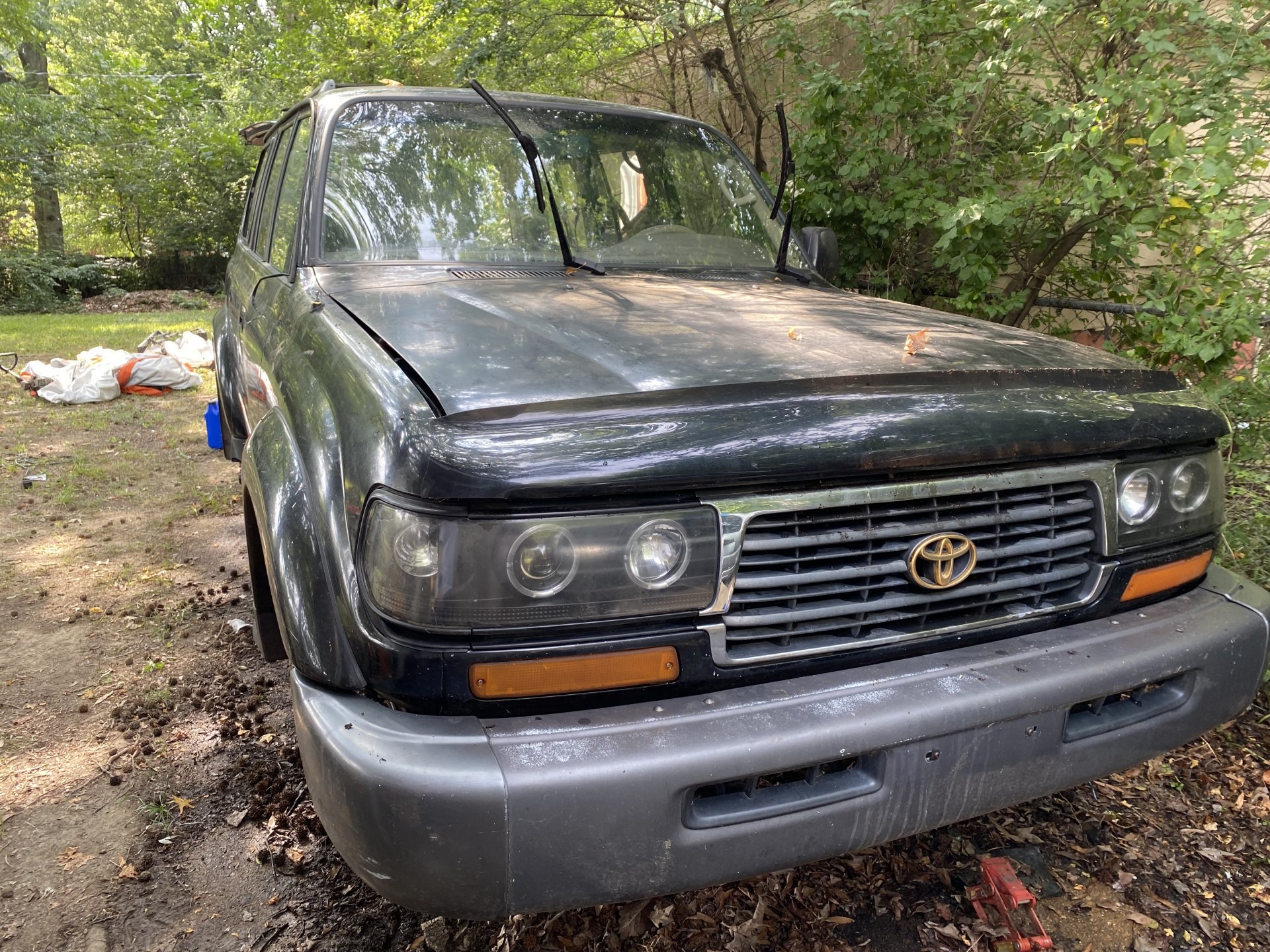

So here it goes...While scouring craigslist late at night trying to find something to waste my time and money on I came across an 80 series with a blown headgasket that appeared to be otherwise in decent shape. It got my attention, I called up the pimp who owned it and we met the next day.
Now, like any good brother he put his best merchandise in the front.
However, the real goods were in the back (underneath a tarp on jack stands in the yard). It was real piece of work that had been abused and neglected, but it called to me and I listened. Maybe it was the headlights or the sweet smell of an old midtown basement, all I knew was it needed to be saved.
