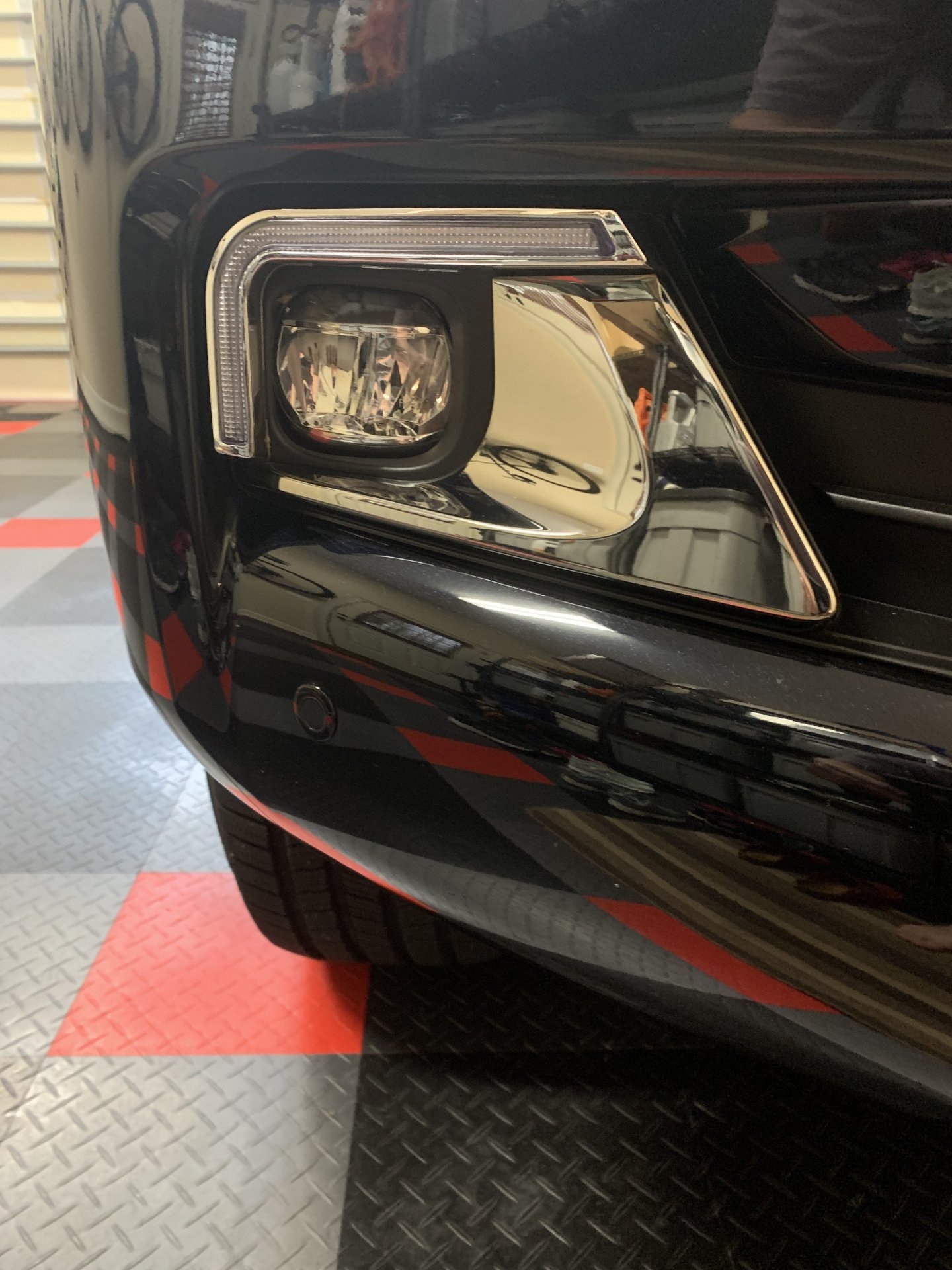

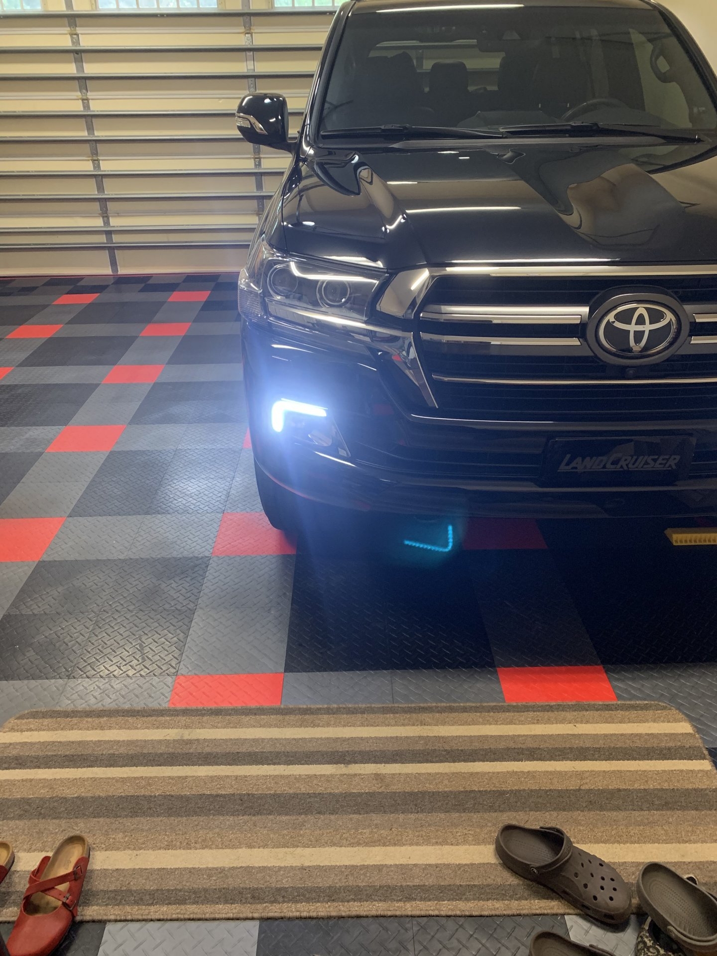

I assume you are trying to use fog lights as your DRL and want to control it independently of lights. A different approach but a very easy process. I have not done it for fog lights but for independent DRL that goes around fog lights. You just need to buy a relay kit and the install is like for any other off-road lights but instead connecting off road lights you connect your fogs. You will loose control of fogs in your light switch but will have an independent switch in one of the empty slots. Here are couple of pictures.
