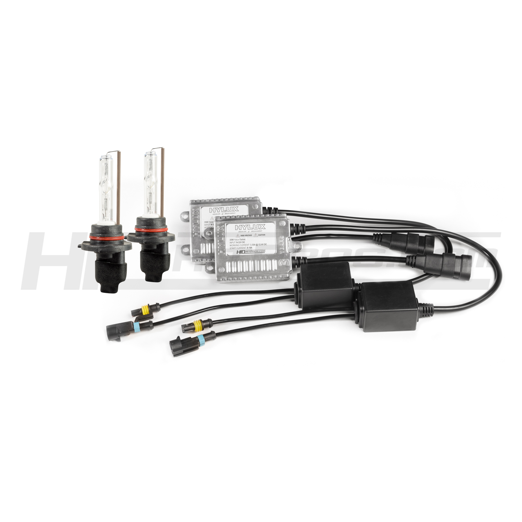

has anyone had experience with the product from HID Kit Pros?
thoughts?
