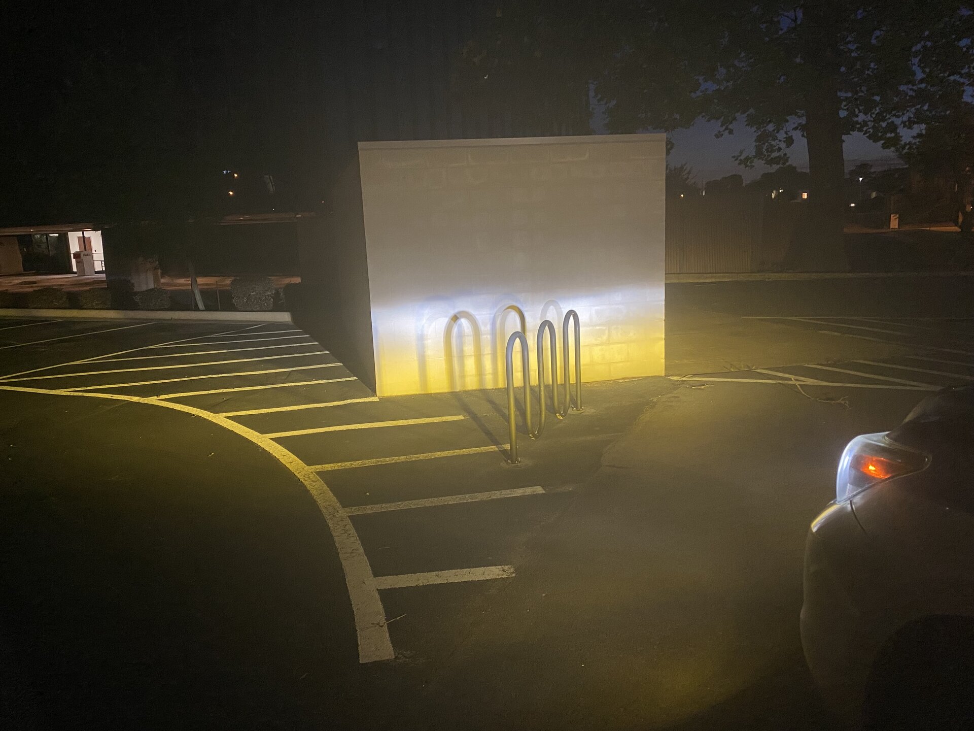

These are the DD SS3 Pros SAE Fog. Seems to have all the features you mentioned. I can’t imagine wanting them any brighter. And they have low flat cutoffs, as well as plenty of light to the left and right. Edit: I have Hikari LEDs in my OEM projectors For headlights.

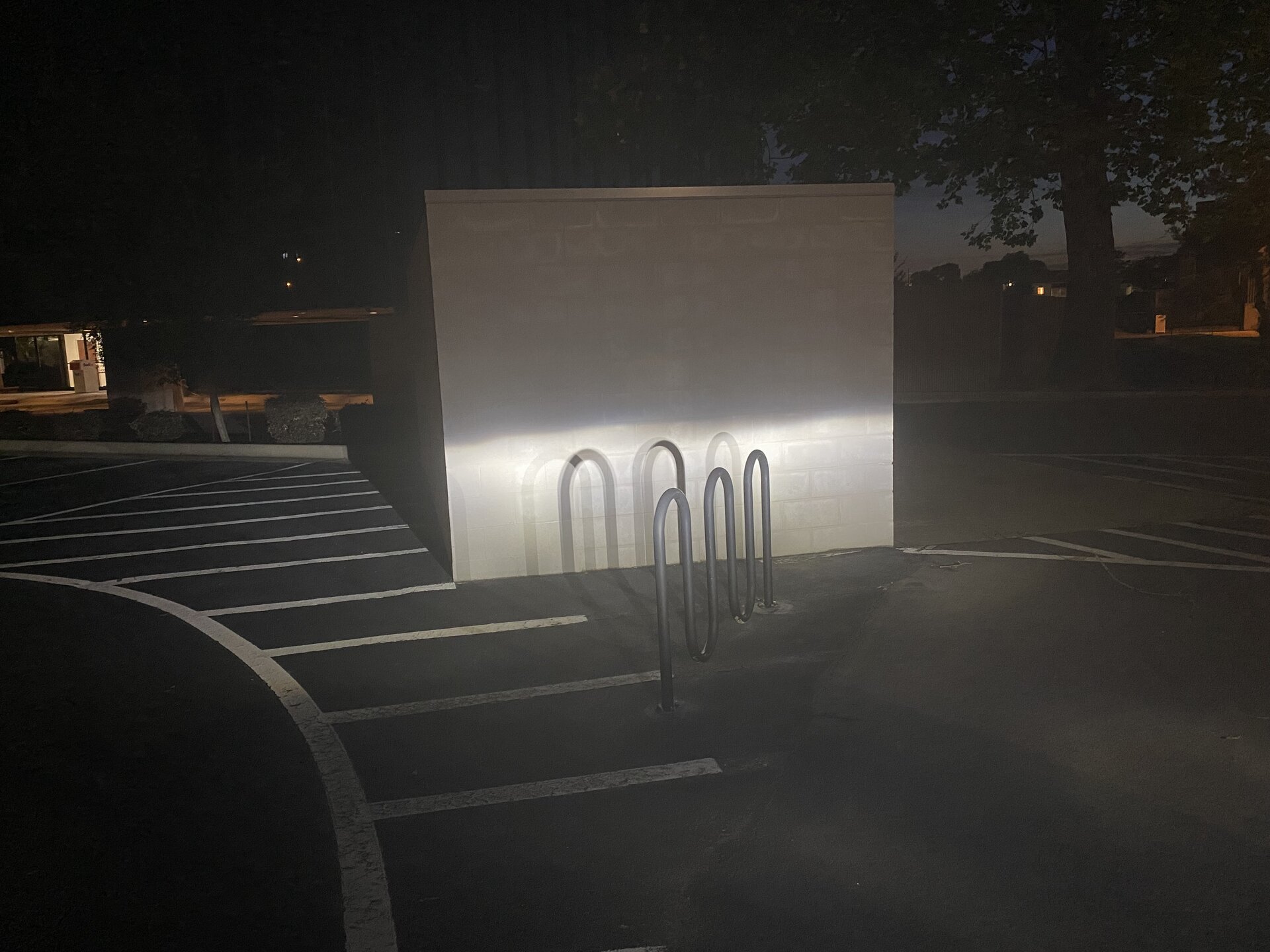

this pic is just the headlights, it shows how much wider the SS3 beam is. Notice the brick wall behind the target wall isn’t lit up by the headlights at all, but the fogs do light it up.

Good stuff, this is along the lines of what I’m looking for. And nice to know SAE doesn’t mean totally neutered light output.
