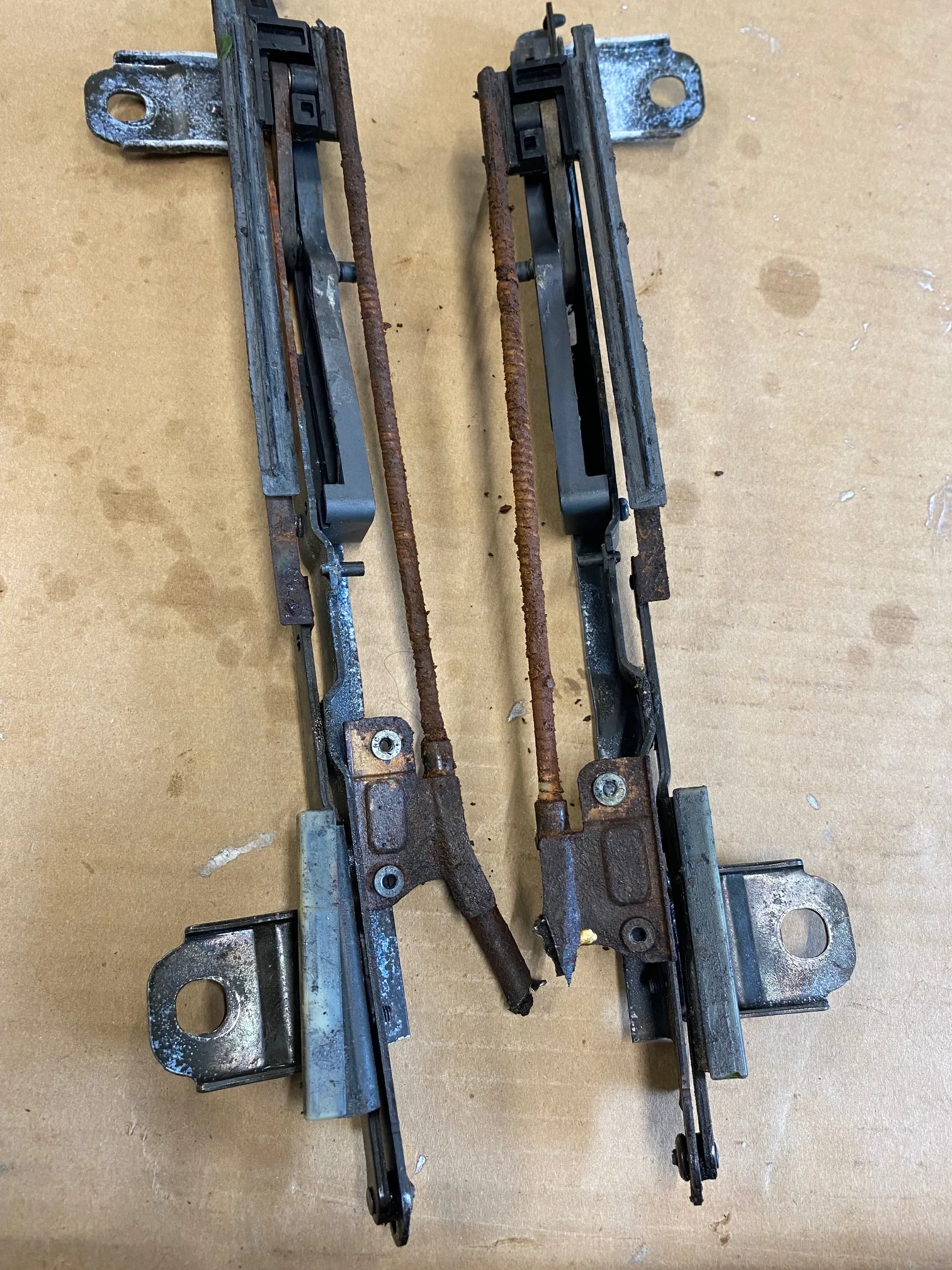

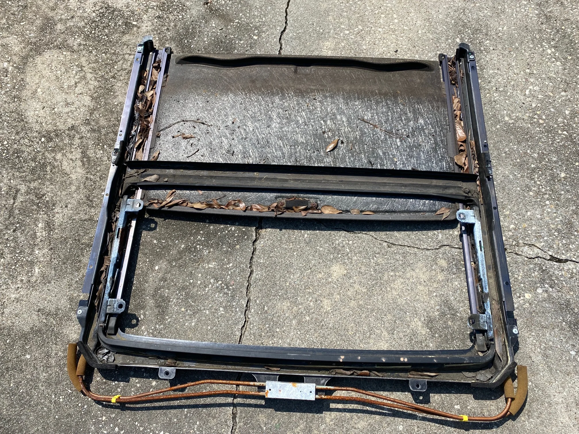

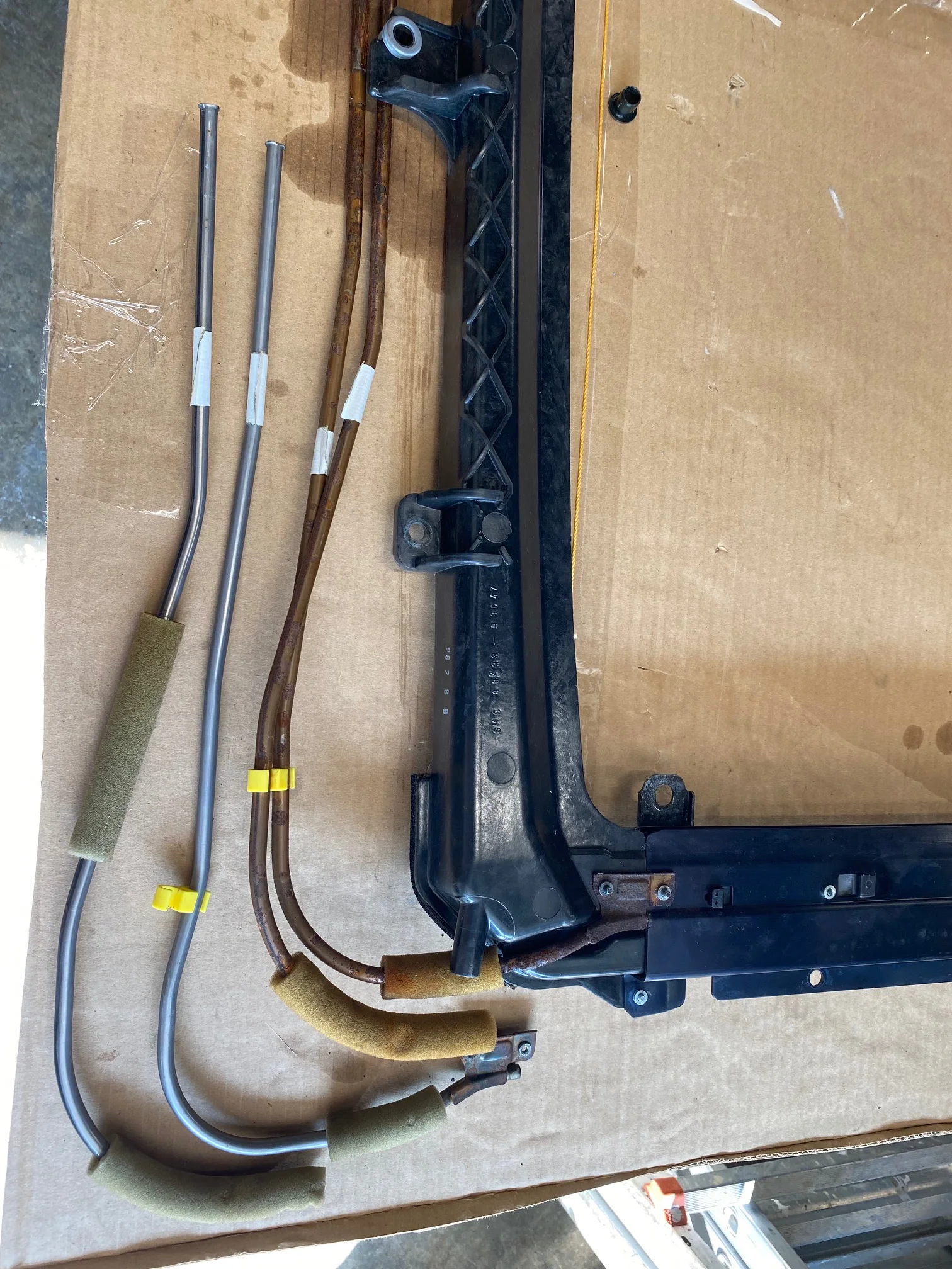

yes , its common. what probably happening is the cables are frozen with rust / debris . I rebuilt mine, and the parts are still available, well at least they were a year ago. Its a very labor intensive job because the headliner and sunroof assembly have to come down , but its not overly difficult.
Could be the seal sticking. Could be the cables. I recently replaced mine because the cables were worn out. Its a bear of a job, but doable.
My cables were not nearly that bad and yes, the parts were available a month ago.

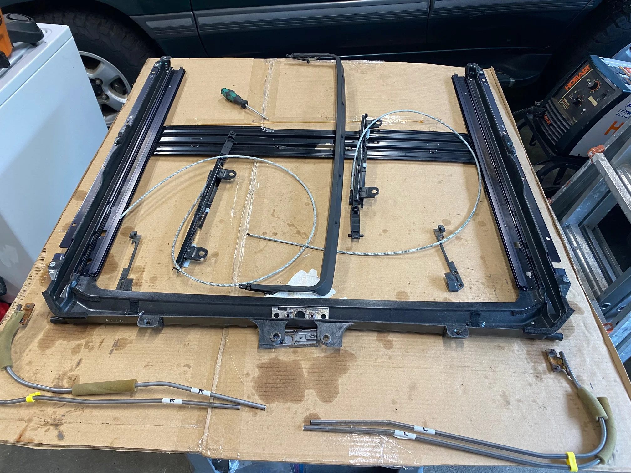

Mine was stuck when I got it and it was the cables as mentioned above. $564 and 6 hours later it works perfect. It's not that hard of a job but it's certainly a bit daunting to take out the entire headliner... Might be doable solo but I recommend having someone around to help when needed. Good luck!
