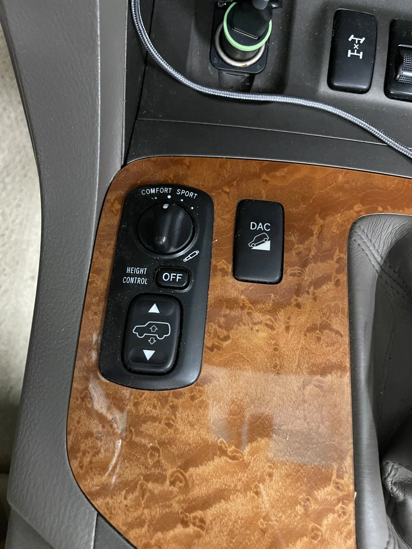

I knew that the rear ride height adjust wasn't working when I bought my GX, but yeseterday I noticed that the switches for ride height, DAC, and sport/comfort select don't seem to do anything. Is there some single point of failure for all those systems that could cause this? Is it time to pop off the center console?
Disregard! I got bored and decided to pull up the console around the shifter. The harness was unplugged! Plugged it back in, everything works fine. Good thing I demanded a discount for the non-operation rear ride height when I bought it. :)
