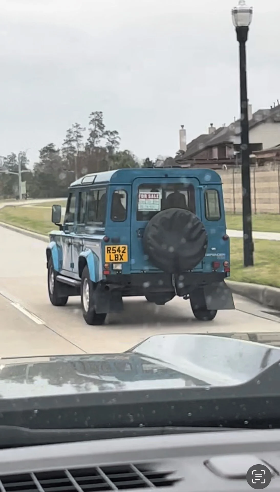

This was spotted in Houston by my brother a few weeks back.. Said he spoke to the guy who is British himself looking to start importing these. $64K....not cheap at all.
View attachment 3265714 View attachment 3265715
That is part of the lure of a Land Rover. Take a look at what is available on Ebay.uk. Over there it is a fairly normal vehicle and you don't pay the premium you do here. Fairly sure I can go over personally inspect/drive and buy a nice 98 or 99' and ship it back for less than $20k all in. They seem to sell for much more here. Troopy's, 80 series and even Prado's seem more expensive in Japan than Land Rovers do in the UK.
Think we are going to be a little bias on this forum 😁 Would also hate to try to repair cracked or folded weathered aluminium.

Regarding pricing, I don't doubt that price of $64,500 that @FJ73Texas posted above. That is insanity. All of my rich buddies want "a sweet old, classic Defender." None of them want a "sweet old, classic Land Cruiser diesel." I'm not sure why that is, but I guarantee you that is what is driving the prices. They want Defenders, not Land Cruisers. Probably because all their other rich buddies pull up in 2023 Defenders at the country club.

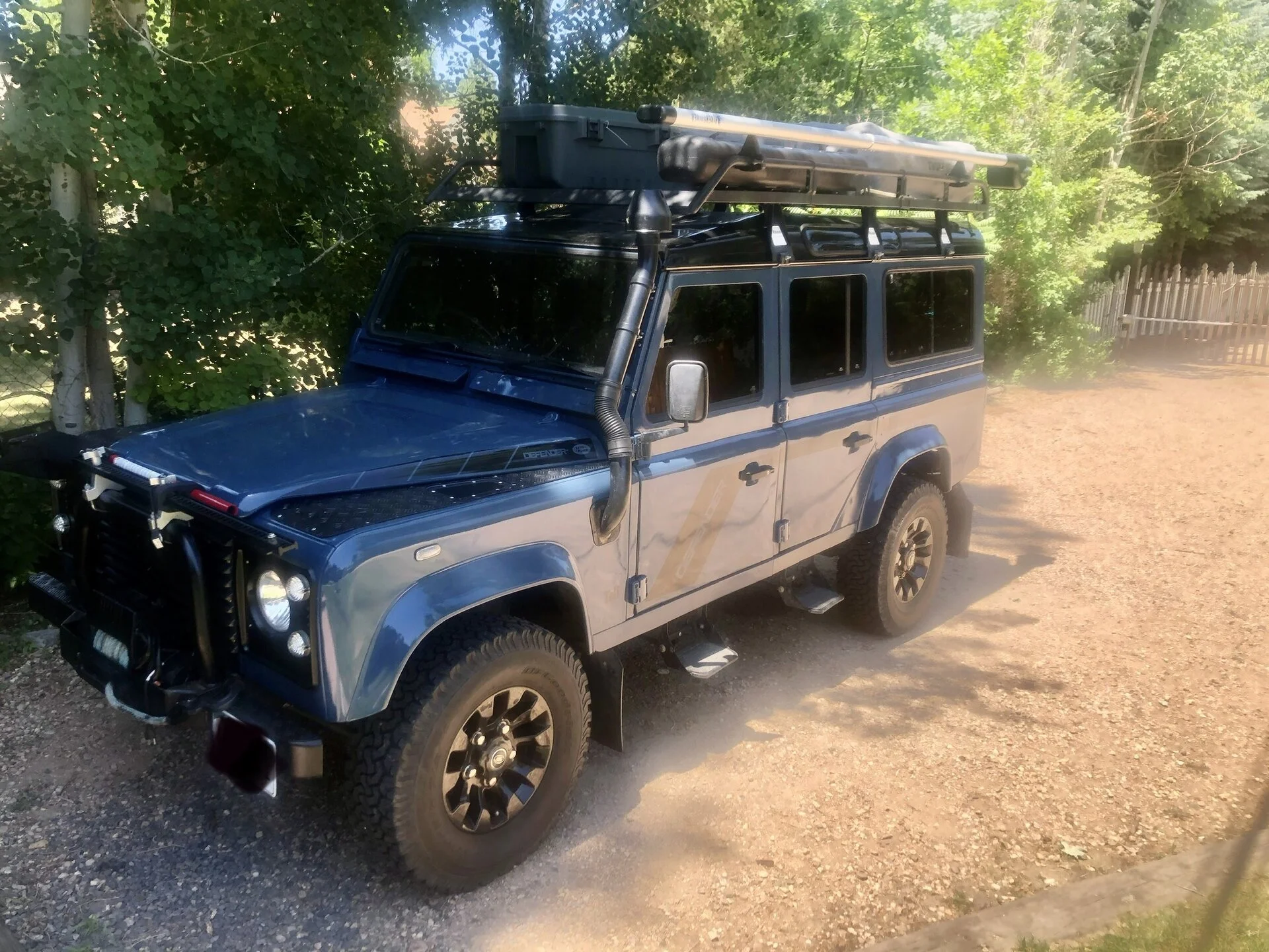

here is my friends rover, not sure what he could sell it for now. For a 96 it is definitely more tractor like than my 88. I do admit they look cool.
@robmobile73 i forgot he had to add a ROAMERDRIVE overdrive unit to make it bearable on the highway. $2500. Others have used different rover tcase gears with mixed results to get Revs/noise down.
A lot of 30yr old rigs need things to help with modern days. I know you are going through a lot to get your bj73 to modern speeds reliably, I’m not sure the same years on a rover get you anything ahead rather than space, and possibly further back in a lot of areas
I don't either given the part of Houston where he spotted it and just that it was in Houston overall.
I have only seen one British RHD spec Land Rover Defender in San Antonio and it was in one of the wealthiest areas of San Antonio where I spotted it.
