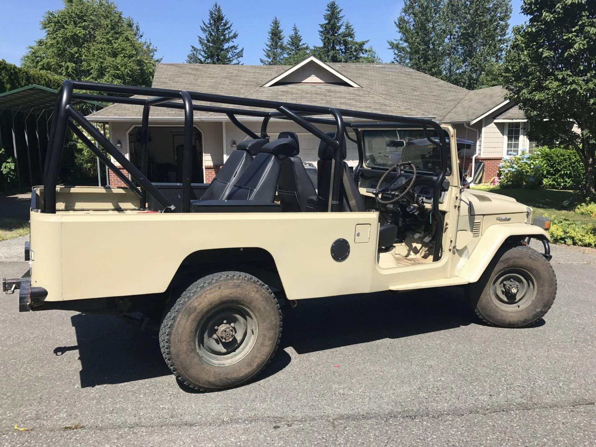

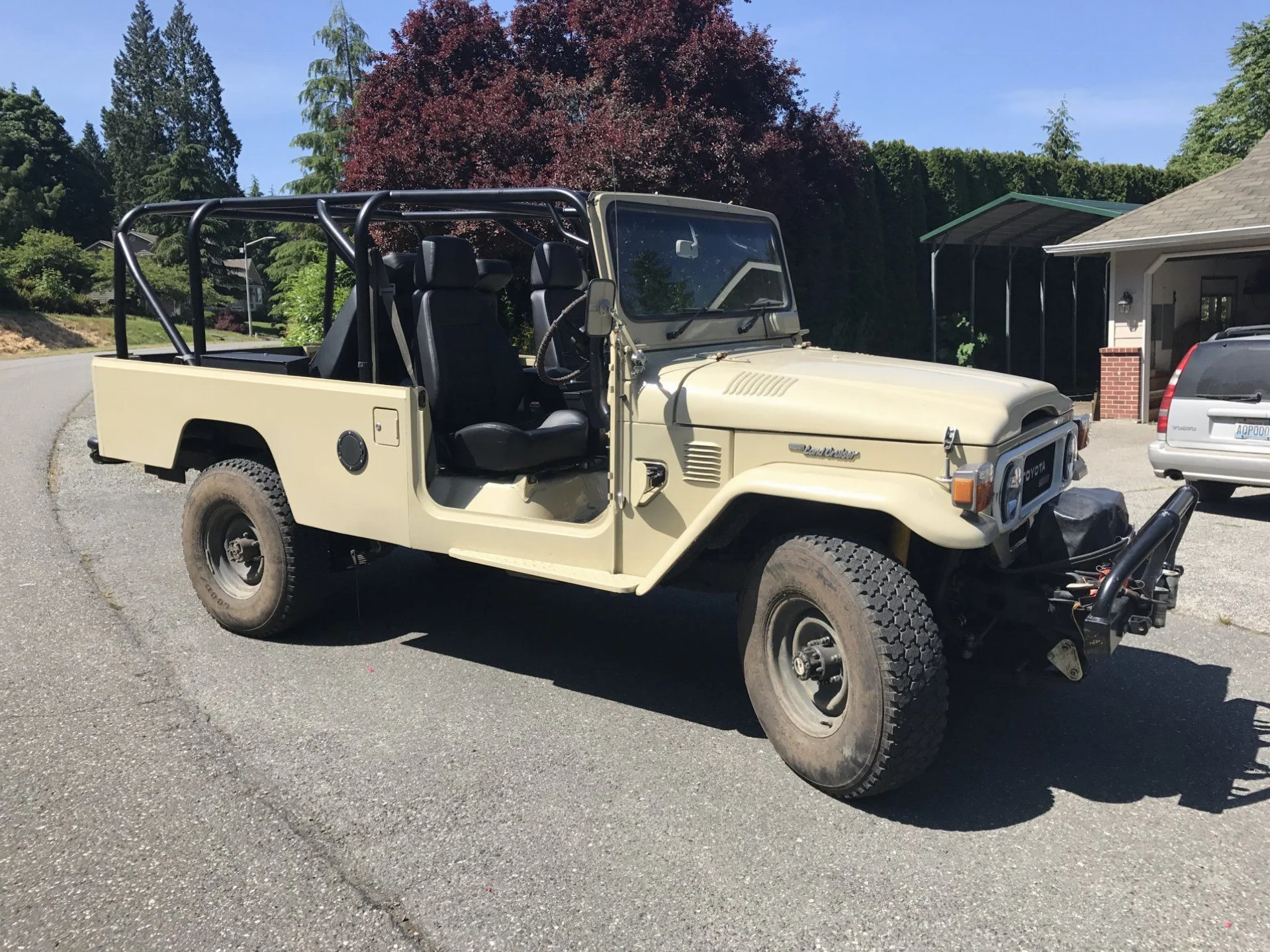

It's been a long time since sharing some photos. Kids, work, nuts. But last winter I spent some time with Tor at Torfab for some work planning on my troopy. The end result. Cant find a word to describe it !! New seats, power steering, custom roll cage, custom seat mounts. Man with the top off i cant see how i'll ever want to put it back on.
Huge shout out to Tor, amazing work, great bunch of guys. Enjoy the pics. Oh one word of advice, get an appraisal of your rig so your insurance covers the correct value.

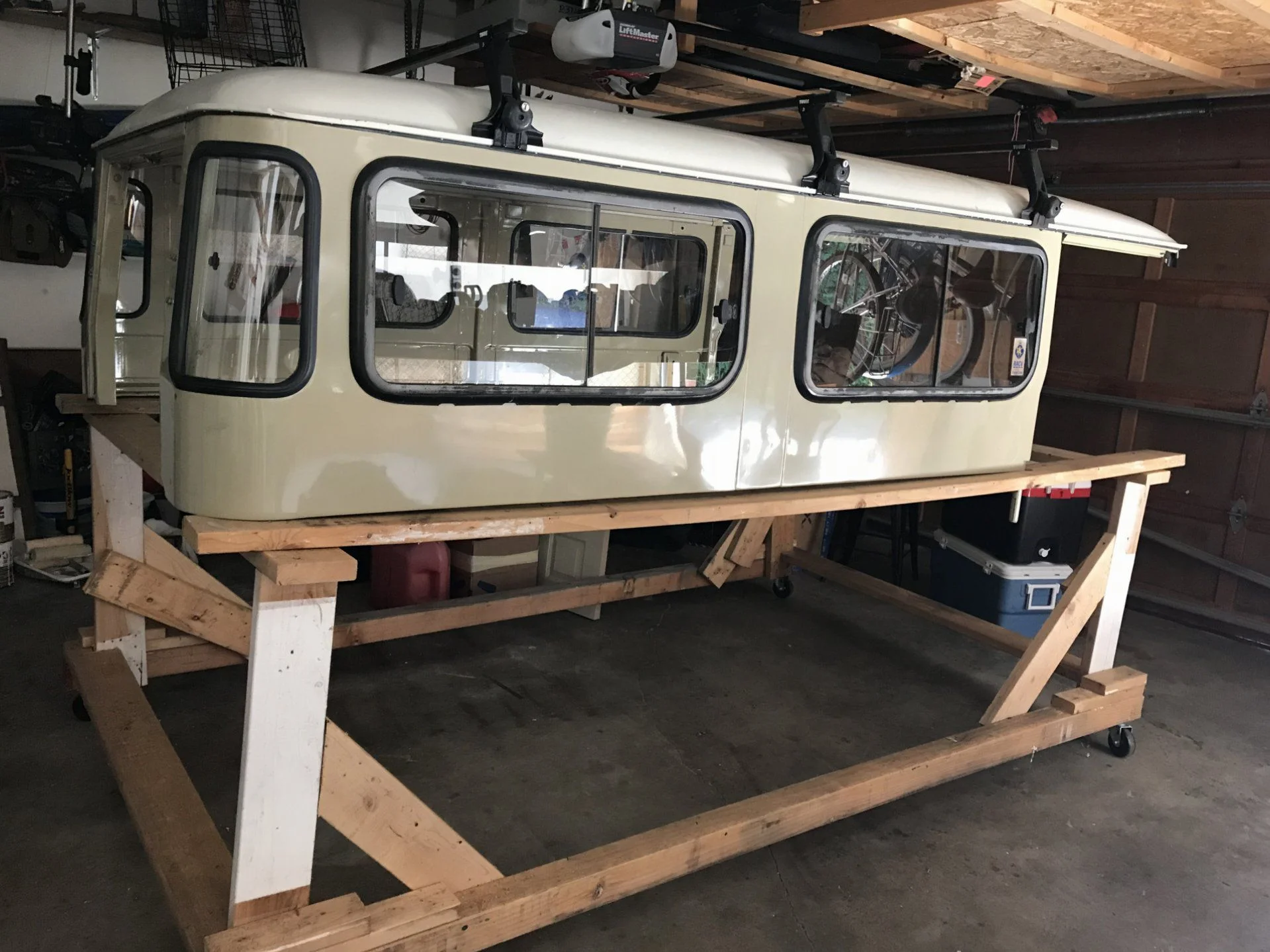

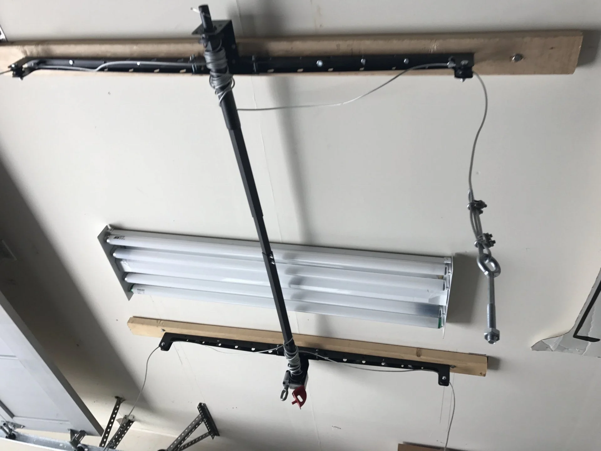

BTW that Raycor 250 lb storage lilt worked great for the top. Used 4.5 inch 3/8 lag bolts all over and some extra's instead of the smaller ones that came with it. Used some 2/6's under all three thule rail mounts. Pulled up great, no cracks, sounds. It was solid. You do have to make sure the cable doesn't get all birds nested as you crank it up. Any ?'s let me know.
