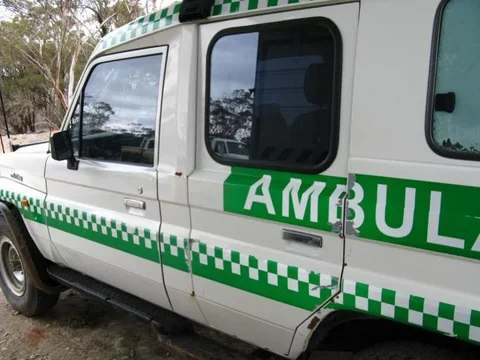

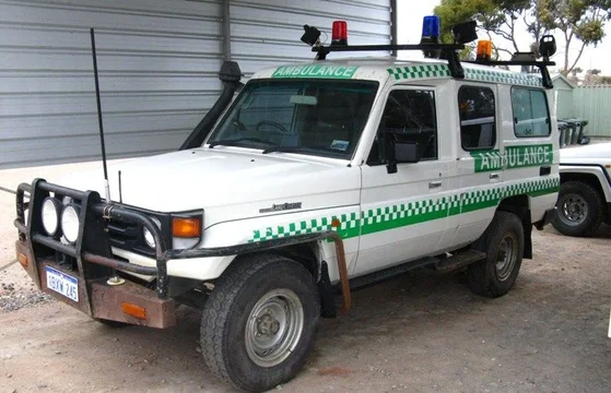

lomusass, great work as usual. Is it possible to add a rear passenger doors to a Troopy? I always wondered if it would be possible to do something like an LV for access to the rear seats. I have never seen the insides of a Troopy or how they are built so not sure if it could be done, but I know you would.

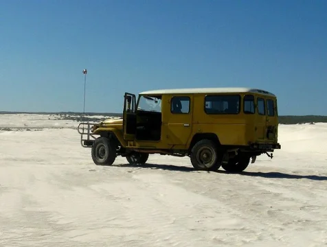

I have on HJ47 with an extra side door on the passenger side. I'll post some pics soon ... been meaning to for a while. Mine is the only 45/47 series troopy that I've seen with the extra side door, but there's a few 70 series troopies with extra side doors used for ambulance vehicles at mine sites here in Australia. Here's one which is right outside my door at the moment (I'm currently out at work):
I managed to find a photo of my troopy with extra side door ... sorry the photo is not that great, I'll take a few more when I get back home:
Cheers,
Matt
