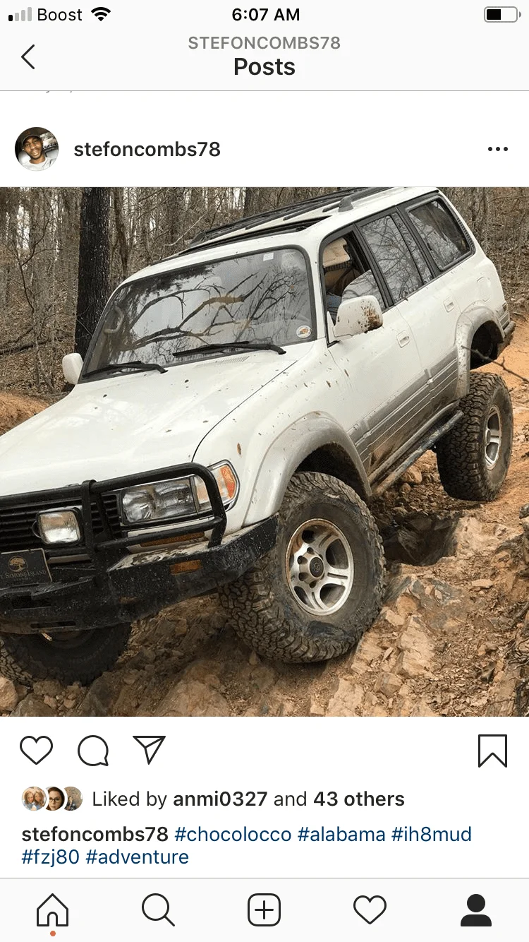

Don’t get caught up in the trends OP.. buy the cleanest example you can afford and add as you go. I did all of Chocolocco in an open diff 80, choosing your line and using the brake/gas method help.. and once you figure out you need one buy a cheap Aussie locker, that’ll take you just about anywhere
