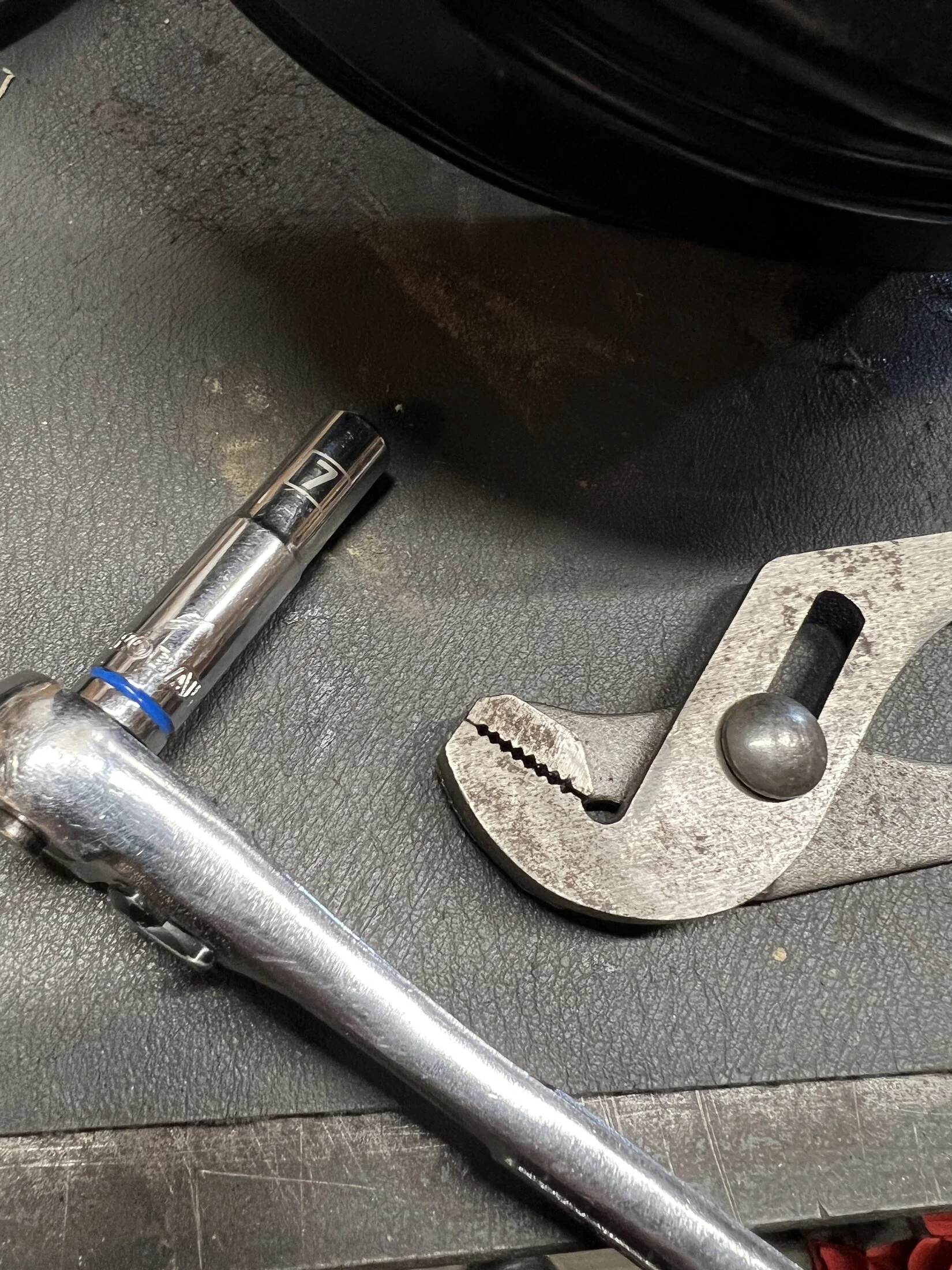

How do you counterhold and turn this to adjust the length?
I tried using needle nose pliers, but it the rod just slips and rotates, not the nut.
I need to adjust it out a hair:
I'd say delete this, but it might help someone else.
7mm deep 1/4" drive socket and small water pump pliers worked.
