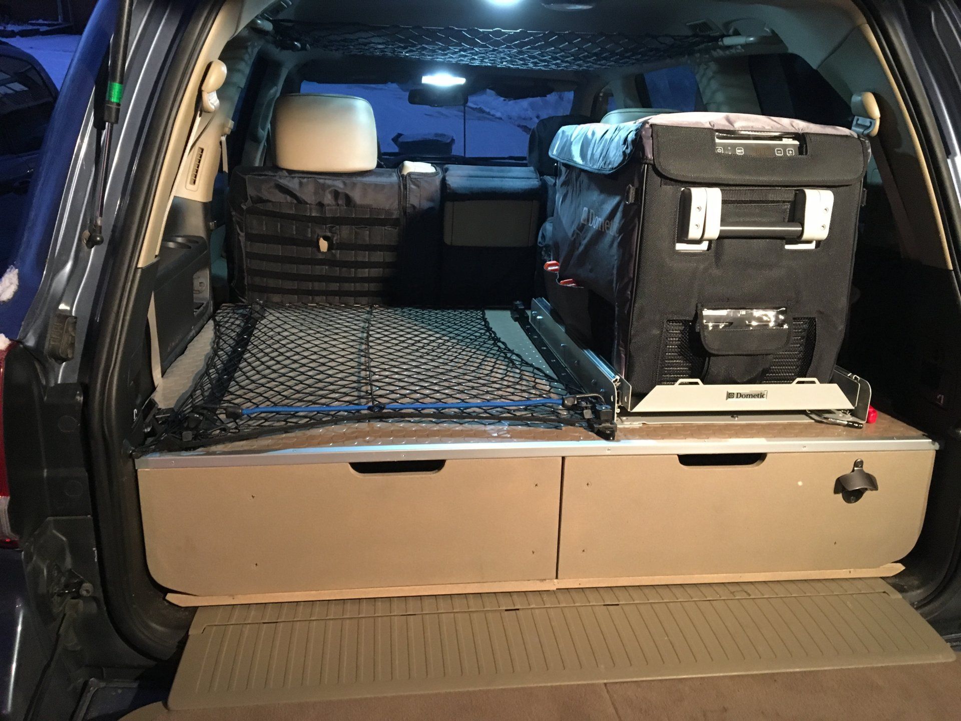

I just finished modifying 100 series KISS drawers to fit in my 200. The rear plastic is maybe 1/2" narrower in the 200 and I had to trim a bit. Created a thread with lots of pictures here: 200 KISS drawers
Subwoofer and jack access are on the passenger side in the 200, driver's side has a factory inverter on the side.
On the fridge side of things, I actually went with a 40l fridge in my 200. Thoughts behind this is I already have a mini-fridge in the front console so I downsized a bit in the rear. Went with a Dometic CFX40

Good info, thanks. I'm sure the trim pieces will have to be customized, I just hope the main box won't have to shrink.
