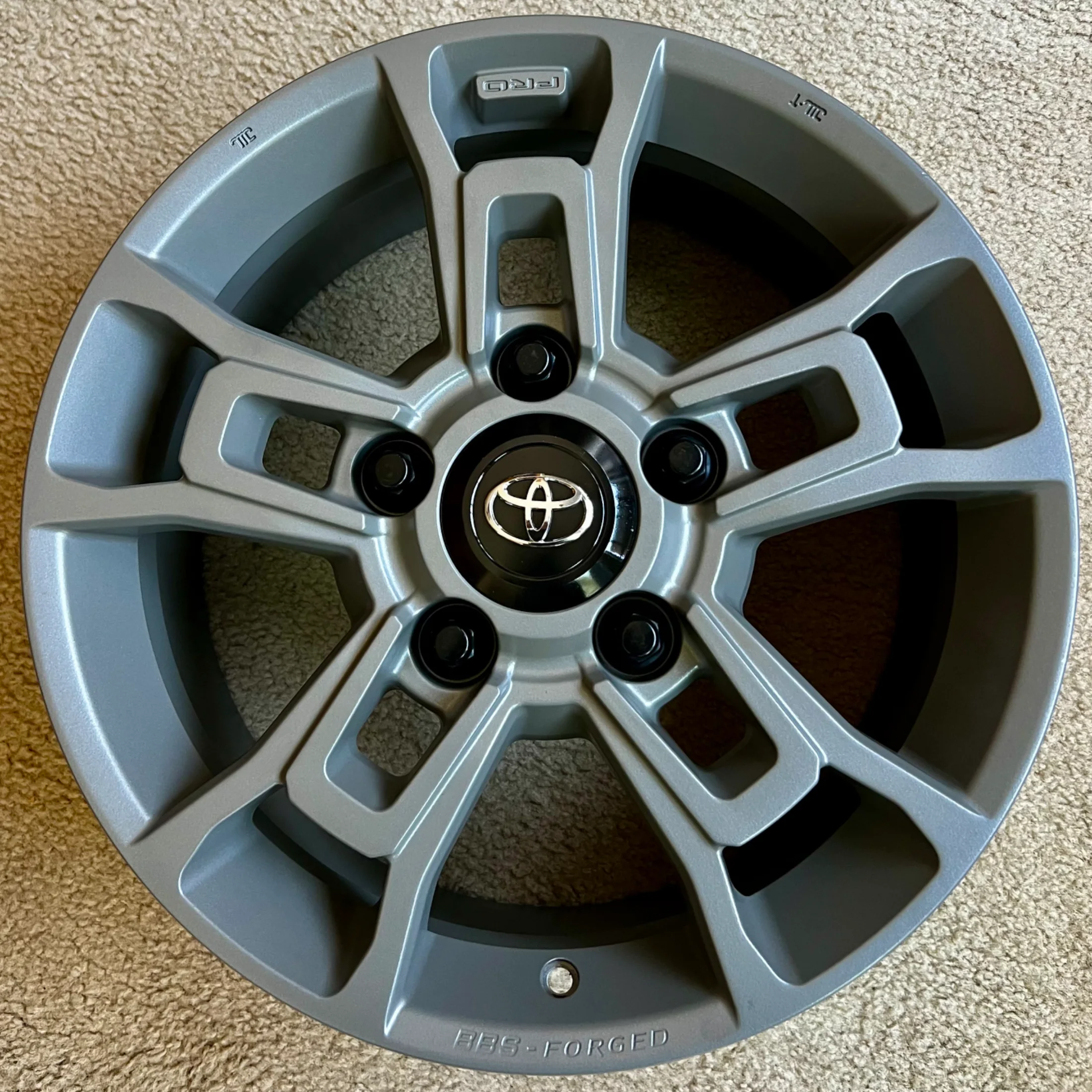

I have these wheels, and went with Powdercoat.
However, you need to talk to local powdercoater to make sure they are familiar with the process of powdercoating FORGED wheels (lower temp, longer time).
I am lucky as i live 10 mins away from a guy here that does most of the baja racers forged wheels, so i was comfortable with his process
"Standard" powdercoating temps may alter the metalurgy of the wheels.

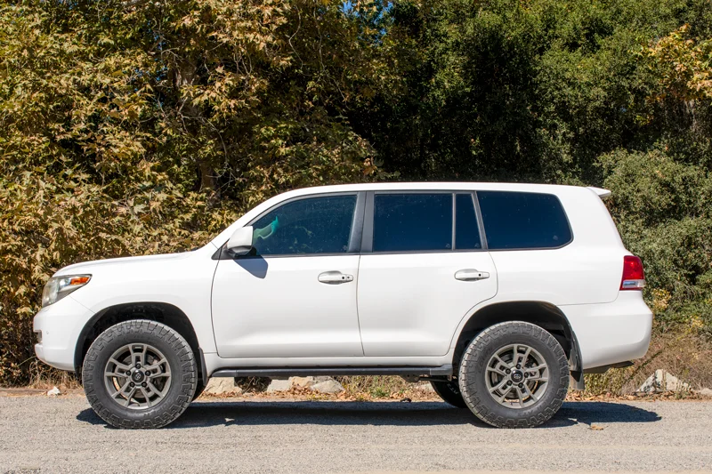

Here’s mine…. Love excuses to post pics 😂
Yeah man, that's the ticket! Looks great. Just need to track down some wheels to refinish!

These look so good!
What color powder coat? Do you recall the cost?

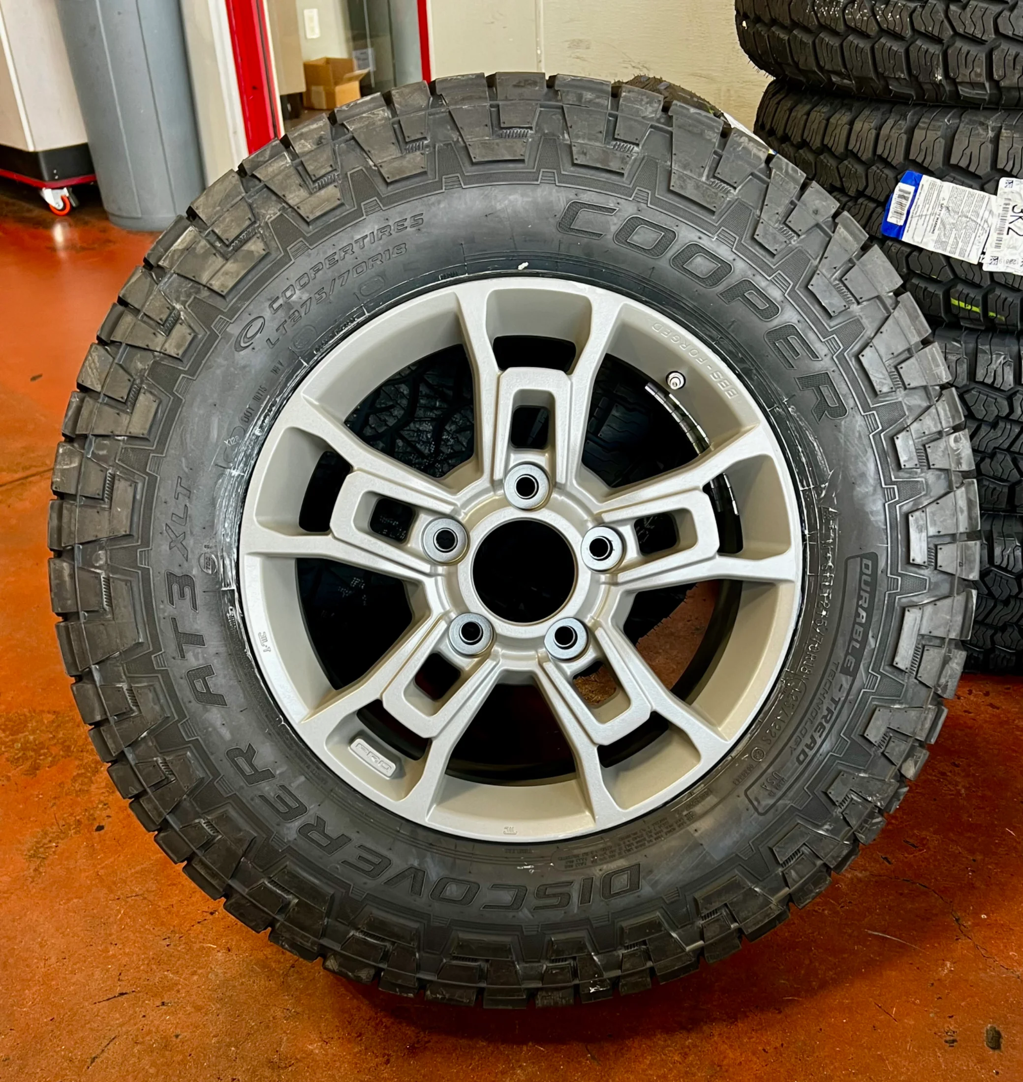

Ironically I have the exact same same tires. Very impressed with the Coopers.

Honestly, not even sure the name of the color. Just looked at their swatches and picked the gray matte metallic one. It’s Prismatic brand powder though. That much I know. Much better UV resistance than most
