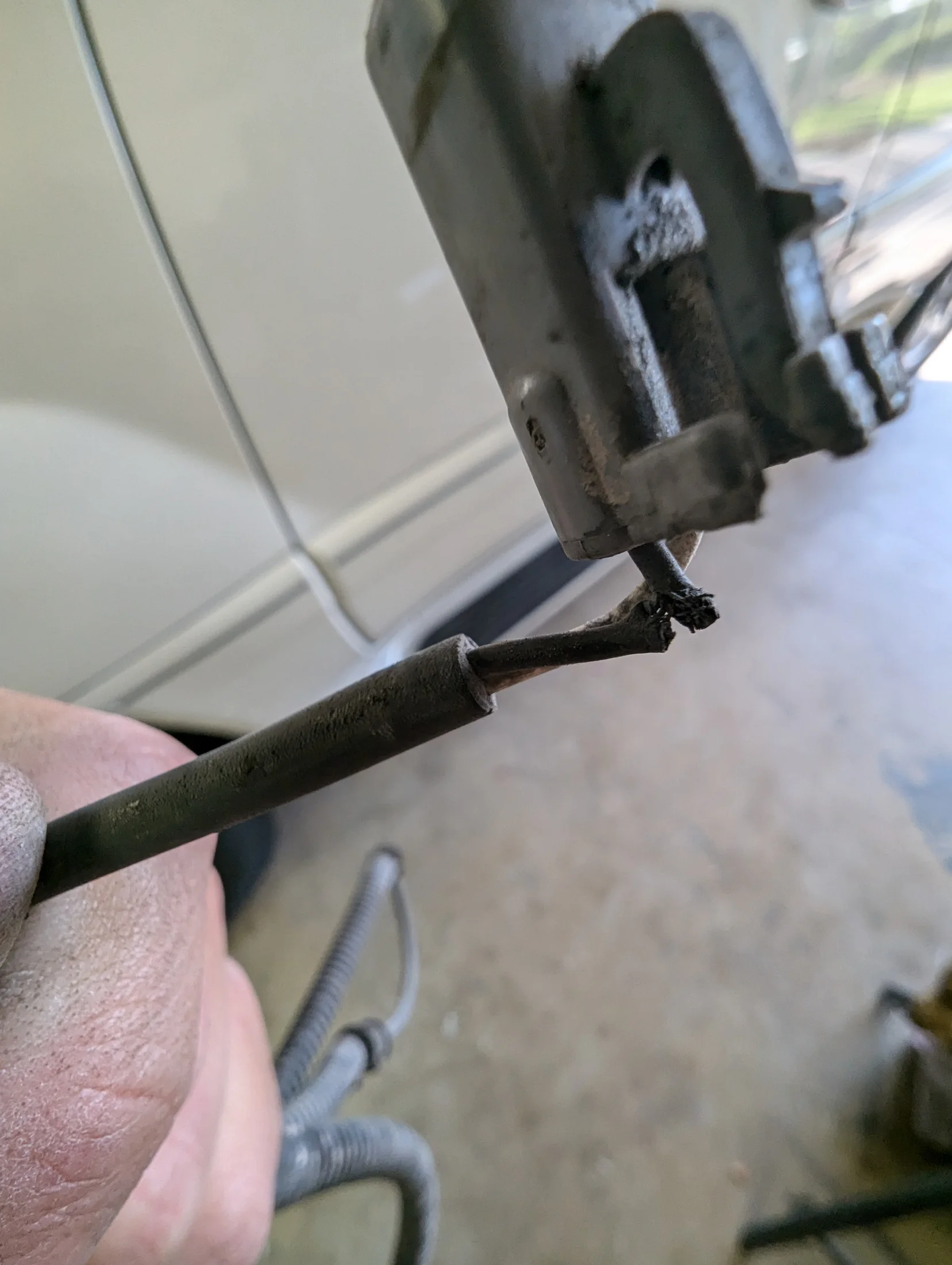

Have you checked your wheel speed sensors? This happened to me, except I did not get a CEL or any other light. One of the wheel speed sensors was barely hanging on by 1 strand of wire

I saw your write up regarding the similar issue (thanks for posting!!), I unplugged both front ABS sensors and it did not seem to fix the issue (despite all of the ABS, VSC, Brake lights coming on) I was able to limp the car another ~400 miles closer to my destination and will try unplugging the rear sensors tomorrow to see if that makes a difference.

You may want to check at the connection point and inspect wires up to connecting point and check/measure resistance. Not sure if you have tech stream, but (with a friend) you could run tech stream while driving and check to see if sensors are all reading properly as well as check the sensors on side of transmission that also measure transmission revolution. Techstream could also read any potential abs codes to narrow down issue.
