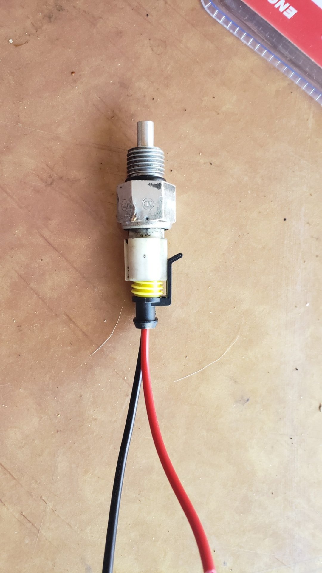

Oh the things you find!! Cleaned truck, probably hit the wire and it threw the code this AM when driving. Ordered new sensor for $55 but when I got under the truck I see that the PO had it messed with. The harness was not correct, they made something work and it is junk. If anyone has the part number that would be great! I am going to check around. Will LUK whats up!
SOLVED and works perfectly!
Solution:
1. I found I had these in my Jeep kit: (Amazon product ASIN B01A6LTK44). I used the male-end two-pin connector and it fit perfectly.
2. I used this liquid tape (4 Oz. Liquid Tape - Electrical - https://www.harborfreight.com/4-fl-oz-liquid-electrical-tape-36821.html?_br_psugg_q=liquid+tape) from harbor freight before I slid them together to add some extra waterproofing.
3. After it was together I added more liquid tape to seal it up good. It'll come off easy if I ever have to switch out the sensor.
4. On the wire end, I crimped each wire to the male end and used shrink tubing to seal that junction. Then I wrapped that with electrical tape and then liquid taped it to make sure it will last another 25 years! :)
Here are some pics ... and yes I am sure there are other ways to do it. I have other ideas now but this definitely worked!
