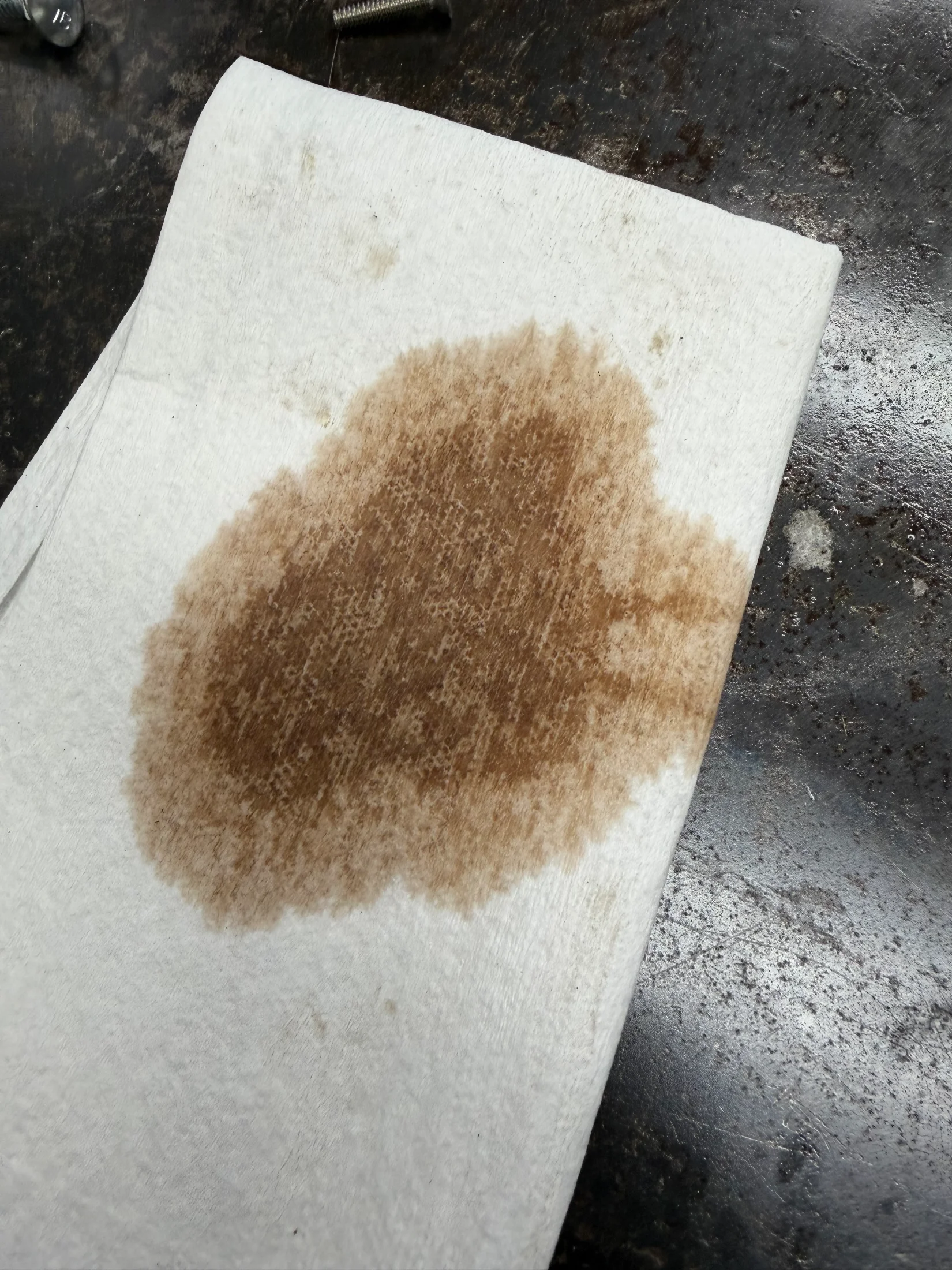

If you’re dead set on getting your transmission fluid red, you can jump some drain and fills and simply disconnect at the transmission cooler feed line.
After seeing my fluid, I’m not dead set as when I first started this. I thought about you’re method but at this point I think incremental improvement is the goal as long as it doesn’t create issues.
Gotcha. The point of issue creation (hopefully not) may be tough to find before you actually experience any potential issues. Regardless, post what you do and how it goes.

Drain and fill #3 227300 miles. A little better each time. So far no issues. I’ll just keep at it a little at a time.
