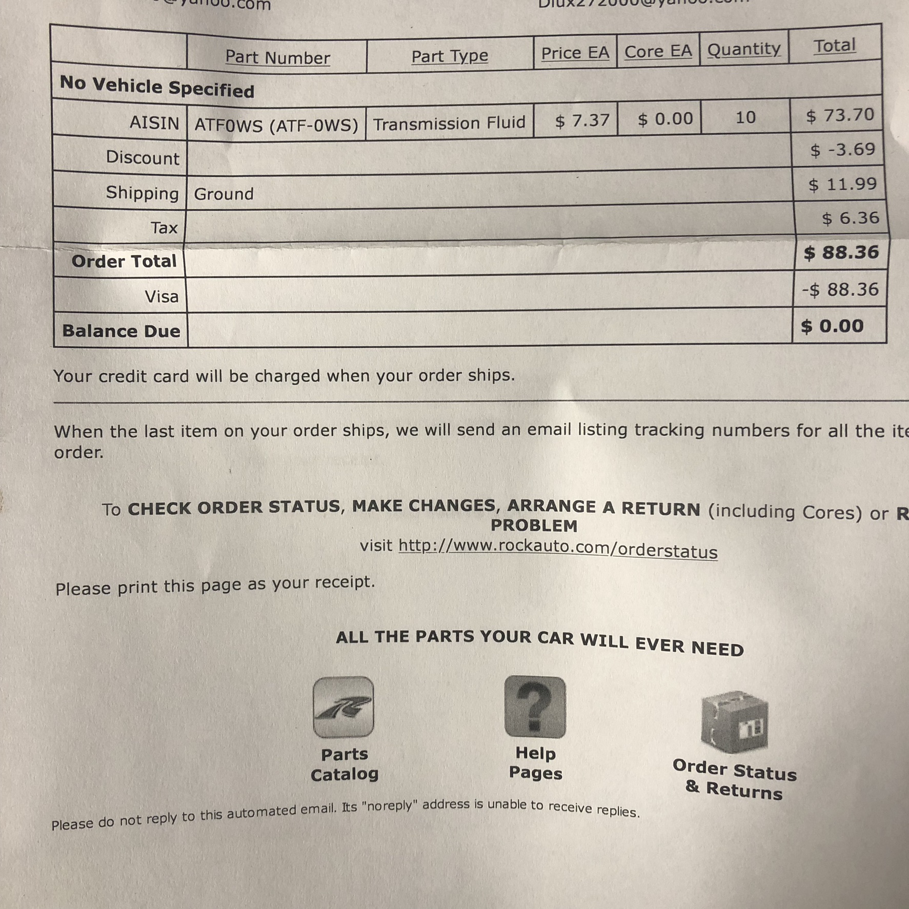

Aisin Built the Tranny in our 05 GX so I ordered up 10 Qts Aisin WS ($90 Rock Auto) and did the Drain and Fill Method and all Seems well.
** Sams Club Sells a 6 Qt 2 Pack of Food Containers for $15 that are Perfect to measure the Removed Fluid. Wish I knew about it sooner.
My 80 Gets Valvoline Max Life by same Method.
