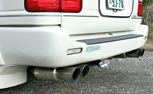

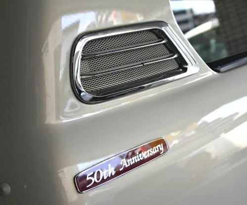

Dual Exhaust, Quad Tips. Yeah Baby. All that on a 50th Anniversary Cruiser.
