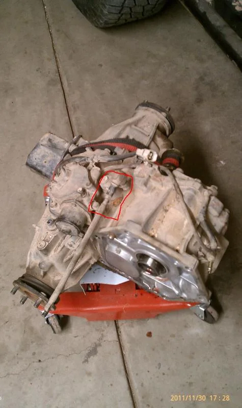

The pic below should be your transfer linkage for a 91 FJ80. Check for play in the linkage. Cleaning and regreasing the linkage joints/pivot would probably help as well.

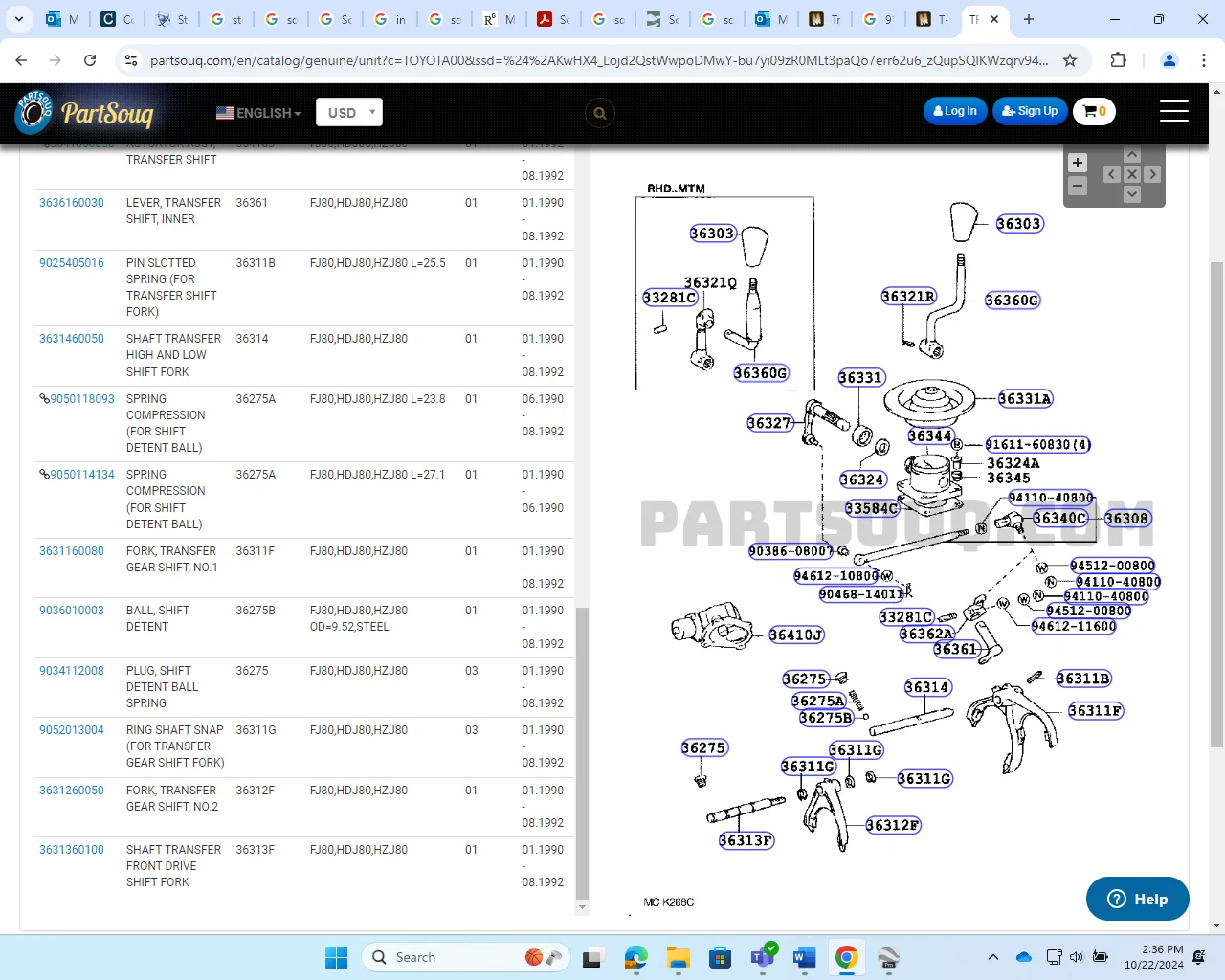

Here are some hints:

The shift Fork mechanism internal to the transfer case has a spring loaded detent ball that is supposed to keep the shift fork in place in all three positions. With the linkage removed, you should be able to easily feel the detents as you move the lever on the case manually. Each position should snap into place.
