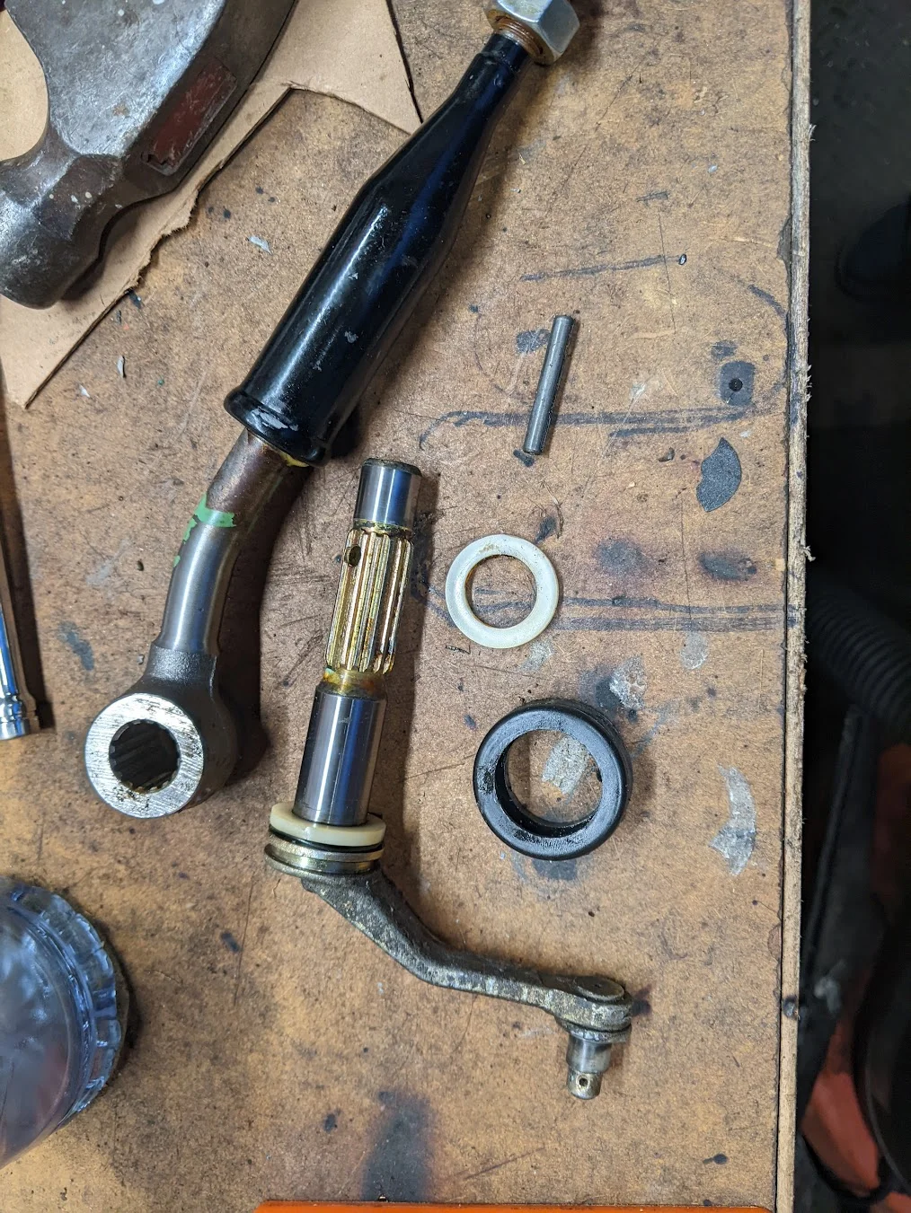

Easy to take apart, clean and regrease. This is an early style that I used for my LS swap. It was frozen solid when I got it, and now shifts smoothly and easily.
