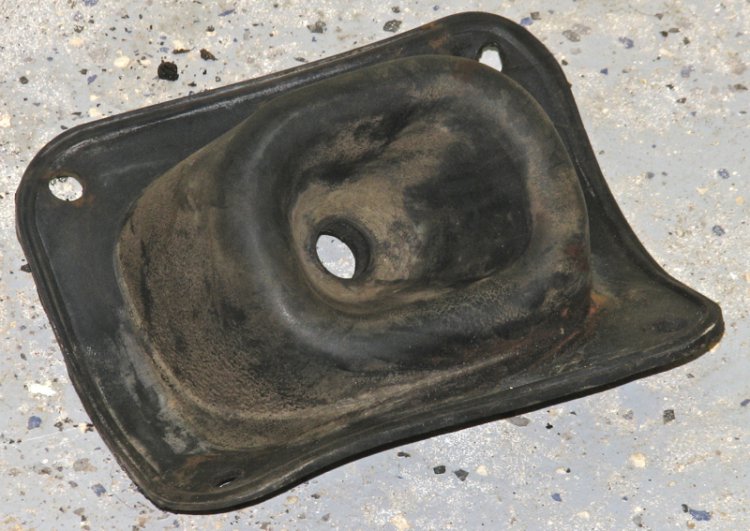

If anyone's interested I found another similar replacement. Metro RP33S. $15 from Rock Auto. My boot was completely shot with no hope for repair, and I didn't feel like spending $100 for a used one.
Needs a bit of trimming and drilling, but works pretty good. The base is rubber coated metal, but is easily bent by hand to conform to the shape of the floor
If you notice it's turned inside out because it works better that way due to the way the pleats are constructed and the travel of the lever. It would also work pointed downward, but I was worried about it getting snagged or rubbing on the shift bracket. It still fits into the outer boot this way.

Is there any particular reason why you installed it upside down and not as designed? Will it not fit under the shift boot?
I tried a few different ways (up, down, inside and out), but this way seemed to work the best with the least amount of resistance. The travel of the shifter lever comes close to the edge of the tunnel cutout in 4wd, so putting it the "correct way" seemed to stretch the boot and bind on the first accordian section. Still worked no matter how it was put on, I just preferred this way. The fit on the lever is tight enough I don't need to tie it
