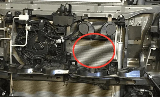

No. Only the liquid cooled one plumbed into the driver side of the radiator. Air cooled AT cooler was never installed stock in any '10-'19 460 in the US. The 470s could be equipped with them if they had tow package IIRC.
2020 with off-road package is the first US 460 year/trim to offer an external AT air cooler.
Quick check: Look through grill and if blank under horns it doesn't have the air cooler.

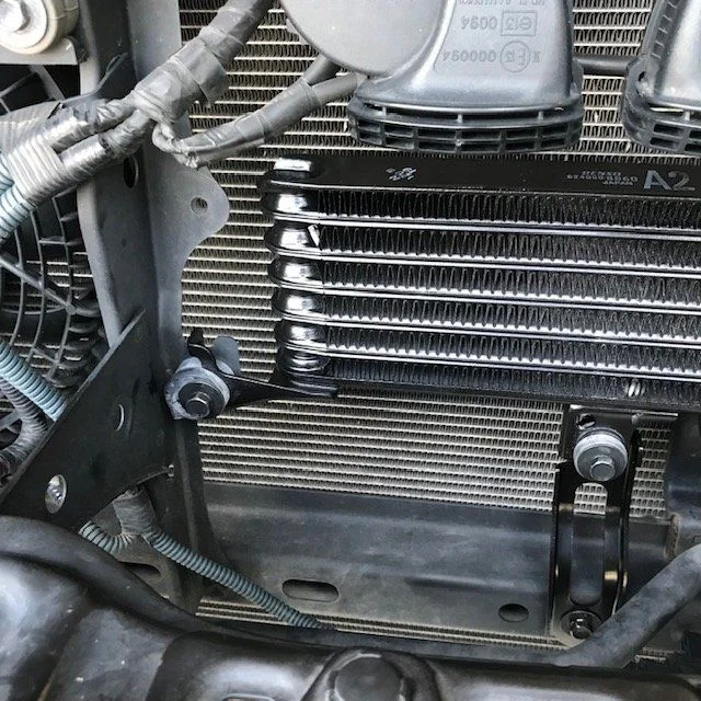

Here is mine during install of OEM cooler and what it would look like on a fully loaded Canadian GX 460.
Another note... only 3 zone HVAC 460s have the AC condenser fan in first picture. Two zone do not.

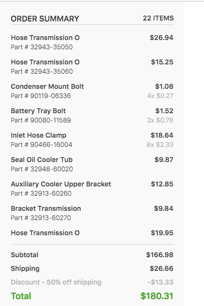

What’s the cost of the entire OEM kit?
You may find cheaper elsewhere but purchased from Genuine OEM Parts & Accessories | OEM Vehicle Parts using a 50% off shipping code CLUBLEXUS.
I think I was around $407 for everything.
32943-35050 QTY:1 (NO. 4 OIL COOLER OUTLET HOSE)
32943-35060 QTY:1 (NO. 6 OIL COOLER OUTLET HOSE)
90119-06336 QTY:4 (On install steps bolts used on step one to attach all pieces but item listed as #1)
90080-11589 QTY:2 (On install steps bolts used to attach #1 on step one and step 2
NO. 3 OIL COOLER TUBE SUB-ASSEMBLY. This subassembly bolts to the cooler bracket)
90466-16004 QTY:8 (Hose clamps)
32948-60020 QTY:1 (Foam Seal for NO. 3 OIL COOLER TUBE SUB-ASSEMBLY)
32913-60260 QTY:1 (Driver side attached bracket to cooler)
32913-60270 QTY:1 (Lower attached bracket to cooler)
32943-60610 QTY:1 (NO. 5 OIL COOLER INLET HOSE)
32943-60620 QTY:1 (NO. 5 OIL COOLER OUTLET HOSE)
32907-60290 QTY:1 (NO. 3 OIL COOLER TUBE SUB-ASSEMBLY)

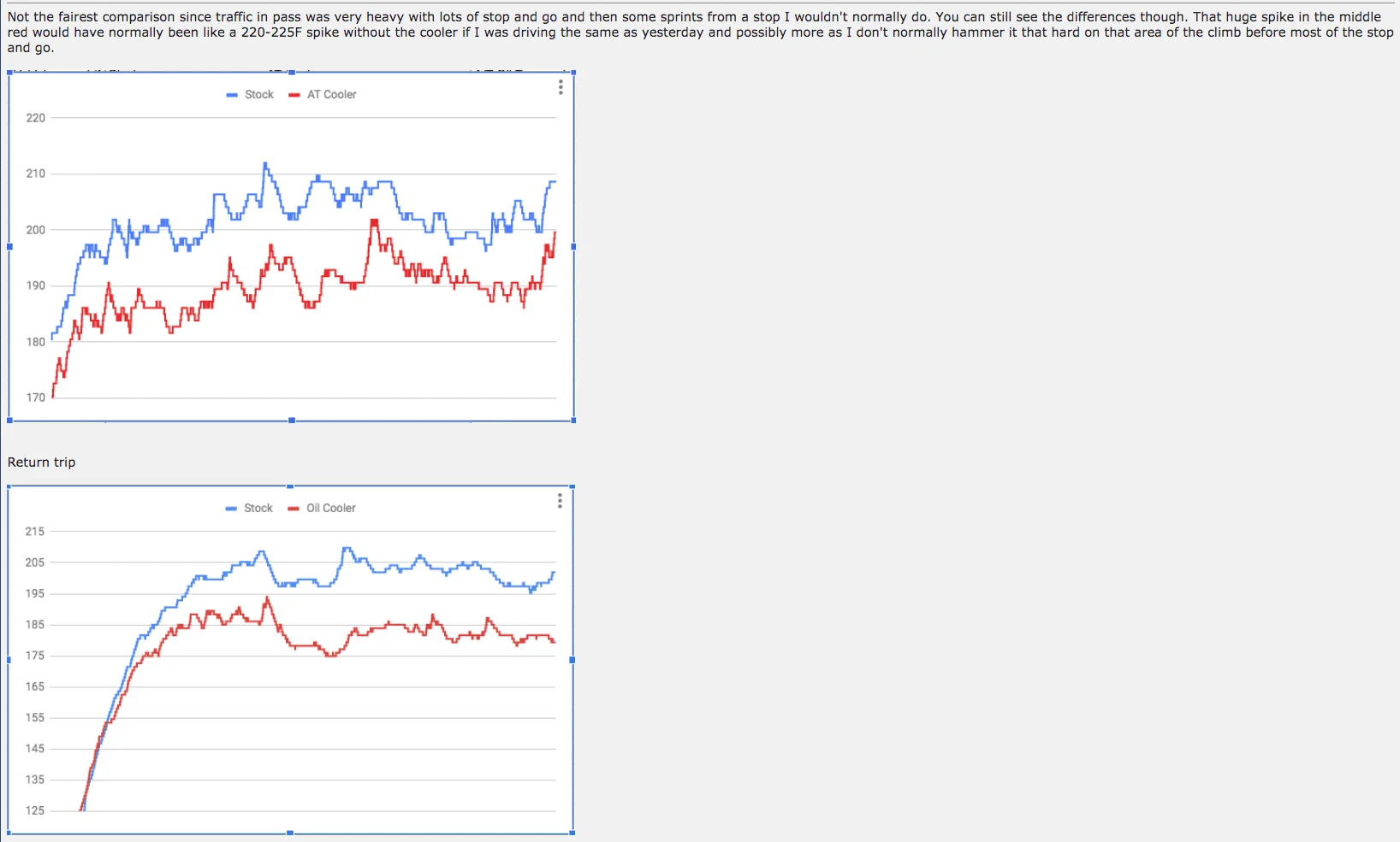

This was before/after test with just the OEM cooler back in 2019 testing.
