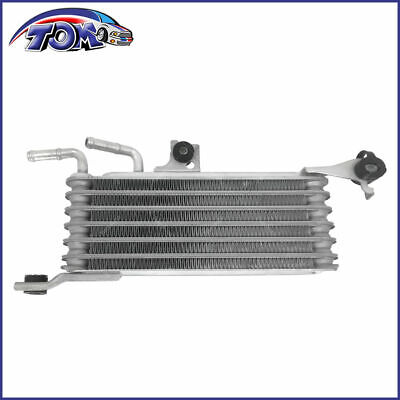

Here is the factory one and you can find a ome copy for $80. OEM AT Cooler Install - ClubLexus - Lexus Forum Discussion
i will go with a larger aftermarket whe I do mine, I like the WATS kit but too pricey.

Basic connection with an aftermarket will be AT return line from radiator --> Inlet of AT Cooler --> Outlet of AT Cooler --> AT Return line below radiator.
Even if you go with an aftermarket cooler the OEM AT plumbing has a nice fit with a braided covering over the AT lines.
When using the OEM cooler, is the built-in cooler in the radiator then bypassed? I assume you just leave those connectors open?

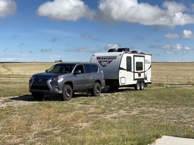

Thanks and enjoy the pic of the new house....
