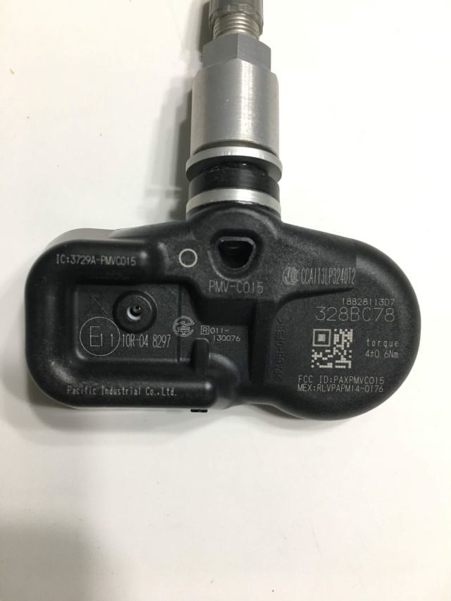

Denso 550-0103 is PMV-C107J which is wrong for you. MY2016-MY2019 is 42607-48010, PMV-C015 or DENSO 5500106. Make sure you get the 20 degrees as PMV-C015 have many different variants. AFAIK, only the 35D7 is 40 degrees. My MY2019 came with 13D7. (Last 4 digits of the numbers above the TPMS sensor ID).

Denso 550-0103 is not compatible with 2016-2019 LC. You need 42607-48010, PMV-C015 or DENSO 550-0106 which is 20 degrees that works with RW.
Thank you! Somehow managed to miss that 2016-2019 is a different part number. Looks like I'll be buying some new sensors! I still can't figure out why it doesn't appear that the sensors are sending out any signal at all.
