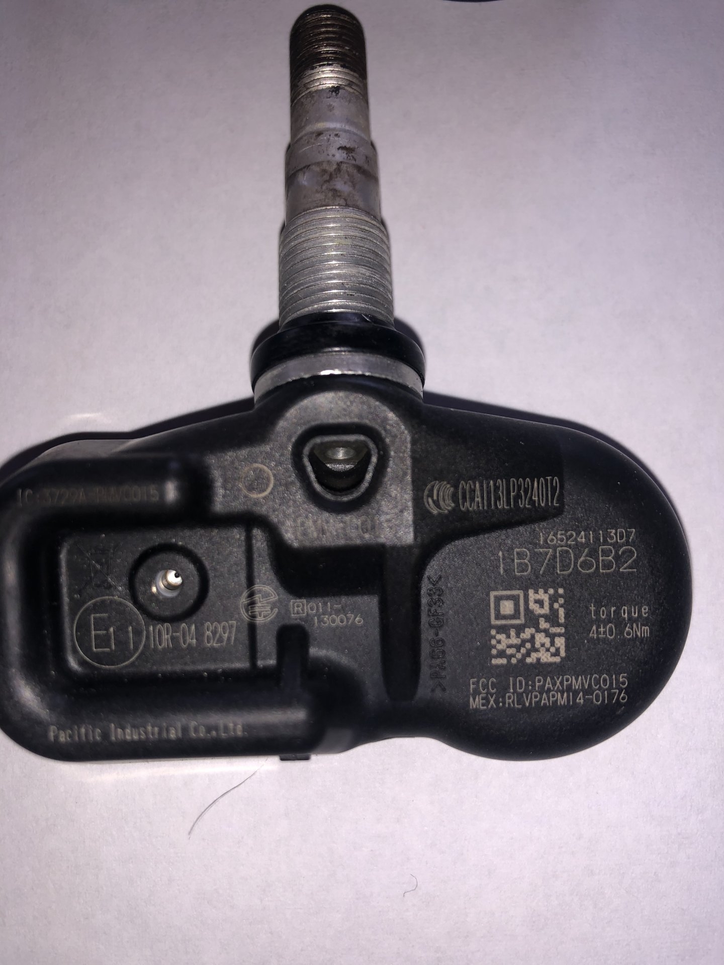

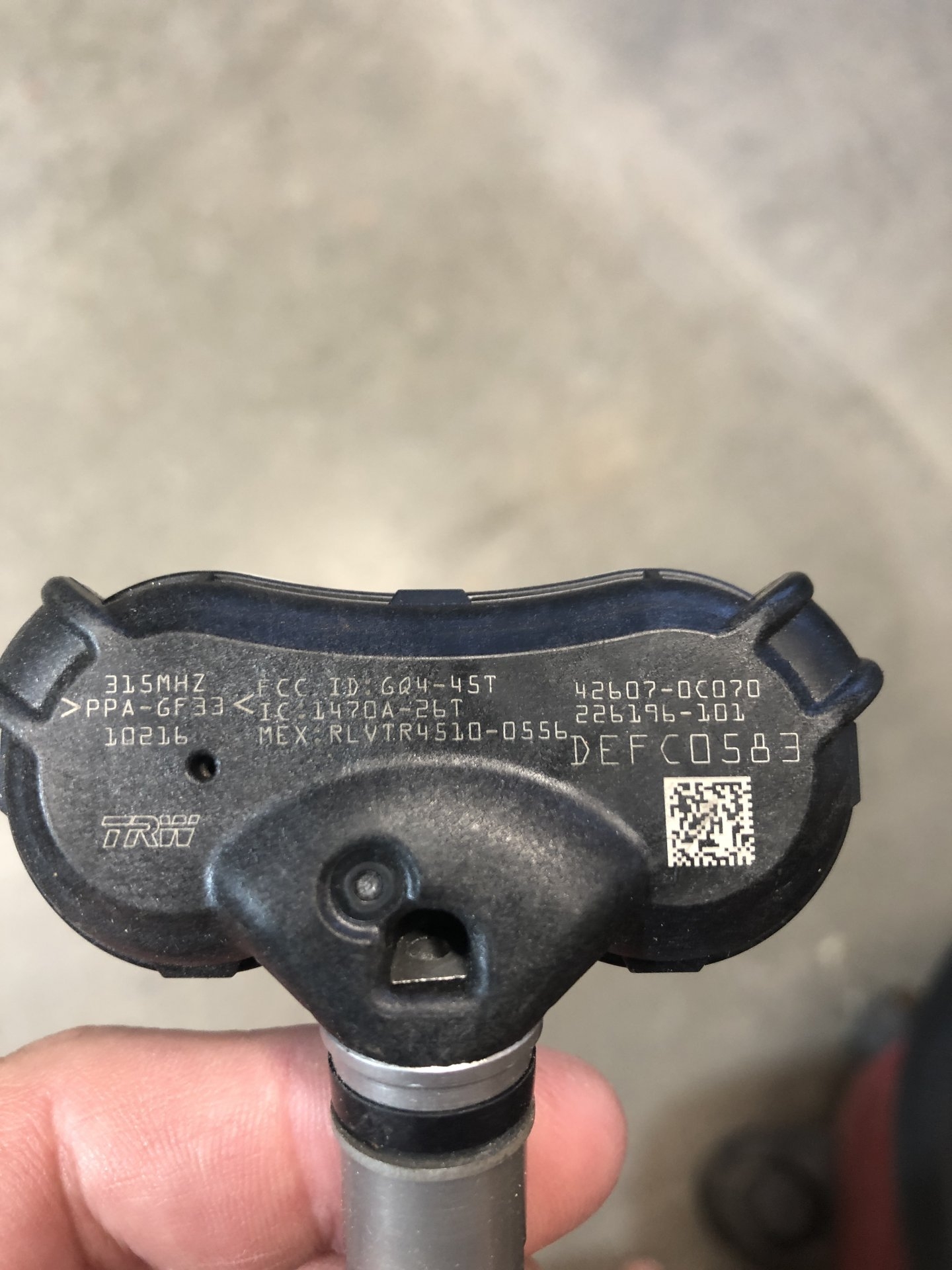

I have had them both in hand, and they aren’t even made by the same manufacturer. I have a set of four from a 2017 Tundra cheap if anyone needs them.
According to the chart, 2017 tundra is the year where Toyota switch TPMS system. Seem like you have TRW sensor.
FYI, oem Denso TPMS sensor is made by pacific.
Yes, the 2017 Tundra ones are TRW, as would the 2021 the OP asked about, right?
As opposed to the DENSO (Pacific/PMC) ones we have in our Land Cruisers.
The chart above indicate 2021 tundra use Pacific TPMS sensor. Same as 2015 LC as listed on the chart. I trusted the info.
the difference between TRW or Pacific is the TPMS id. TRW use alpha-numeric while pacific use numeric. Both operate at the same frequency 315mhz.
You could be absolutely correct. I’ve been burned by fitment charts on TPMS, so am now leery of trusting them. The photos above are from sensors I’ve had in hand.
I would be psyched for the OP if the sensors are compatible.
Again, just because it says pacific, that is not a guarantee that tundra sensors will work. There are at least two maybe three models of pacific sensor for US 200s and they are not interchangeable
